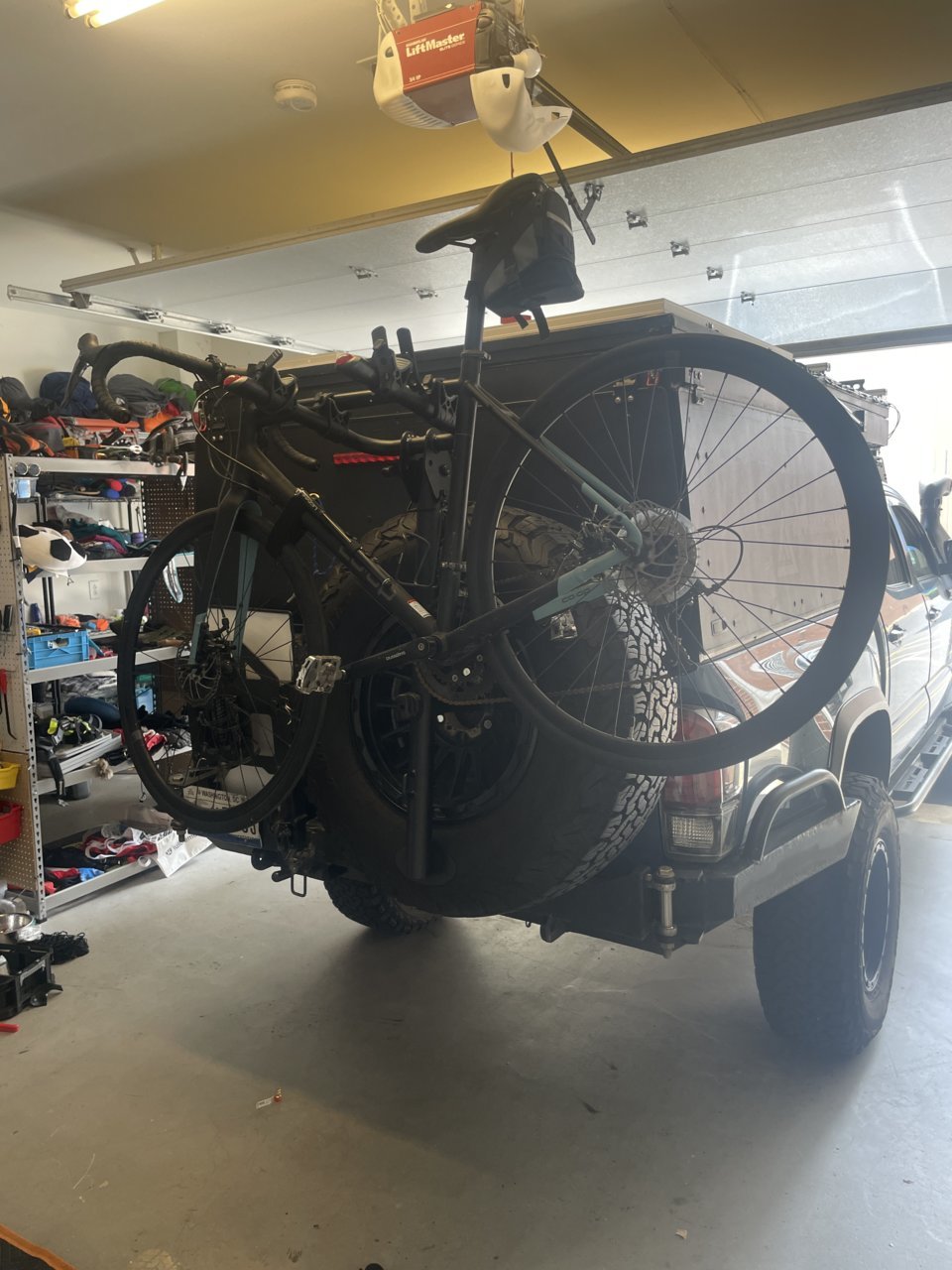

    Just arrived today. So for those looking for a spare tire bike rack there are two types: (a) one that attached to the tire carrier through lugs or (b) on that straps to the tire. I prefer one that actually bolts in. There aren’t many options out there. So questionable Amazon ones and Yakima SoareRide which is $400. I found the Quadratec Spare wheel mount and it is basically the same as Yakima with one fault…it’s made for 5 lug jeeps. I bought it anyway and figured I’d mod the base plate to make it fit. It was an easy mod. Just drilled a couple holes and good to go. Haven’t tested in the wild yet but seems exactly what I wanted.
