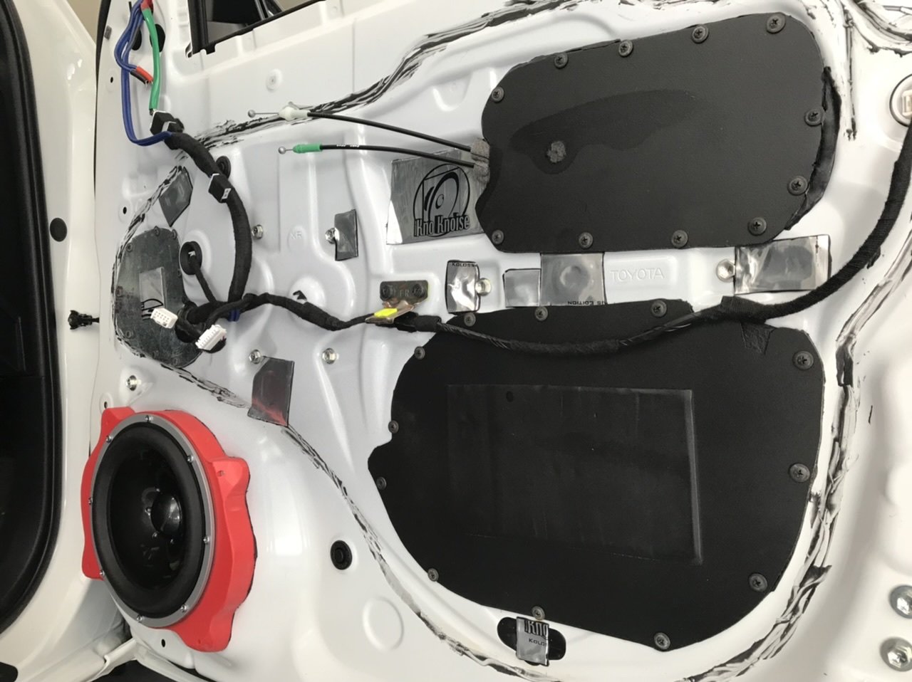

    Which driver is this?
    Boghog1 likes this.
  20. Sep 12, 2020 at 5:14 PM
    #60
    DAS Taco
    DAS Taco Well-Known Member
    Mar 13, 2020
    #322072
    2,215
    DAS
    2017 TRD Offroad
    Focal 6x9
