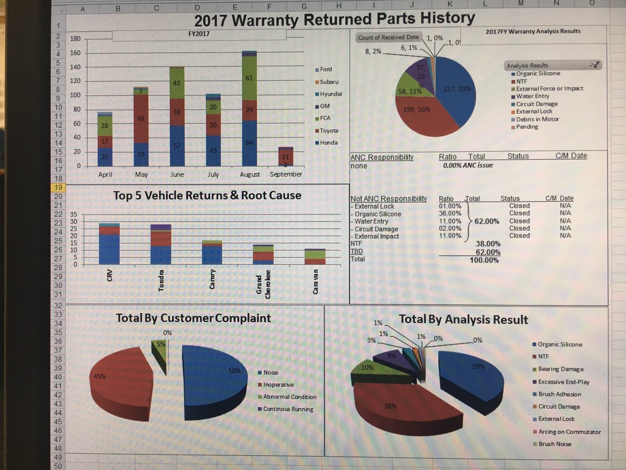

    Ok guys... just for a full perspective... I may or may not be part of the team responsible for warranty failure analysis for the largest automotive parts manufacture for North American vehicles. I review multiple matrix just like these attached showing failure trends for all sorts of components. Never and I mean NEVER is the Tacoma ever near the top of these lists. Usually at the very bottom. Sure there are some small issues here and there but in the realm of things the Tacoma (Any gen) is one of the highest quality and most durable vehicles made. This isn't an opinion. It's data. Lots and lots of data.

    Organic Silicone is ruining our CRVs! Chaos, mass hysteria! Dogs and cats living together!
    No seriously what the hell is "organic silicone" referring to in this context

    Haha. That is actually for Blower Motors. Dumb girls (crv is a girl car) dump armorall down the HVAC intake and the vapors bind with the hot commutator surface in the motor resulting in failure. Silicon is the contaminate.
