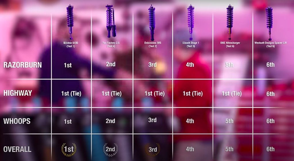

    Bilstein 5100 2/1" for the Win
    Chew likes this.
