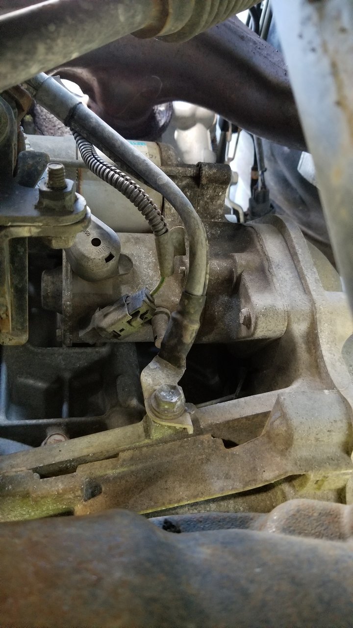

    Does anyone know the location of the engine ground? Doing a big three and it's the last peice of the puzzle. I can believe it's the 12awg wire in the harness alone. Heard me tion once of a cable going straight from block to chassis ground, but can't find it. It's my last wire and I'm losing my mind trying to find it.
    Also, I see you mentioned starter and fuse block. Do you recommend those as well? My big three isnt for stereo, but for accessories and an eventual dual battery setup.
    Thanks

    I think I found it! There is a 4awg wire thatgoes from the fender ground near battery (batt neg to that ground). From there it goes down (with harness) past alternator and into the block just above the transmission case (see image).
    Can anyone confirm?
    If it is, I'll run my big three engine to ground along side this..

    That would be the ground you are looking for! It goes from the battery to the Engine block!
