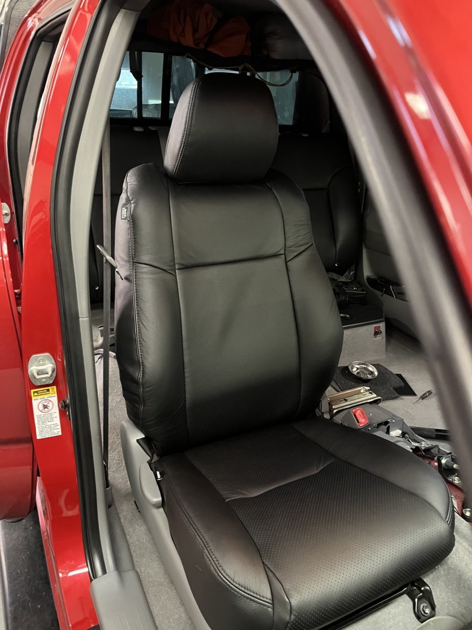

    I just added katzkins with seat heaters. I am extremely impressed with the fit of these. 5DF31FB7-D510-4905-BD43-7EFE889F9E45.jpg

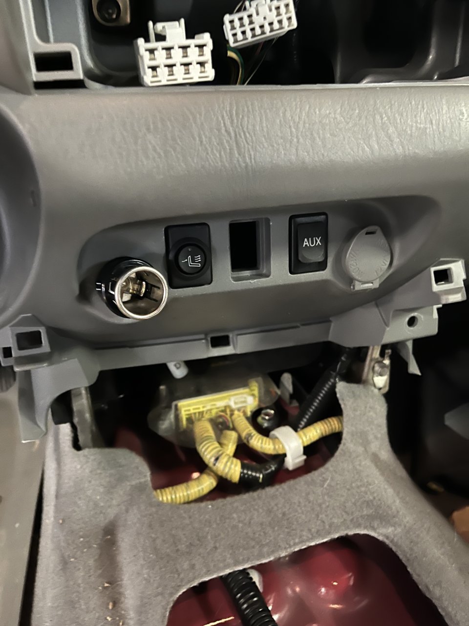

    That makes two of us! Thanks for sharing, they look excellent. How did you wire the controls?

    I drilled holes in the switch blanks above the cup holders. Wiring just needs power and ground. I ran the power to a fuse tap in the fuse box and used an existing ground under the console.
    It was a big project. The leather fits tightly and requires forceful coaxing into place. The wiring was the easiest part of the project.
