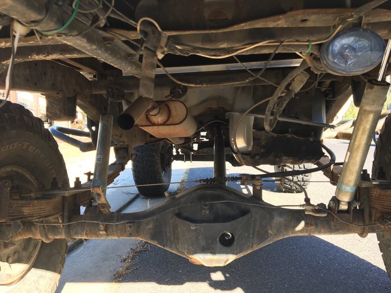

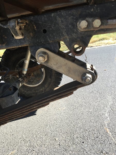

    My hangers
    Rear one came with my all pro lift. Doesn't work as well and I'm too lazy to cut it off.
    I remounted my shocks to the top but left them forward and backward with the thought it might slow axle wrap. I also moved the upper mounts slightly.
    Also see diff armour. That light is my back up light... haven't hit yet!
    That is a v6 rear rear end too which is 3" wider and much more stout. Your diff will also bolt right in. I'd recommend it. Got mine cheap. Bigger drum brakes too.

    Yeah I'm going to switch to a straight shackle for sure. And on the list is a new rear axle, but probably won't get around to that until late summer/fall.

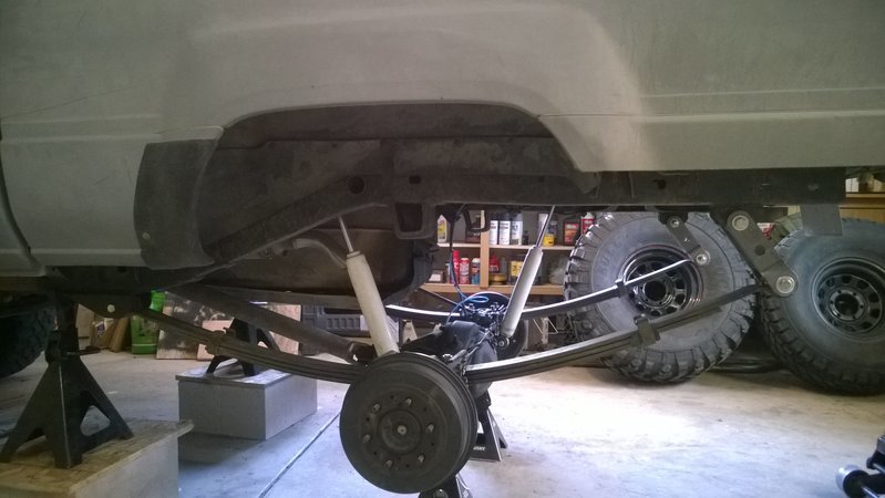

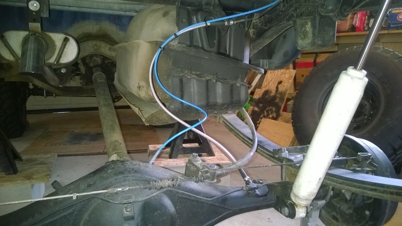

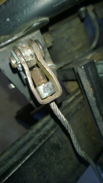

    Finished up some stuff last night. First, my 6" shackles showed up on Wednesday. I bought the ones that dip in a 1/4" so I didn't have to space them with washers. I also 'fixed' my parking brake. The line had gotten some extra stretch in it so I cut a nut, slide it over the line, crimped it down to close the gap, and then welded it shut. We'll see if it helps. Then I put my extended ss brake line in the rear. Found out I cross threaded one of my ubolts so I need to track one down today and then we'll be rolling again. Bora said my new 1.5 spacers should be done this coming week (why did I buy 1.25s :annoyed:) so planning on putting the Pitbulls on next Saturday :woot:
