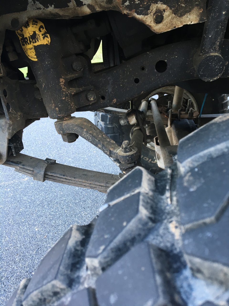

    ^^^ what he said. They may look like they cross at full droop but at ride height/bump, the axle is moving back and could put them in the right position.

    I need to remove those extra leaves and see. I'm gonna snap a pic when I get home. Compression with a slightly shorter pitman might work.

    Yeah, thanks for that. Seems obvious now but I didn't even factor that into the equation!

    I did the same thing whenever I put mine all together the first time and actually moved the axle back an inch (spring perches where drilled). Put it all together and realized I had a lot of clearance at ride height and undid everything, cycled it again to find it worked. Put it together and thought the same thing again ("crossed" at full droop) but tried it and has worked fine every since.

    Yea, they could be in line at ride height, but it may clear fine as the suspension compresses and moves the axle back. Test it before worrying too much about it.

    Thanks guys. Feeling better about it now. I'm going to get in it this weekend and see where I'm at.

    So I just took another look at my set up. I think the drag link and tie rod are closest at center. So if you don’t rub there you should be ok, I’d think.

    Thanks for the pic!
