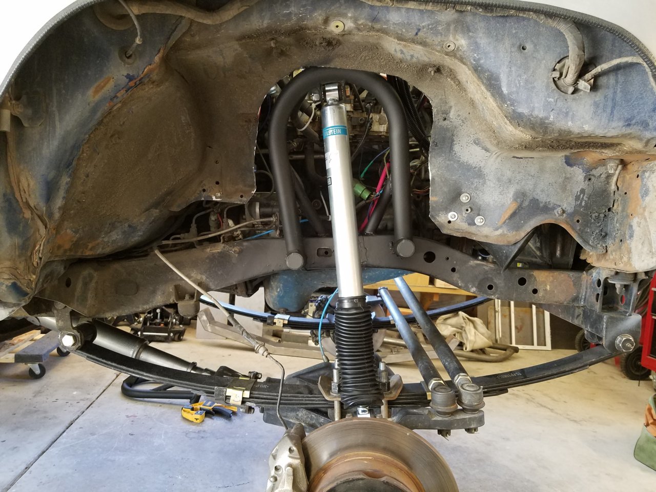

    Burnt in the passenger side yesterday and got it buttoned up. I even put some trim in there :p. Need to get some plastic or rubber for splash guards.
    And man I need to practice my welding more. Especially in tight, cramped corners but I'm pretty sure I put enough hot metal down for it to hold :welder:

    Looks good!
    Also looks like you got the steering sorted. That is a flat pitman arm!

    Thanks! I ended up getting one 3/4" shorter than stock. We'll see how it does.

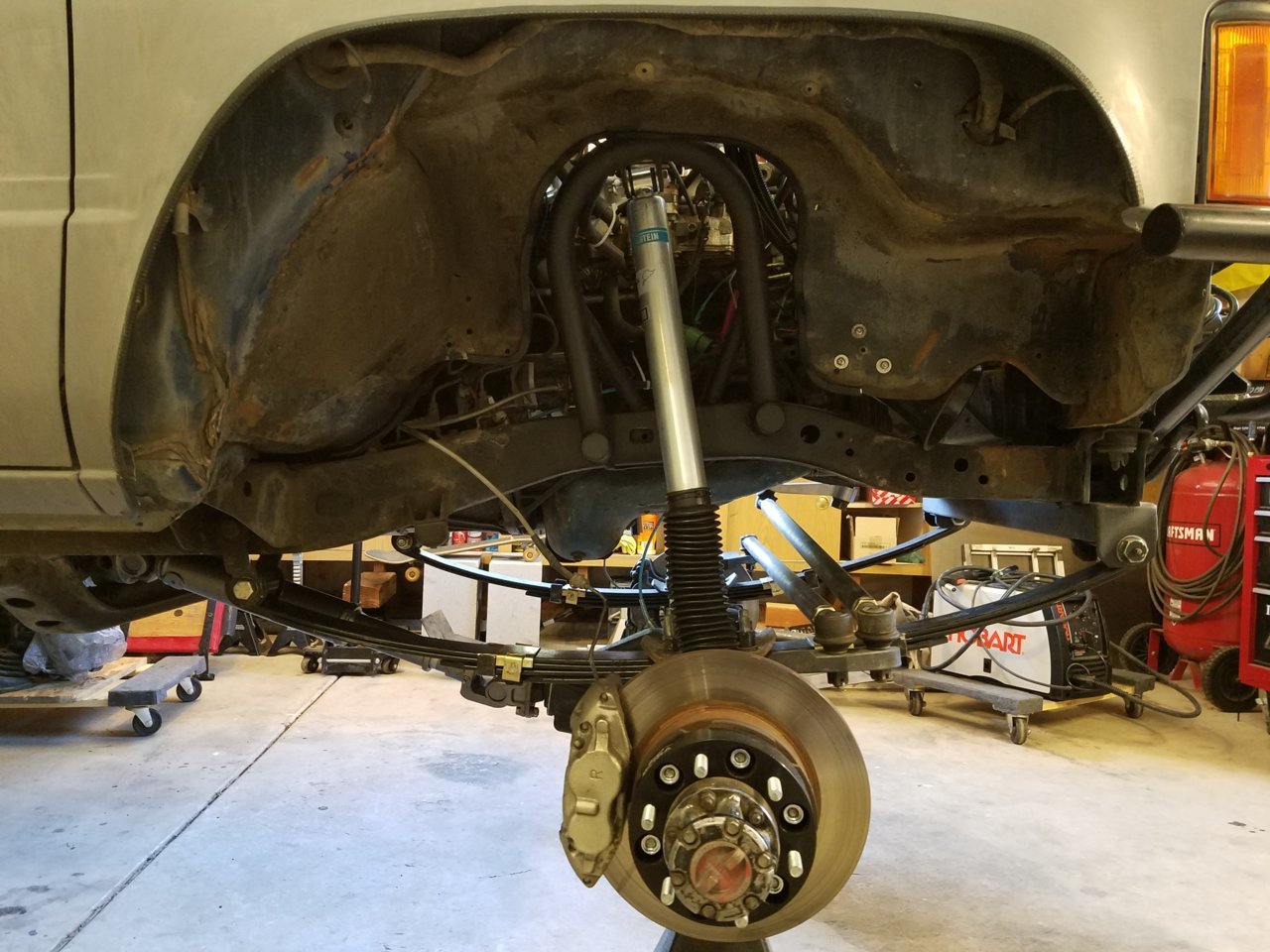

    Got the other side burnt in today. Operation move the axle forward is now complete. Really happy with how it came out. Now onto the rear.

    WHats the plan for the rear?

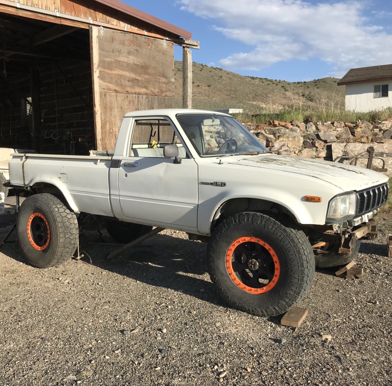

    I got my spring bag front and rear mocked in until I get the drivetrain in. Grabbed a w56 5 speed for it the other day and mated that up to the dual cases with triple sticks I built a couple years ago. Pays to hoard parts I guess haha. On the rear i’m using Explorer leafs. They are shorter than the Chevys but still have a decent amount of flex without the axle wrap. From what I’m told they are a pretty decent compromise.
