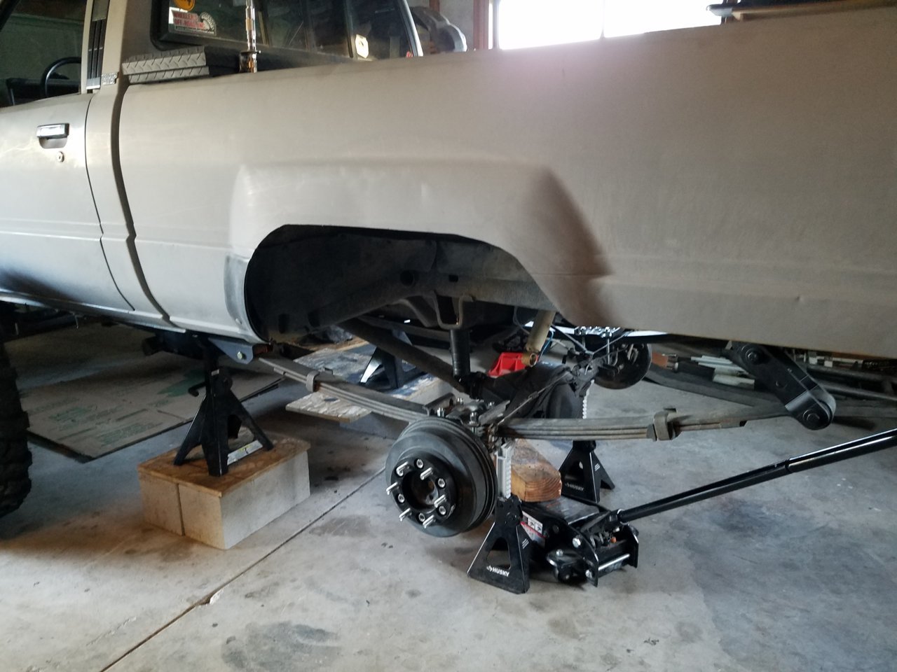

    I cut off a few inches of rear fender last night. Forgot to wear my Bane mask so I've been blowing black shit out my nose this morning :(
    Also put some cheapo bumps stops in. Probably need to cut them down but I won't know until my test drive.

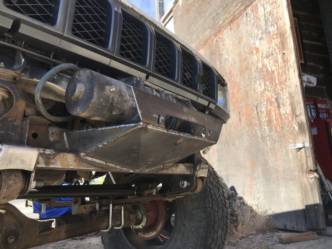

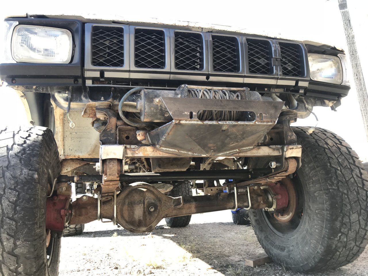

    When are you planning on hitting the rubicon? I’ve still been plugging away on mine, started a front bumper yesterday. It’s completely welded to the truck so there is no going back now. Winch mount and center section is all built, now I get to start on the tube work.

    Good call. I checked marlin and they're long spline is $120 cheaper than TGs and they have 10% off for the 4th of July :woot:
    July 11th. Nice start on the bumper!

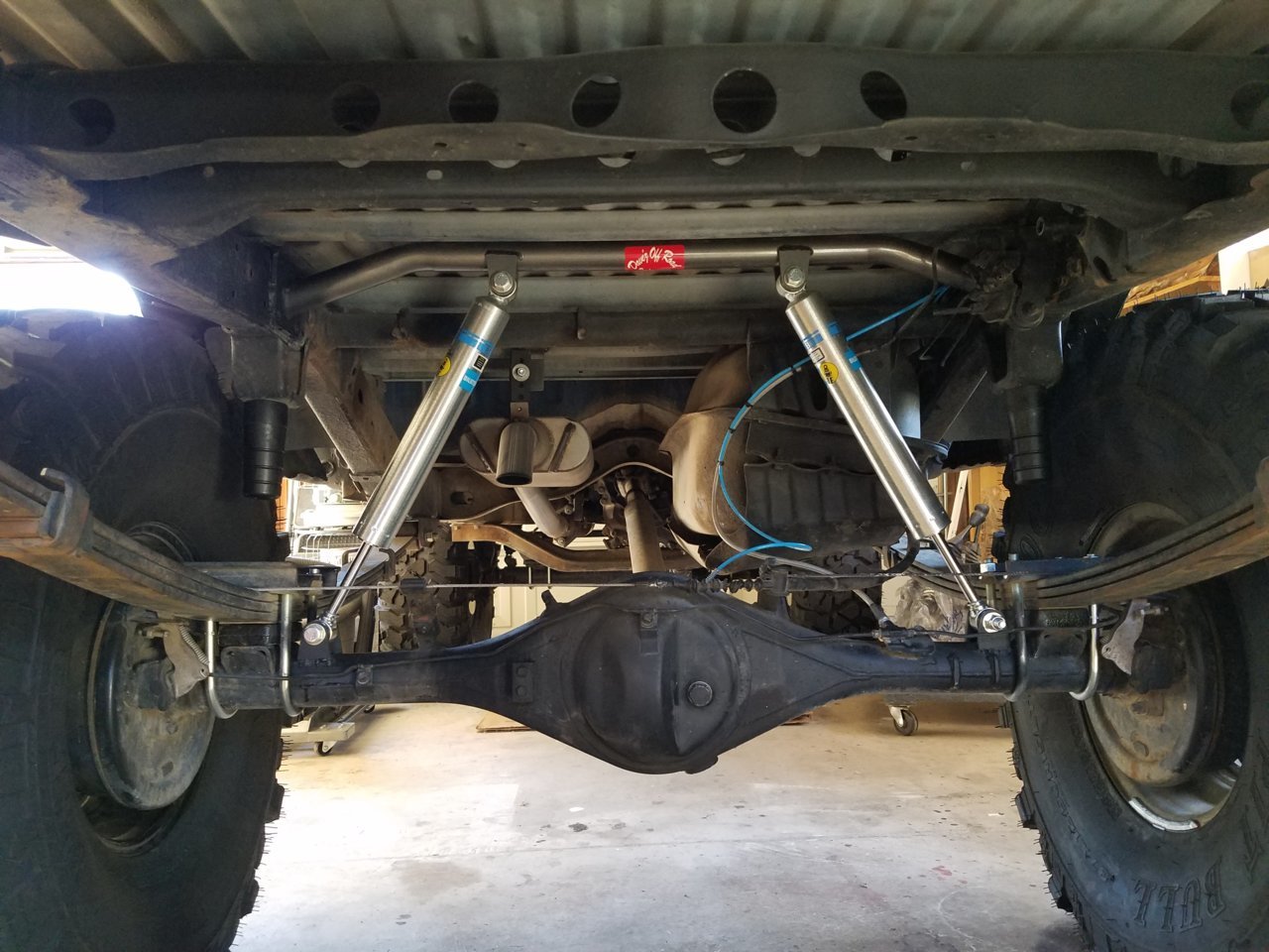

    Finished up the rear shock relocate. I like it.

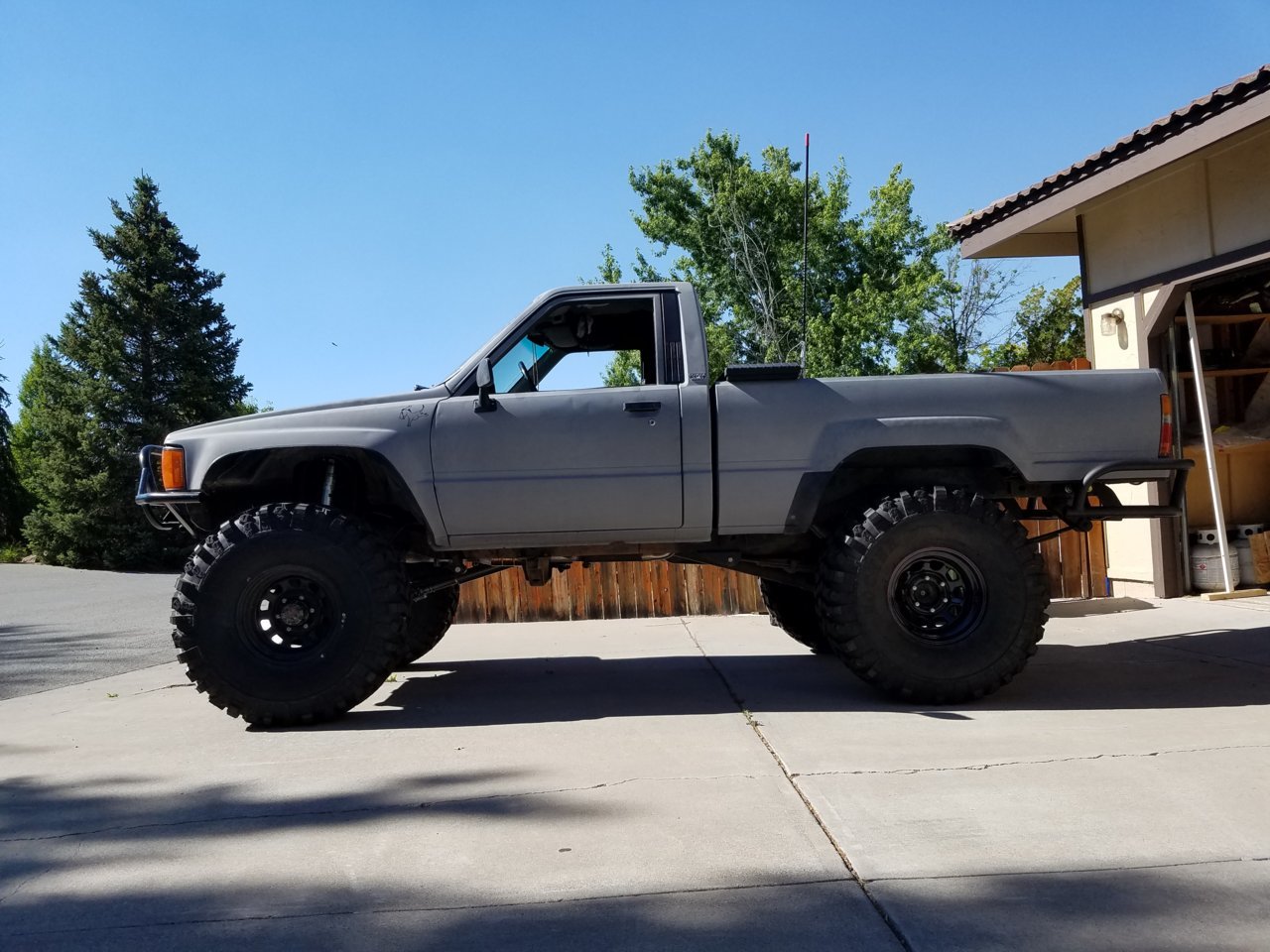

    Rear bumper's fit is shit with the 4-5" cut off the bottom of my bed but I needed something to protect the sides until I bob it. It rides like a dream with the 63s and billies in the back now. I didn't realize just how shot the rear shocks were.

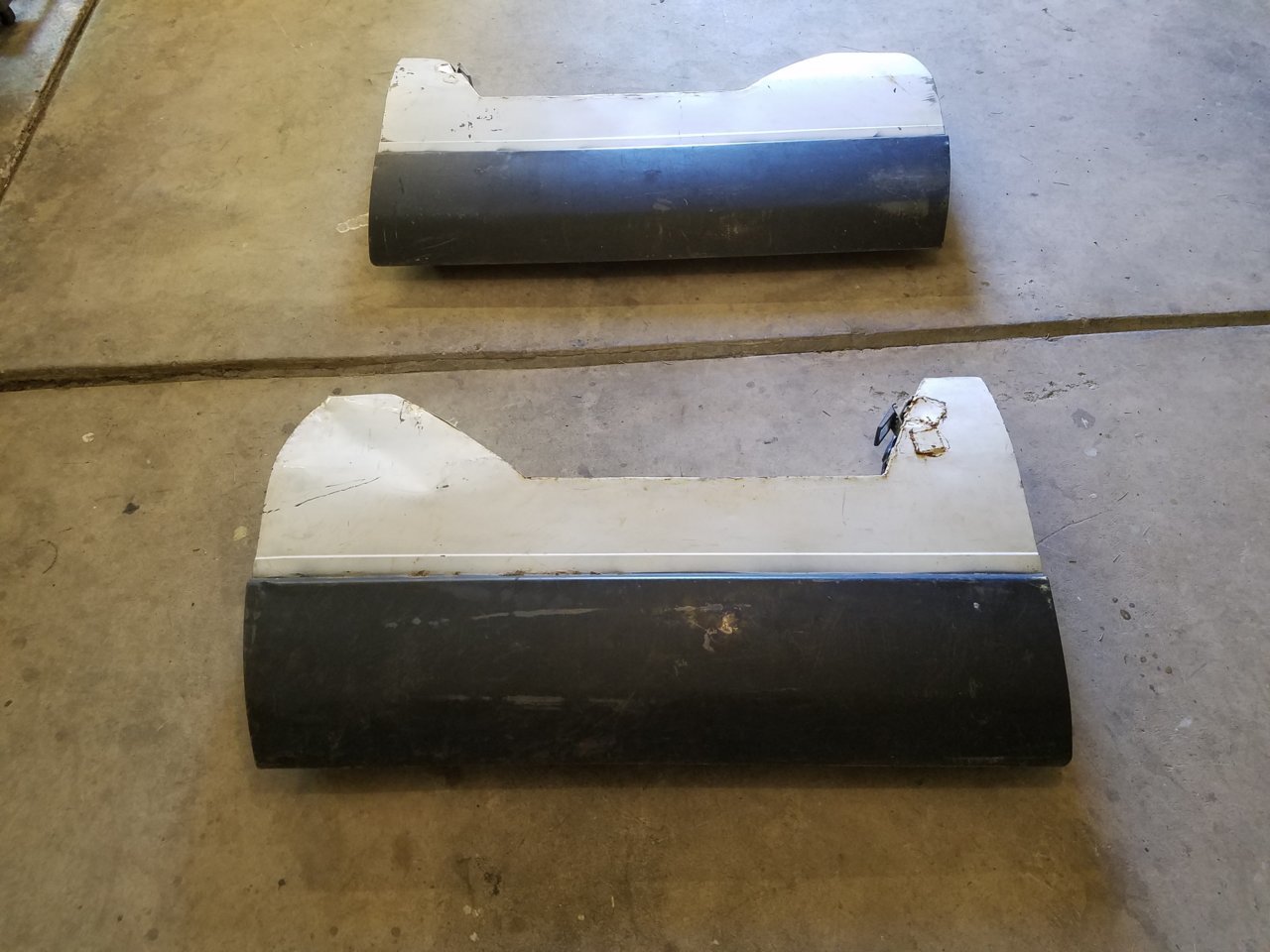

    Like I need another project with T-6 days until my trip. Maybe I'll get to them, maybe i won't but for $80 and being available I couldn't pass them up. They need a little TLC but I'll give em that eventually.

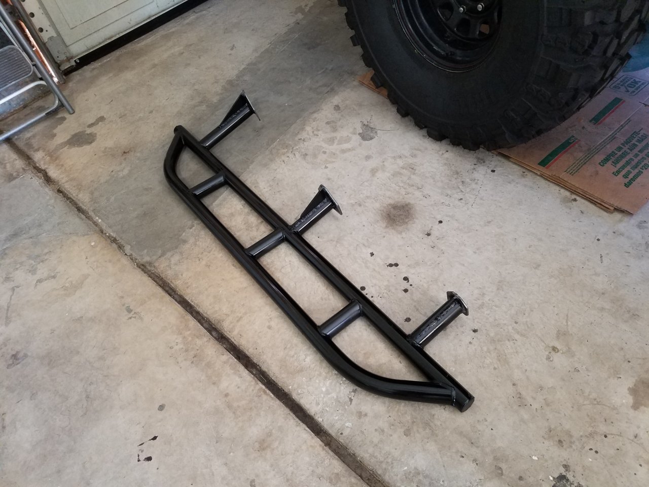

    Sliders built. Going on tomorrow.

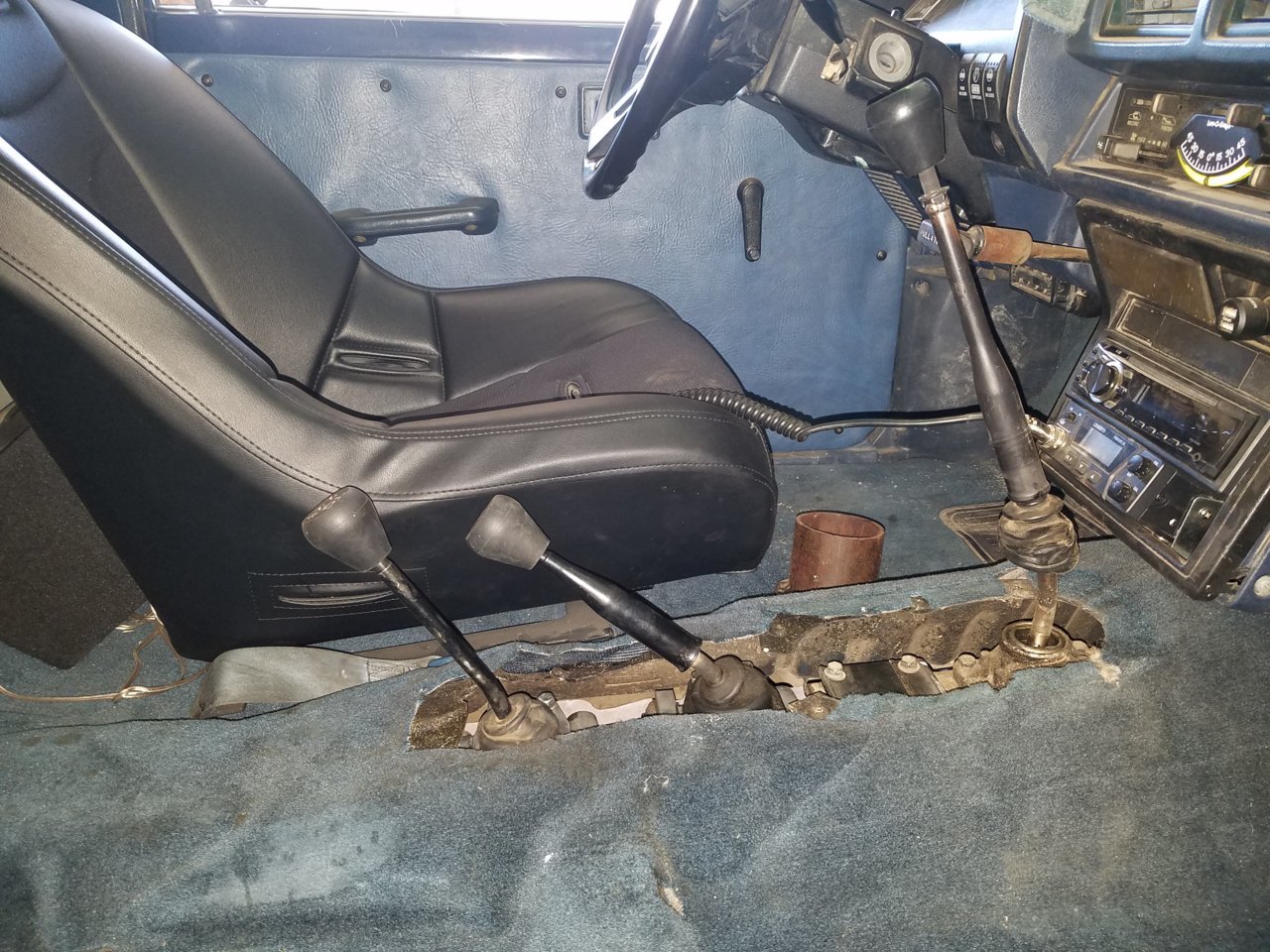

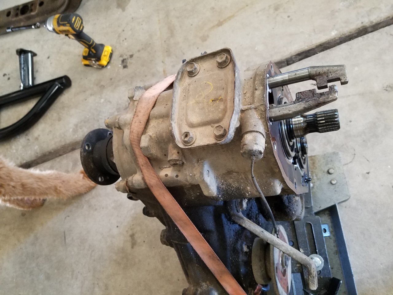

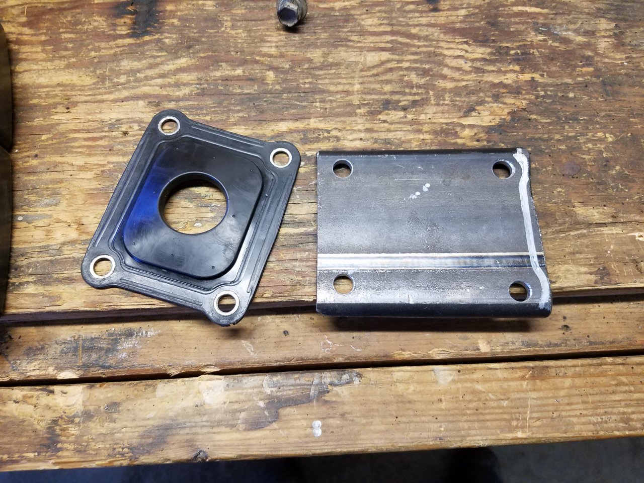

    Sliders didn't go on because I was finishing painting them but it worked out since it left more room to get the tcase in. Out with the forward shift, in with the goods. I cut up some metal to make a cover for where the old shifter was. Not sure if that's what you're supposed to do but it made sense to me so I did it. Tomorrow I'm getting the drivelines built and tomorrow night I'll button it back up.

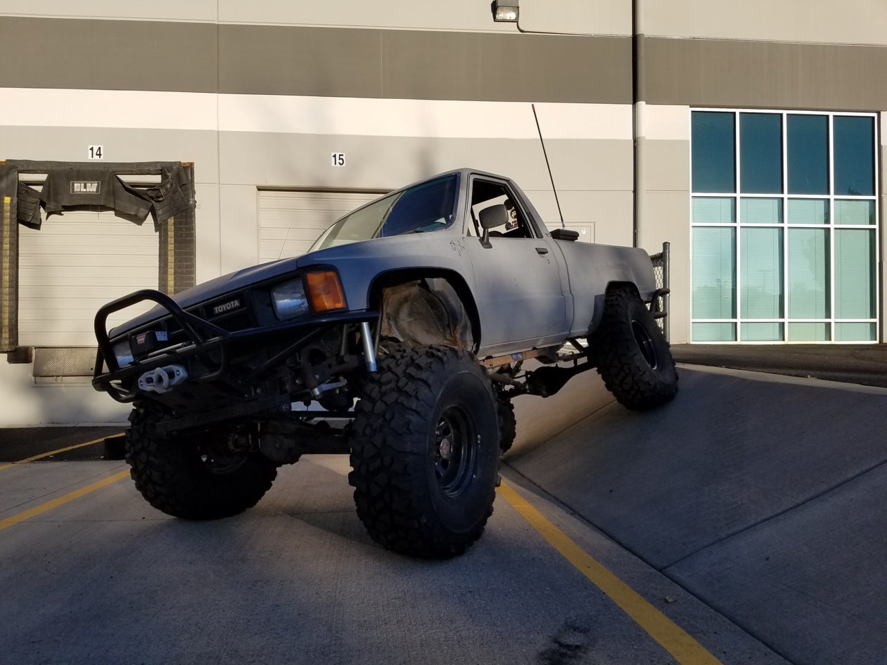

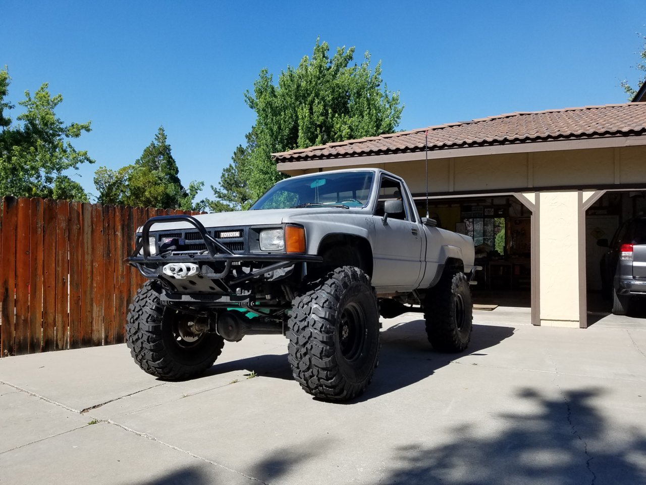

    Flexed it out this morning to measure for compressed driveline length. Had about an inch in the back before the bumps where they are now. The fence on top of the ramp thwarted me lol. I need to make an attic ramp to keep in my side yard.
