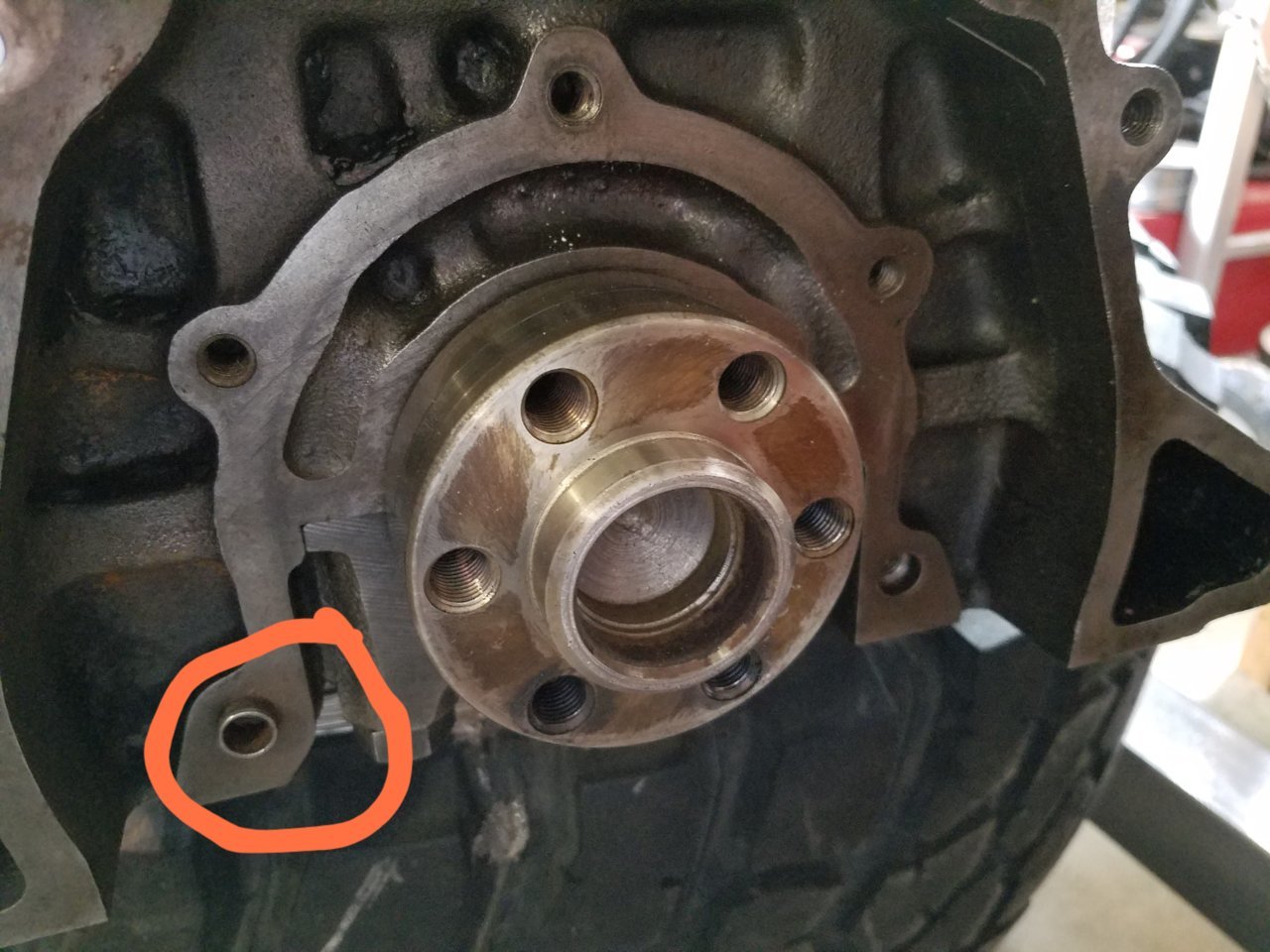

    Anyone know what part number or what this sleeve is called where the rear seal retainer attaches? I'm missing one and my Ace doesn't have anything with a thin enough wall.

    I've always heard them referred to as locator sleeves. But that could just be shade-tree slang. It could also be called a hollow dowel pin. But I think that may be a stretch in this case.

    Thanks! I'm still searching :D

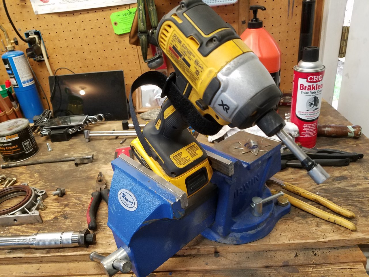

    "Fuck it, I'll just make it"

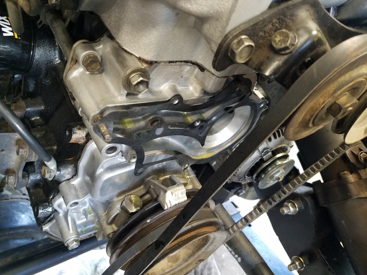

    Got the engine all back together and back under the hood. Started filling it with coolant this morning and it starts pouring out the top of the water pump. I knew that new gasket was shit :annoyed: just got back from oriellys for some ultra grey. Fucks.

    So I redid everything with grey and buttoned it up last night. Filled her up and everything is fine. While putting the headers back on I hear a drop. WTF! Go look and one of the core plugs is weeping :annoyed: I think I'm going to try and seat it with a love tap. If that doesnt work I guess I'll pop it out and fix. At least it the front one on the PS which is the easiest to access.

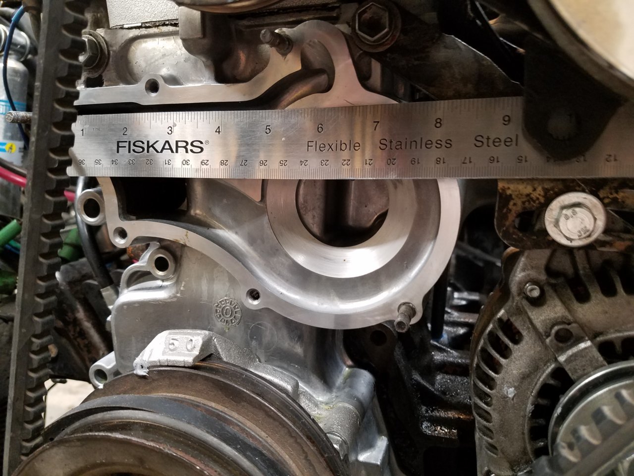

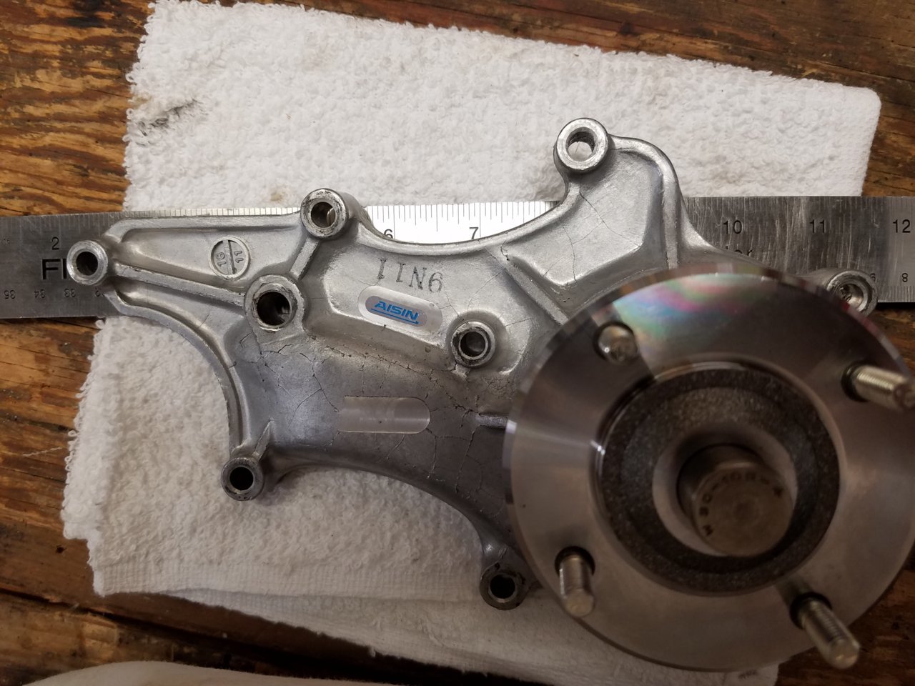

    Came home tonight looking forward to getting this thing rolling but found the water pump had some coolant pooled up on top off it again. So sad, wtf. Figured it might be a non flat surface so let's check. Drained coolant, disassembled everything in about 20 minutes. Amazing how fast you can do it after three times in four days. Cleaned off the rtv from both surfaces, took a scientific ruler and both the face and pump are flat enough for government work so let's put this thing back together with an even thicker bead of rtv. Went to install it and rtv pushed out from all areas with the exception of the top part where it was leaking, wtf. Pulled it back apart, cleaned all the rtv off and took a closer look. And there it was, the aisin water pump swoops but the POS cover does not which only leaves like a 1/16" for the gasket. Well at least I got to the bottom of it. Hoping a cheapo WP from oriellys/napa/autozone is straighter. I'll find out tomorrow.

    Welp, my dumbass didn't know there are two different timing covers (early and late) for the 22r. One swoops and one doesn't. Live and learn! Part on order and since I was ordering parts I figured I'd get the brass freeze plugs while i was at it. Fingers crossed, we might be rolling this weekend.

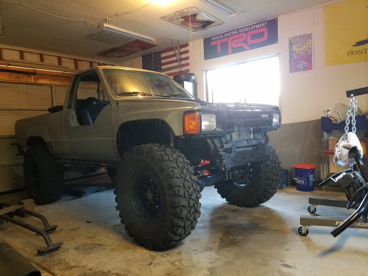

    We're back on all fours and rolling! After dumping 5 quarts of oil on the garage floor because I forgot to put the temp plug back in the side of the block, filled her back up and drove around for about 30 minutes. Still gutless but fresh. Yes, its done!

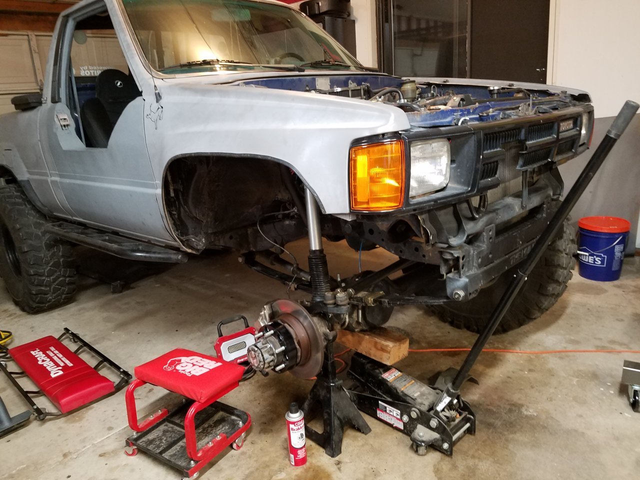

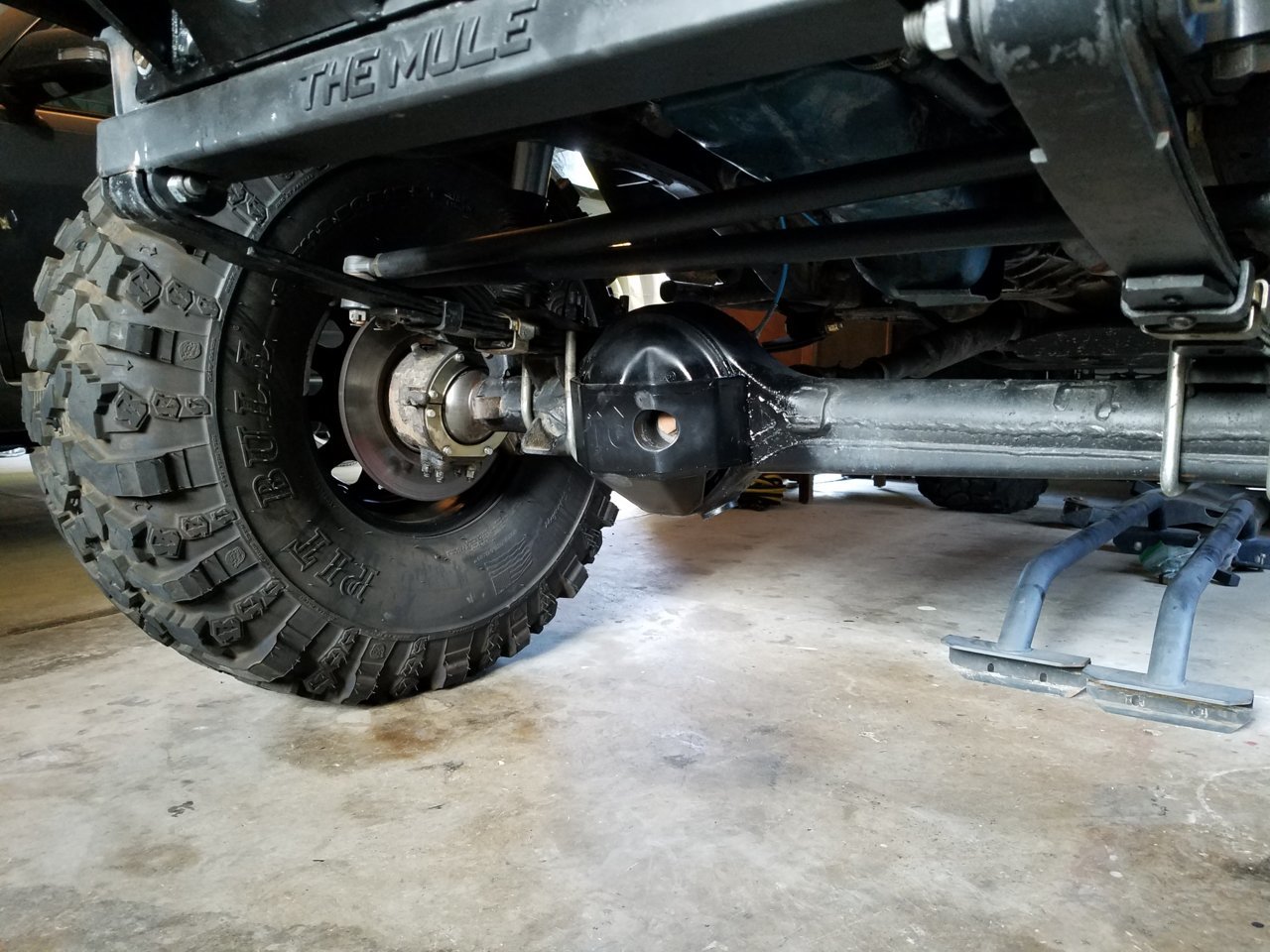

    Brakes are in and the pull issue is fixed. Yesterday I installed the front diff armor. Super chicken shit welds, we'll see if it stays put. I'm not convinced it will but if it doesn't, I'll redo it when I pull the axle next.
    I can yard on it as hard as I can and its solid but I don't weigh as much as a truck.
    3 days until the trip. Bleed brakes and stretch the new winch line and we should be all set to go.
