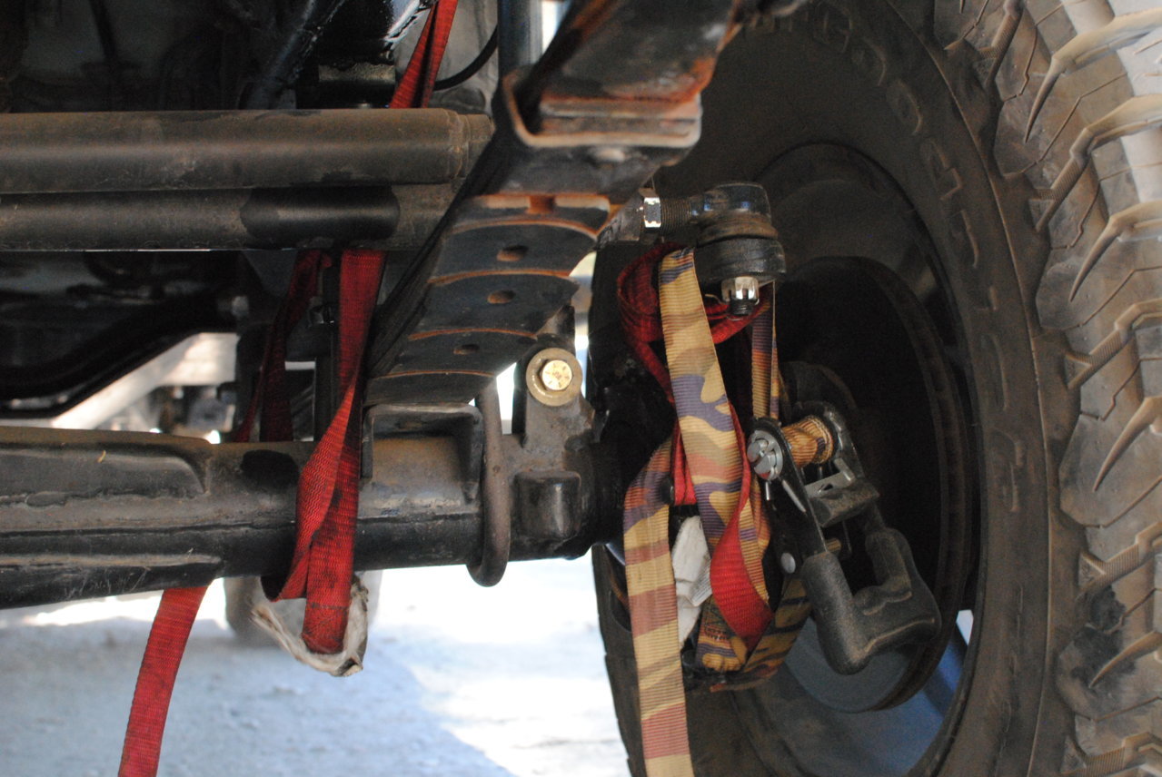

    This times a million... unless you do the .5th stud or 6 shooters. Or you’ll end up like me my first trip on the rubicon with 3 broken studs on one knuckle and bunch more lose... took a welder and bunch of tie downs to make it off the trail.

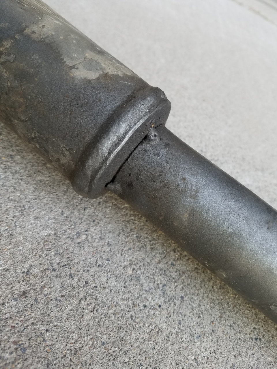

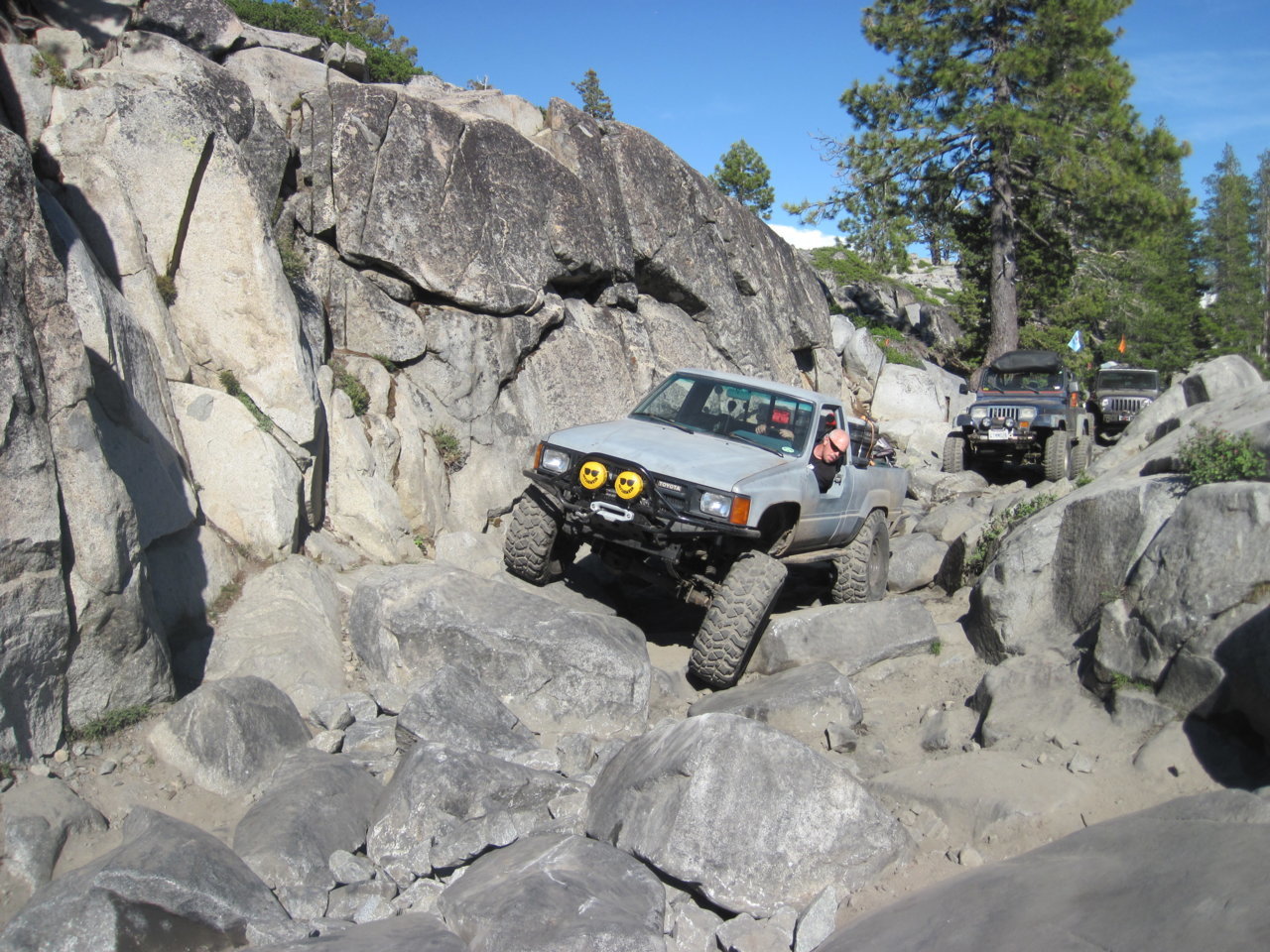

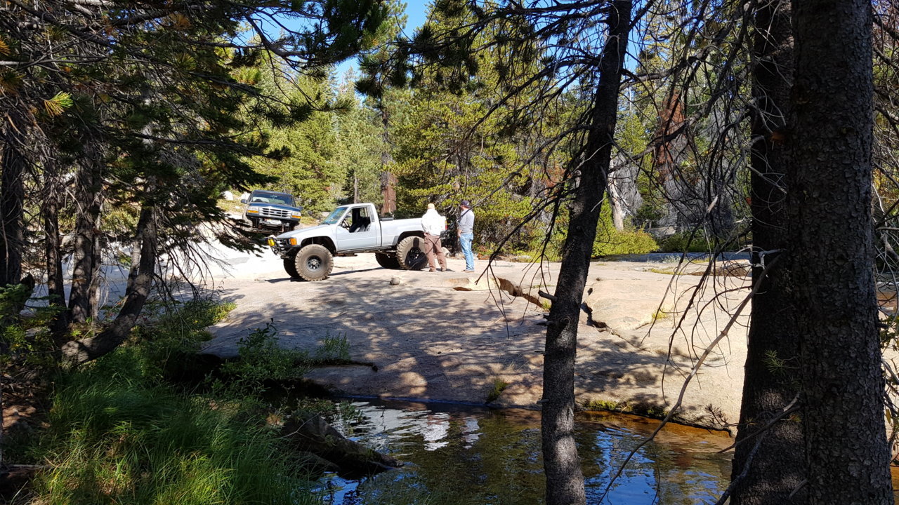

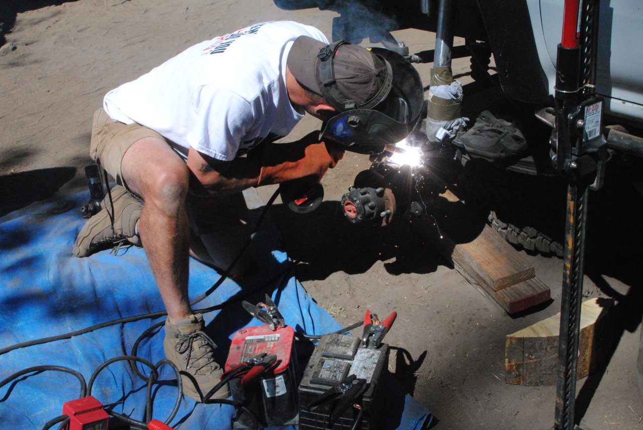

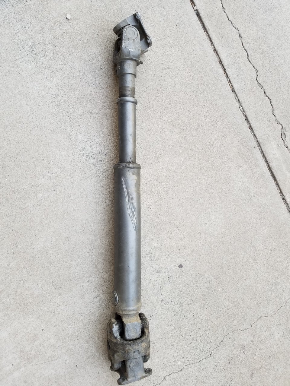

    Got back from Georgetown yesterday afternoon since we ran the trail from Tahoe. Had a blast, mule kicked ass. With our convey being nine deep it took us almost 11 hours from the time we aired down to when we hit Loon. Had one hour stop for a ujoint fix on a jeep and probably two hours total waiting on traffic. On Saturday we went from the property up to spider for a swim and on the way back my buddy noticed my front driveline was wobbly. Got underneath and saw that when I had it rebuilt they only tack welded it instead of running the full bead. WTF and shame on me for not noticing it. Decided to pull it before it completely broke and weld it up back at camp. Back at camp we got into the cups and said F it, we'll just drive out in 2wd. Left yesterday morning about 8:30 and got off the trail about 10. Aired up and drove home. Whole lotta fun as always!

    Square driveshaft is what you need. I now have it in front and rear, no more bent driveshafts.
    I run them full time since I never plan on driving it on the street, but it is pretty simple to swap the rear at the trailhead and exit. Leaving the front on full-time will not really matter.

    Totally worth it for maybe $20-30 in metal. Definitely better than $300 every time you smash another driveshaft.

    Definitely doing this for the front. I'm having this one done up with .250 and then building a square one for a spare.

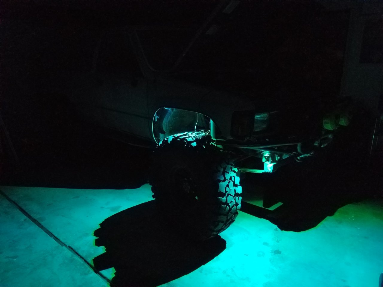

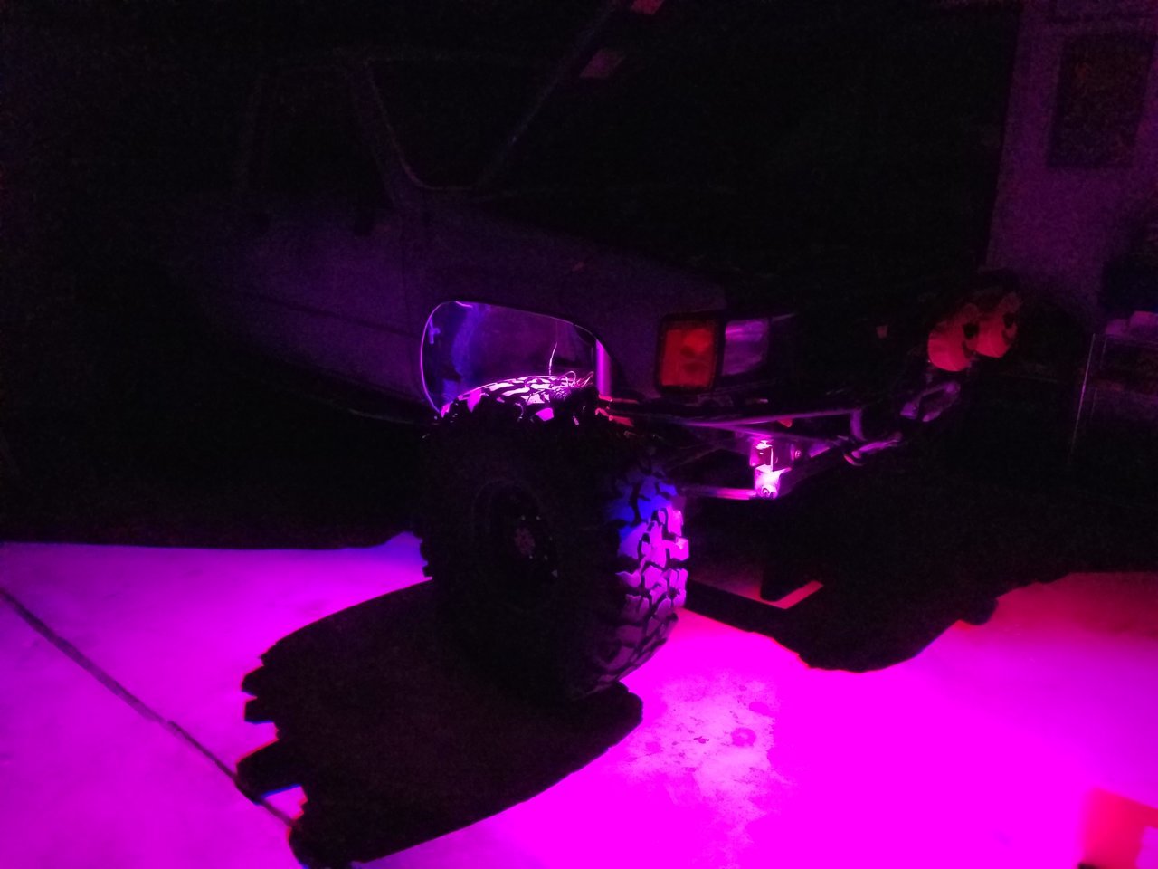

    Started on my lights. F'n rainbows and unicorns under there!

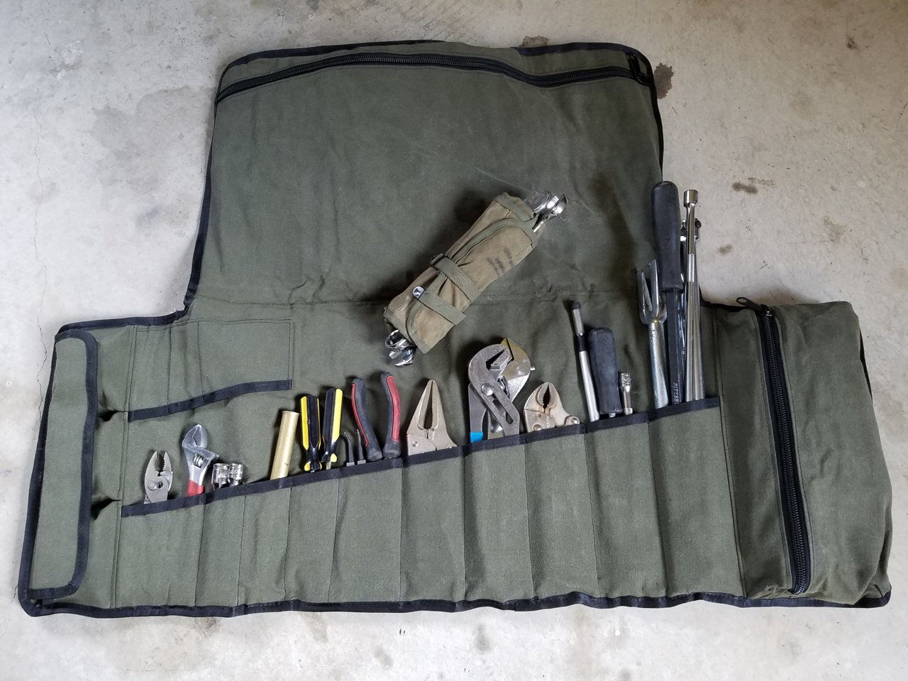

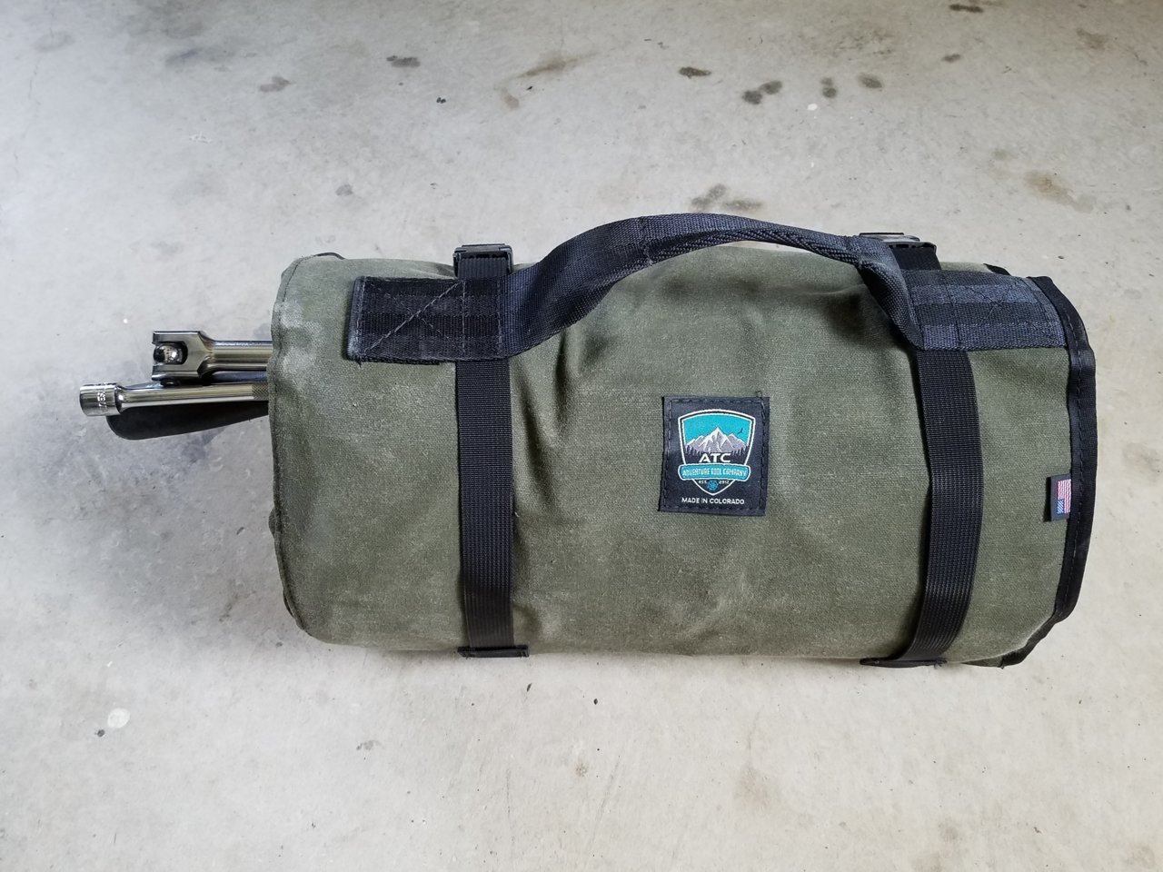

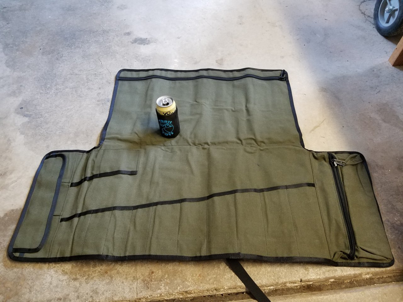

    Bought an adventure tool roll. This thing is quality. I went through and tidied up my tools. That's all the shit needed to fix a yota :p
    stickyTaco, skidooman, samiam and 2 others like this.
  20. Apr 20, 2020 at 4:12 AM
    #400
    la0d0g
    la0d0g [OP] Its 4 o’clock somewhere
    Jan 25, 2011
    #49903
    19,907
    running for the hills
    For crawling not hauling
    I really dig this thing. 1/2" deep socket set on the left side. Tie rod pullers, metric 4-17 set, allen wrench set, and other random things on the right side. Top section has fuel line, air line , zip ties, hose clamps, etc. I put my ratchet wrench roll in the middle when closing it up. Rolled up it easily fits in my bed tool box which my other one didn't.
