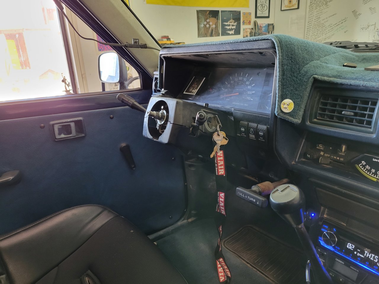

    Now I'm sound deadening the top and back. New steering wheel on the way too.

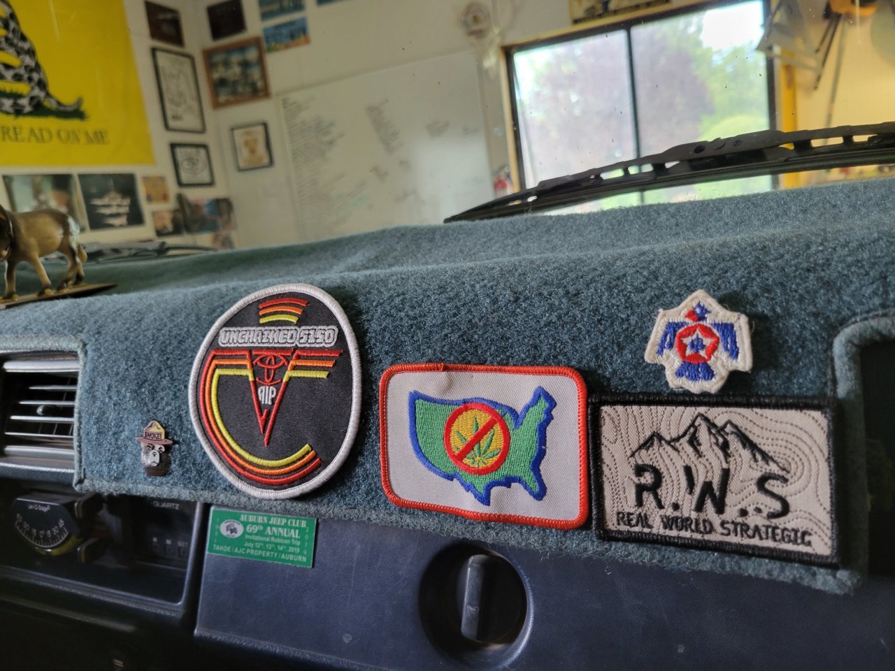

    RIP Rick patch :(

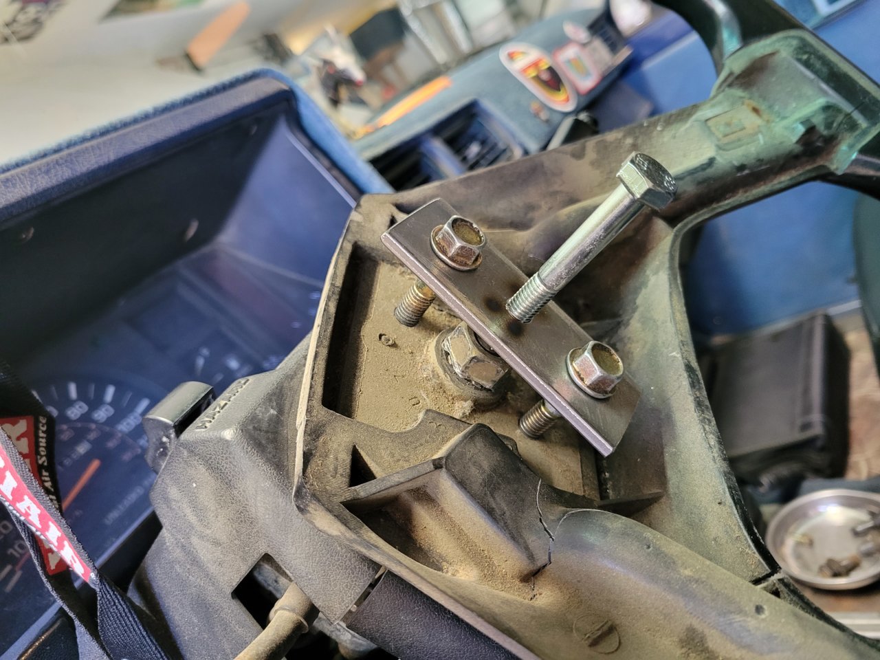

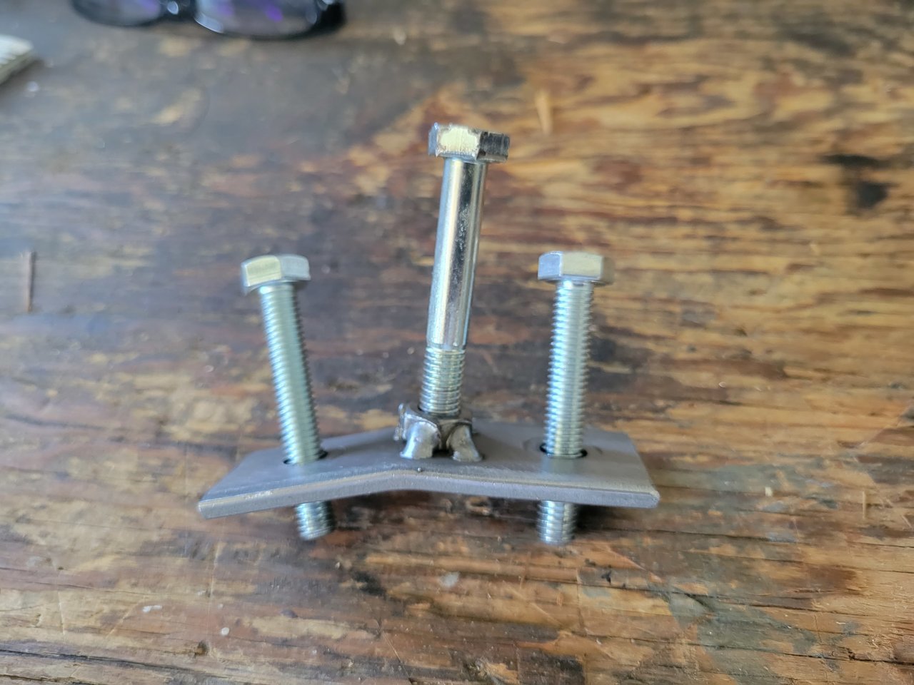

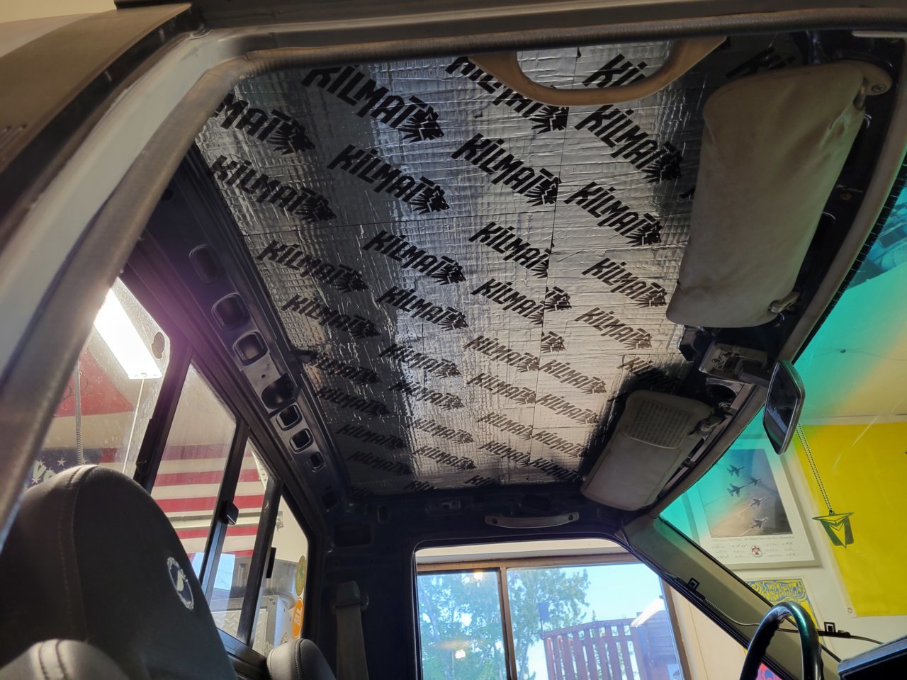

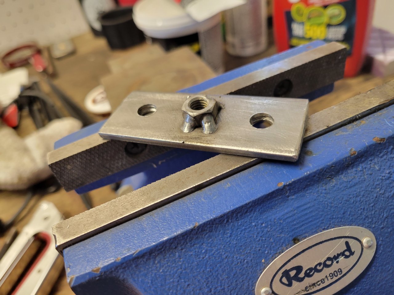

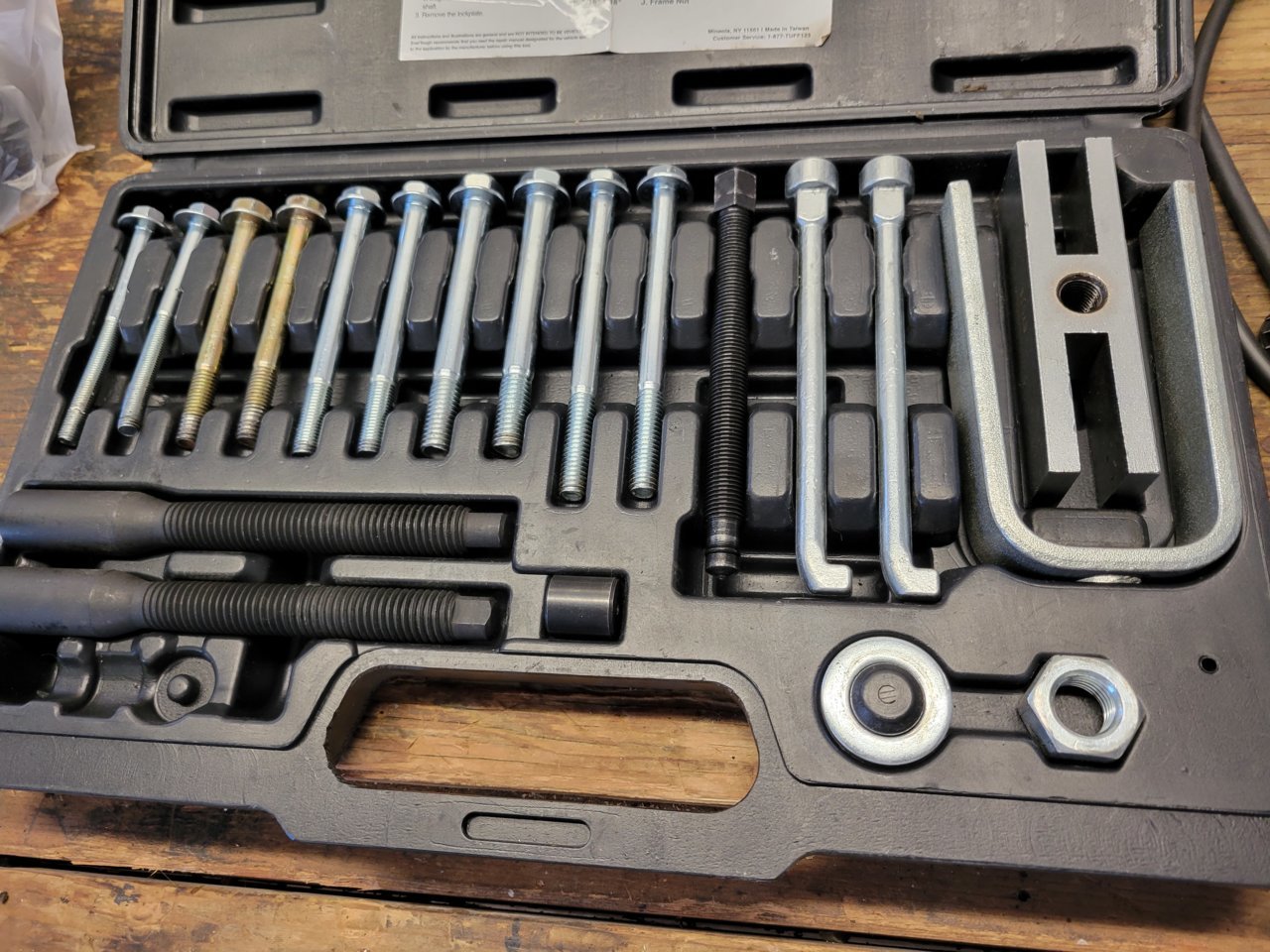

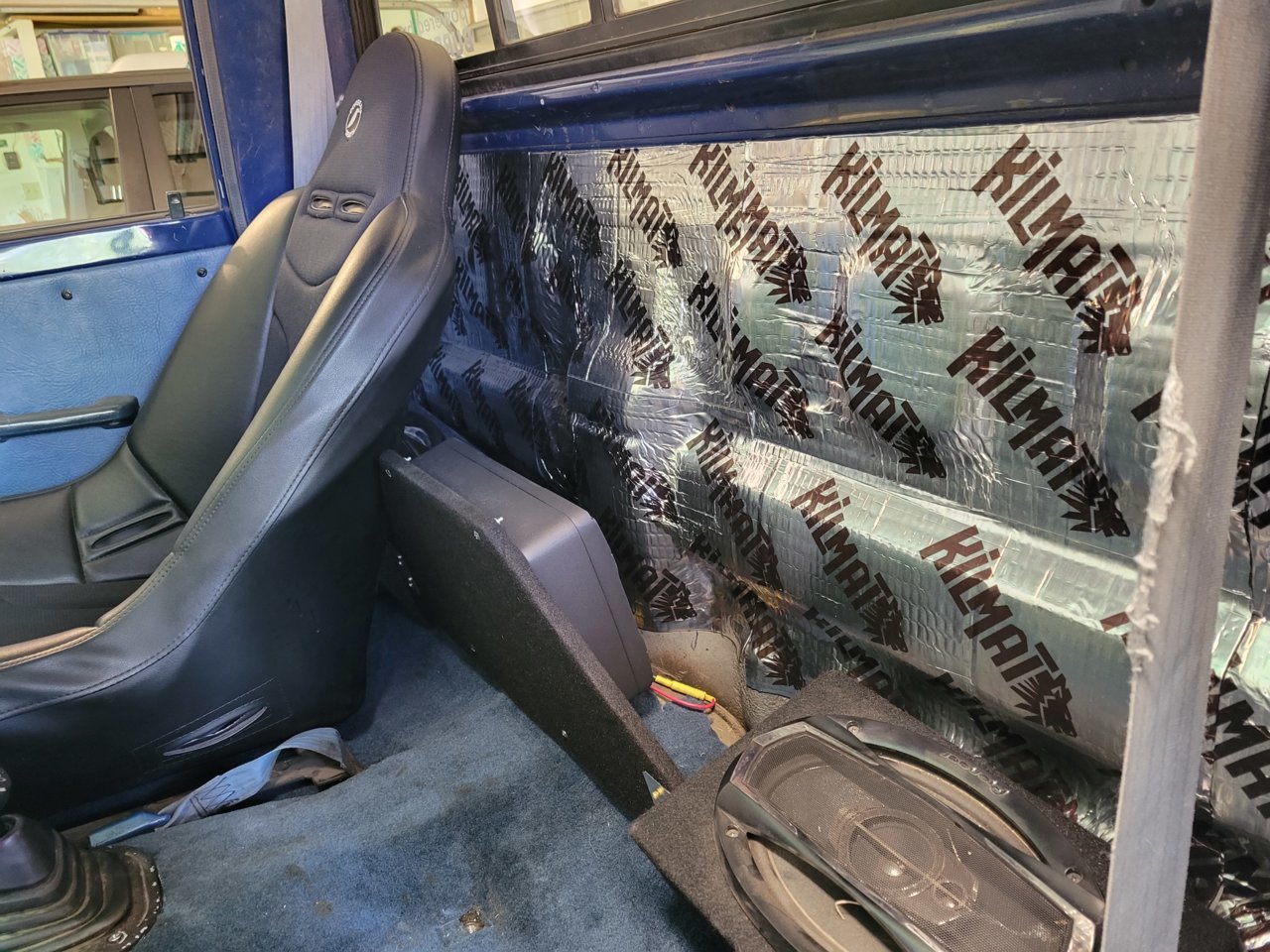

    Finished the sound deadener on the back wall. I didn't know killmat is russian.. fuck them but I had already bought it. Improvised a steering wheel puller but that didn't work so I borrowed one from oriellys. That worked. Progess.

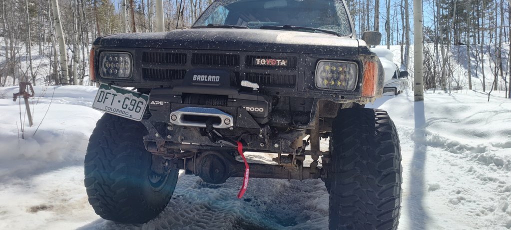

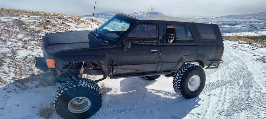

    I just read this full thread in 2 nights... I'm working nights and bored lol. super cool build! Did you end up building a 4runner on tons?? I recently picked up an '86 4runner SAS so now my interest is peaked! I'm new to the old school yotas but I'm in love with the damn things now...
    la0d0g[QUOTED][OP] likes this.

    I picked up the thing for 8,500 bucks a month ago or so. something to finally be able to do actual hard trails with and not beat on my third gen so much anymore... it's got 5.29 gears, lunch box lockers, 4:1 gears in the t case, 22RE 5-speed, six shooter knuckles, Hi steer, ... some other odds and ends.
    I've been learning as I go. it's definitely lived a hard life and I believe it has almost 300k miles... hard to say. it's got a different dash in it and the engine's definitely been out of it since the AC is deleted.
    I put a winch on it recently, picked up a set of first gen Tacoma bucket seats to put in it, and got a set of RCV axle shafts in the mail yesterday. I'm just itching for summer time at this point... also the front doesn't have bump stops and I noticed the bottom of the frame rails are dented in where the tops of the u-bolts have been contacting it :rofl: it's a little rough but it's got good parts and god damn is it fun to drive... I'd like to do dual tcases in the future but I'm just going to play with it as is for now. :bananadance:
    la0d0g[OP] likes this.

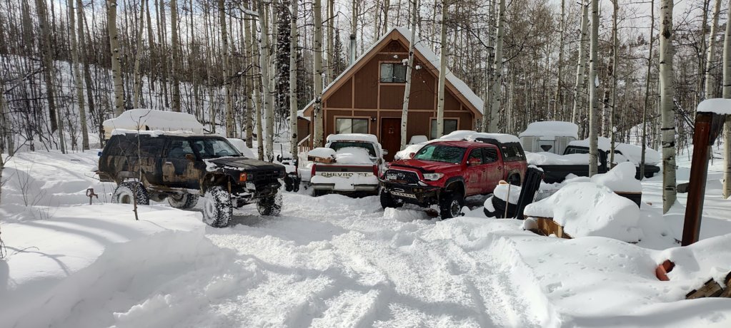

    :woot: I agree with you, they're fun trucks for sure. I'm jealous of where you live, looks like a nice piece of land!
