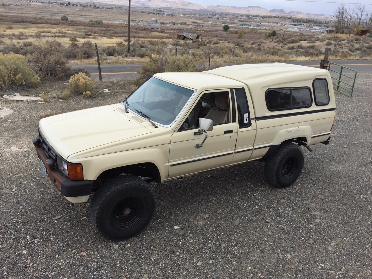

    Found another project...

    Nice! 84? 85? Need the details man!

    85 22r 225,xxx miles. I have dual cases and crossmember for it already, plan on tube bumpers, sliders, ome 2" lift with 33x10.50s and maybe a set of 35's for wheelin but not sure yet.
    I wanna tear my 85 4 runner apart and 4link the front end and deavers in the rear. So in the mean time the pickup would be the fun toy, and probably the dd so I don't keep racking on miles on the Tacoma.
