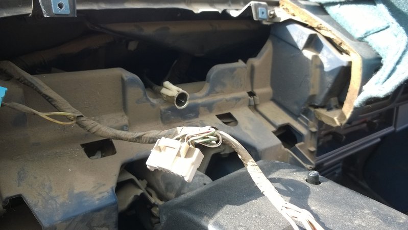

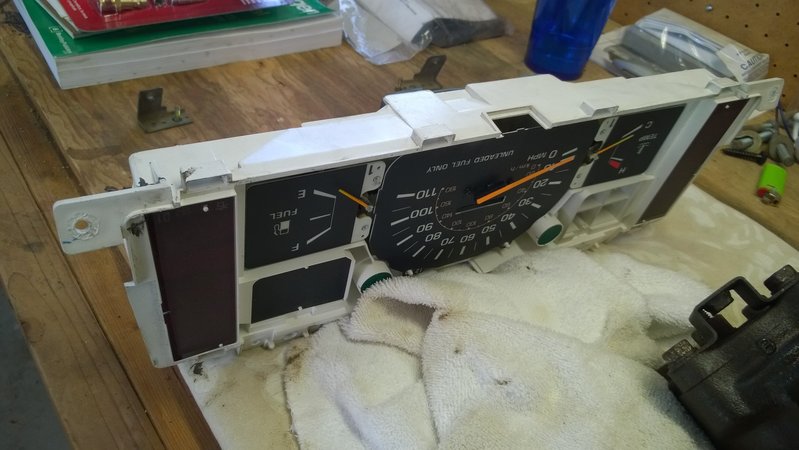

    My speedo cable was making a pretty obnoxious noise the last few months, especially since its gotten cold. This past weekend I decided to try and make it go away. Got the dash apart and cluster out. The bottom right tab on the cluster was broken so I used some JB weld to put it back together. I bumped it while it was curing and then completely broke it off again when reinstalling it :facepalm:
    I drove around with the speed cable exposed and, while steering with my knee, sprayed lithium grease in there. I did this for a couple of miles until I thought I got enough in there. Put it all back together and took it for a spin and the noise was gone. I did notice this morning that it was kind of making the noise again but definitely not as bad. From all the stuff I've read about this problem it seems the only real, long term fix is to get a new speedometer cable. I checked with the auto parts store and they don't have them and I also read that toyota is one of the only places to get them. I do have a credit with toyota right now so I might drop the duckets on a new one and be done with it. I'm also going to p'n'p on saturday so maybe one of the yotas there will still have one :fingerscrossed:
    The tab on the right bottom was broken off. Trying to jb weld it back together.
    Drove around and sprayed grease

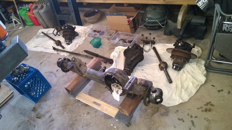

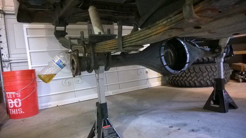

    Making progress. I cut all the unwanted metal brackets of the housing, cleaned all the old grime off and hit it with some rattle can. Installed the new eco inner axle seals, new diff, 30 spline chromo axles, and got the knuckle assembly all buttoned up including a set of trail gear knuckle seals. While I had the rear axles out I took them to a brake shop and had them work on the frozen bell crank for the ebrake. While they had them apart we noticed all the rusting parts and old junk so I said F it and had them redo all of it for another $100. Got that put back in with the new diff so the rear is done too. My only hurdle right now is getting the old tie rod off of the drivers side knuckle arm. When I was tearing everything down the passenger side popped right off with a tie rod puller but the drivers side was so seized it bent the tie rod puller so after messing with it for a bit I decided to just cut the tie rod arm in two and come back to it later. Well here I am and I still can't get the F'er off. I've soaked it, heated it, hammered it, pickle forked it, on and on and it won't budge so tonight I'm going to start drilling it out and be done with it so I can start driving it again since the taco is making a fucked noise which I can only assume at this time is a CV about to go boom (haven't driven since last week when it started).
    Marlin high steer arrived last Friday so next up is burning in the PS mount and installing that stuff after which I can put on my last ubolt flip. And then I'll be done with mechanical stuff and on to some armor items.
    We're getting there, slowly but surely :D
