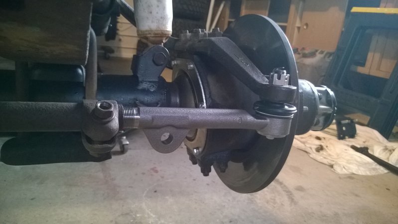

    I ground down the bolt close to flat with the arm, then took a cone shaped dremel attachment and made a indent in the tie rod bolt so the puller bolt would seat tight. Not sure what the difference was this time, maybe hitting it multiple times using a brass drift broke the rust seal, but after five or six turns it popped right off. I made a loud exclamation, my wife smiled at me probably due to being excited that she wouldn't have to hear me bitch about it any more.

    We're back on the road breaking in the new gears. Definitely more pep, in 3rd around 30mph. Two weeks until the Rubicon!
    List off shit to do:
    Install OBA
    Hook up lockers
    Wire OBA and lockers
    Grind off old front bumper
    Install new bumper
    Install winch
    Install IFS PS mount and PS box
    Install high steer
    Hopefully get some sliders burned in
    Long list and as always it comes down to the wire. Such is the procrastination life! :D
    Some pics of the reassembled front.

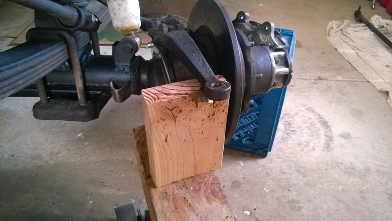

    I don't have a welder right now so I have to drive it to Eric's shop to get the mount in :anonymous: I did use liberal amounts of anti seize on the cone washers for the knuckle arms so hopefully I can smack it with a drift and have them pop right off, reuse the shims and plop the new ones on. That should be cool right?

    Should be, do you have the knuckle tension measuring springy tool deal? That'll make sure the shims are correct.

    My brother bought me a fish filet kit back in the day that has a fish scale in it :D

    This weekend I finished installing OBA, lockers hooked up, and electrical all done. Then I moved on to pulling out all the old steering components and cleaning up the frame rail. Just need to cut the old bracket off the inside frame and I'll be ready to install the new mount. Also installed the new knuckle arms. Turtle power!

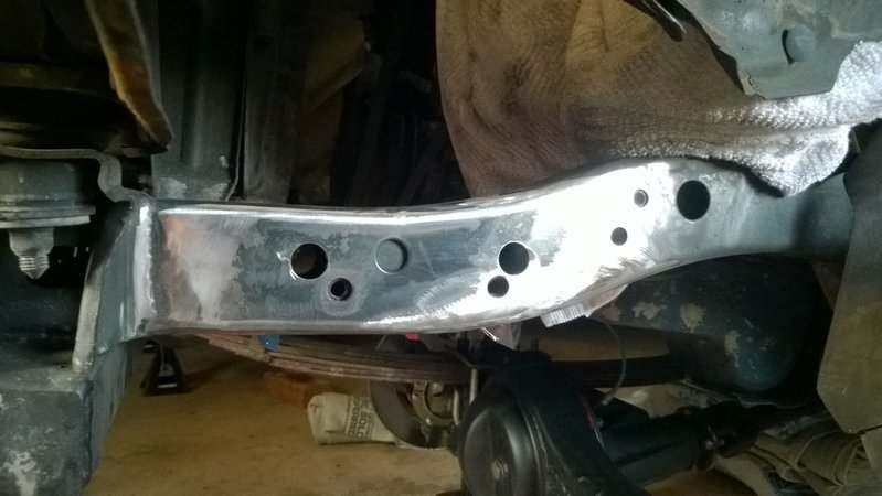

    Finished up prepping the frame for the high steer. Cut off all the old shit from the frame, drilled the 3/4" holes for the PS mount, and flapped the frame. Ready for burn. So close to a shakedown run!
