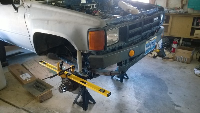

    IFS steering box went in last night. Then picked up two harbor freight 48" levels to help with the alignment. Then installing the drag link and tie rod. Fill the radiator back up, get some ATF fluid in for steering and I should be ready for my shake down run this weekend! :woot:

    Getting ready for alignment. 57.625" looks to be the sweet spot.

    Hah, I set mine with the exact same method.

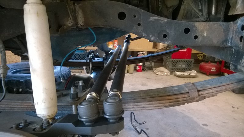

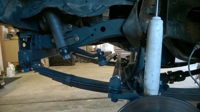

    Put the steering back together today. Only shitty thing is my steering shaft is too short by like 3/8". When I installed the non IFS power steering box a couple years ago I had to lop of a little of the shaft and now its coming back to bite me. So I went to pick n pull to try and find another one. Found an extra cab IFS pickup that had the same one (or so I thought) so I pulled it out without measuring because I didn't have a tape measure and it looked the same. Got home and this is the 18" version instead of the 16" version :facepalm: So now I know there are two different types. Found a 16" version on ebay for $19 so I guess I'm going with that.
    New high steer drag link and tie rod all buttoned up
