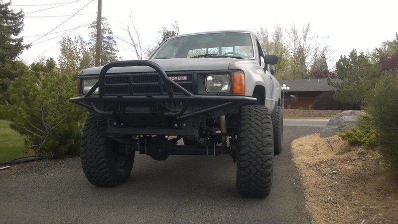

    Just gussets... everywhere
    Is that pic without shocks? What's your shackle angle at ride height? My 63s don't droop a lot just flexing it but on forced articulation they really open up.
  2. Apr 24, 2017 at 2:16 PM
    #162
    la0d0g
    la0d0g [OP] Its 4 o’clock somewhere
    Jan 25, 2011
    #49903
    19,690
    running for the hills
    For crawling not hauling
    That is with the shocks on. Shackle angle is parallel with the frame at ride height.

    Parallel with the frame? That's not good
  4. Apr 24, 2017 at 6:03 PM
    #164
    la0d0g
    Jan 25, 2011
    #49903
    19,690
    Yeah that's why I'm going to try the double approach. If the doesn't work I'll cut off the rear hangers and reposition them.

    Stock shackle hanger location? That would be the reason you have no flex. You have to remount both the spring and shackle hangers.

    No. The rear has been pushed back from stock but it was the previous owner that did it so I don't know exactly how much. I agree though that that is the reason for the lack.

    You might consider a longer shackle and getting rid of the missing link. My spring eye is about the same location and I run like a 6 inch long shackle (with the stablizer thing connecting them cut out). Its way more predictable on the trail than missing link in my experience and won't* make a ton of noise every time you git a bump and they open and close.
    Although both my brothers ran missing links on their samarui's with no problems. Front and rear.
    I'd agree with the others that most likely your shocks are binding up and that's why your not getting full droop. Take them off and try the same flex and I'll be they drop way more. My brother (after selling the sami) ran 62's on his 4runner and they flexed like crazy from the get go but he moved his shocks to the top of the axle and up into a ^ shape.

    I have some 6" shackle plates my buddy left at my house from his YJ that I might drill out this weekend and throw them on. I also have some long billy 5125s to throw on and splurged on a shock relocate for the rear just haven't gotten around to doing it. Hoping that'll help the droop.
