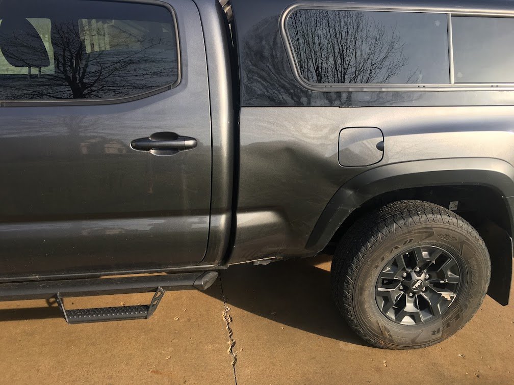

    A young lady backed up into my truck while I was turning into a parking lot and dented the quarter panel into the fender. The paint is basically undamaged and I was hoping for PDR; however the dents are large and the first place I visited quoted nearly 6K for a quarter panel replacement. Alternatively, depending on insurance, they may also repair/paint the quarter panel.
    Anyone have experience with a similar repair (PDR?) and/or possible paint matching for MGM? My insurance is not on the hook for this repair and I'm fine with the QP replacement but am doubtful about the color match.

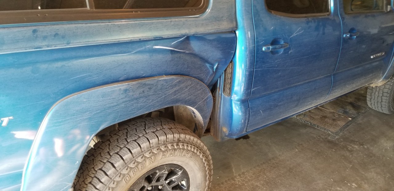

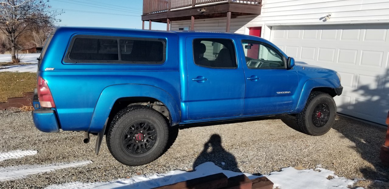

    I don't know if you're mechanically inclined, but I had damage much worse than that on one of my bedsides. I picked up a used bedside in decent condition and had it painted for $1000 all in. After pulling and replacing the bedside myself, you'd never know the difference. If you go to a good paint shop they will make it indistinguishable. Just a note, it has a few more small dents now, but the color is spot on lol.

    Yes, her insurance will cover it. I would be fine if a PDR expert could get it very close to original appearance, but it looks like thats not going to cut it in this case.

    do not let them repair that panel, demand a replacement. you are not PDR'ing that panel, with that amount of damage. 30 years in the collision industry. Ski

    Thanks Ski. Your expert opinion is very helpful; going to demand a replacement.

    no worries, sorry this happened to you. from the pics, the flare is damaged too, color match wont be an issue at a quality shop. the only thing I would be worried about would be damage behind the outer panel but, that will be noted after tear down for replacement. it is a bolt on panel for the most part so, it isnt like a gm, dodge, ford that needs welded on panels. good luck. Ski

    Dude that is way too big for PDr. PDR fixes hail damage and door dings.

    Looks like a good flatbed candidate to me! If you're bent on keeping the bed, I'd ask a paintless dent repair (PDR) person or two. I don't see any creases or scratches in the pic. Plastic fender trim should be an easy R&R.

    That dent really isn’t that bad the way it is. Definitely not 6k. I would write to fix it. I would weld onto the panel and pull it out. Most of it would pop back out.
    Bet you can go to harbor freight, get one of those cheap suction dent puller and pull it out. If you get a good enough suction it pops out and a 6k repair goes to 2500
