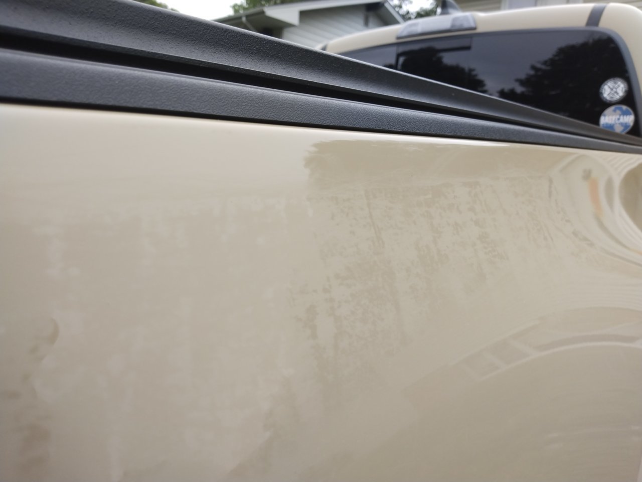

    If you blow up the pic you can see a multitude of flat and glossy areas where the 4x4 TRD Off Road sticker usually residents.

    Report!

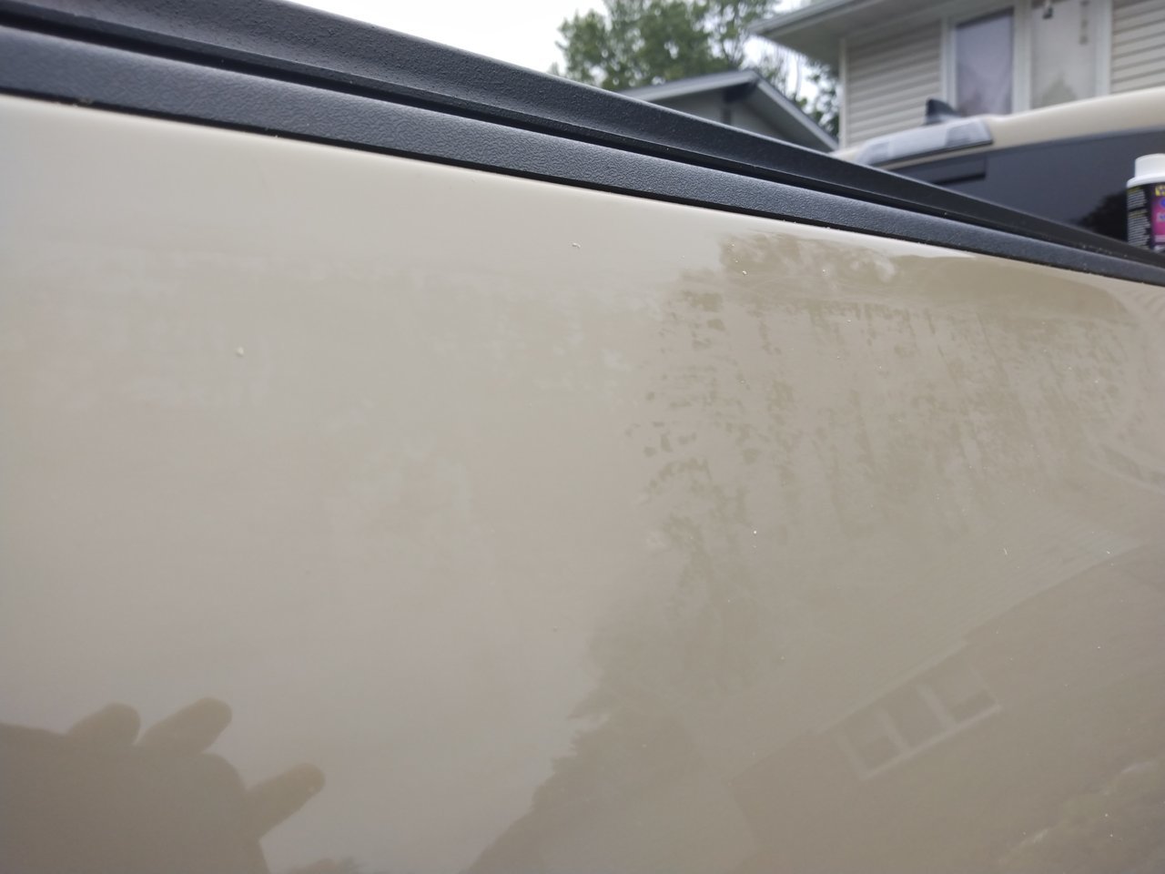

    Well I went back to the paint specialist place and got the strongest industrial cleaner they had....
    I then went to work in succession;
    1. I started with industrial cleaner, a bit of rubbing then soap and water.
    Result - negative, it didn't touch ANY of the remaining gunk.
    2. I then moved to the old Meguiars clay bar that I've used a TON before for tree sap.
    Result - minimal, I rubbed and rubbed (lol) on it but not a whole lot happened, just a bit more of a dulling effect. It didn't do much to it but did make things a bit smoother feeling. It was still VERY evidently there when looking at it in the light.
    3. Next up was the wonder wheel (aka stripe eraser, aka eraser wheel) attached to my variable speed drill
    Result - negative, I took the elbow grease to this one as much as I dared for fear of burning through any of the clear coat but even after going over and OVER it with the wheel for 15 or 20 min, it didn't make any difference to the marks at all. I really had high hopes for this one as the wheel was quite a bit more expensive than I figured looking at the ones on Amazon. Alas it was not to be this time and that's when I knew it had to be into the clear coat.
    As you can see there was little to no difference but it did make a heck of a mess:

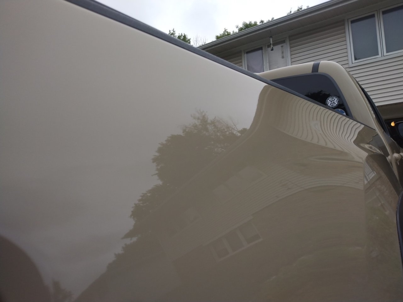

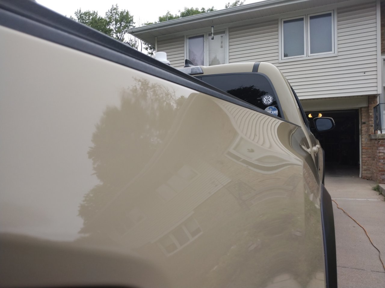

    4. Feeling a bit desperate, I broke out the two small bottles I purchased from the very old school guys at the car color shop, "Wizards" cut compound and the accompanying polish/swirl remover:
    Result - WE HAVE A WINNER!
    This stiff IS made by some magic wizard!!
    I started with the compound and put very little elbow grease into it at first and even then it REALLY started to get after it!
    Hell, after 2 or 3 rounds of using the compound by hand it looked SO good I nearly didn't even need the polish.
    Super duper happy with how but turned out after a few rounds of using the polish by hand and then a buff out with a new micro fiber cloth:
    Yay! Day saved for sure, and I can HIGHLY recommend the Wizards brand compound cut and polish. Per my brother who is also old school, indicated Wizards has been around a LONG time.

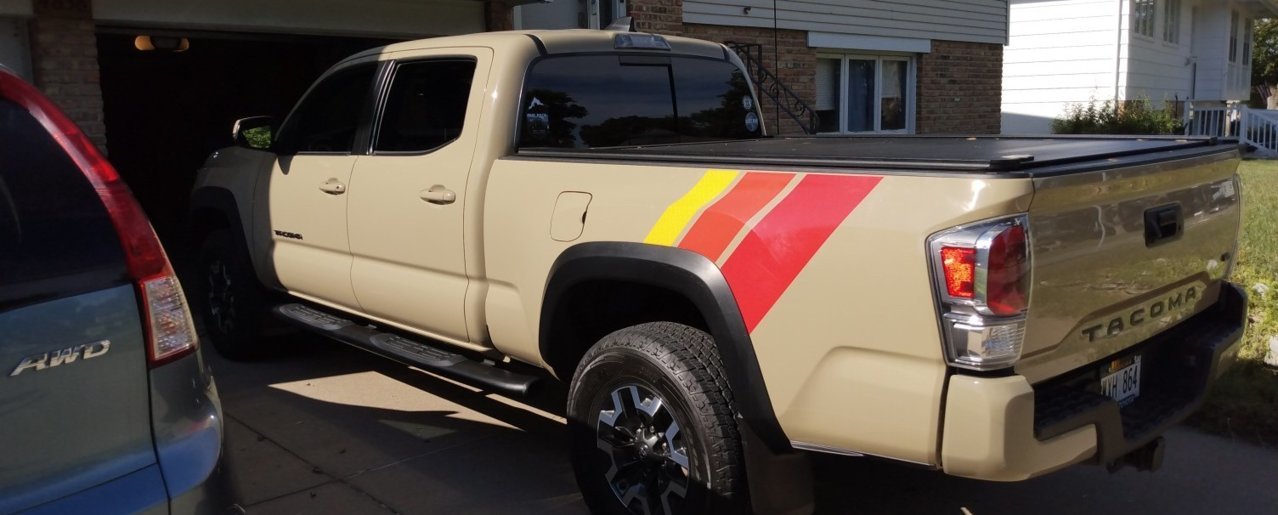

    After getting the 4x4 TRD stickers off and then getting the remaining residue off I got to work getting the replacement on and the reason for the factory sticker removal in the first place
    I've got the passenger side rear heratige stripe to get on, then a 3rd much smaller one for the nose.
