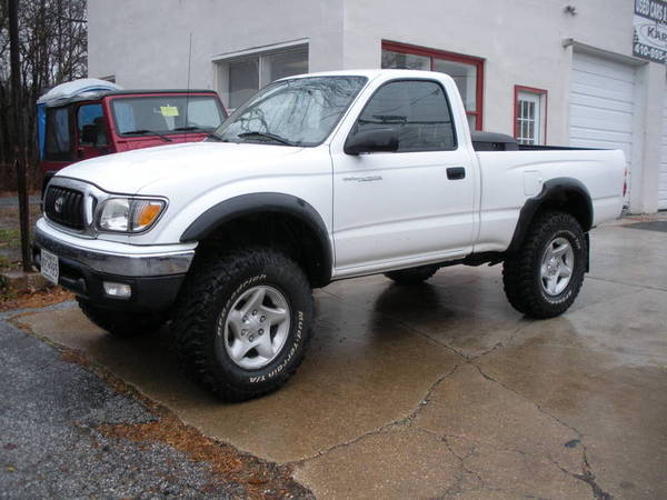

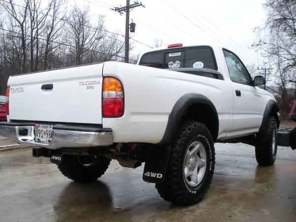

    I drive an 01 2.7L 4X4. I lifted it 2 1/2" and run 33" tires just fine. I drive it everyday. I also rock crawl, mud hole, and trail ride it. I don't see 22 MPG. I get around 18 MPG. I don't believe you will fit 32s with out a lift. My lift is recommended to run 32s, but I have 285/75/16's that equals 33X11.3. Because they are narrower then the 33X12.5 I have been able to make them work with a $15 set of 1/4" spacers for the front.

    My lift is 2 1/2" spacers in the front struts and a larger shackle in the rear with Skyjacker shocks. Its actually quit simple. The spacer I mentioned are 1/4" wheel spacers to push the front wheels out away from the upper control arm. This could be accomplished by replacing the rims with rims that offset some.

    Sorry about the delay in responding. The rear of my Taco is lifted with a larger shackle. It is supposed to be 1 1/2" of lift in the rear and 2 1/2" in the front to level it. Unfortunately, the rear springs have sagged some over the years. So now the front is up 3/4" more then the back. I am installing 2" add-a-leafs in the next week or so. That will put the rear up 1" or so higher then the front. Similar to the factory stance.
    To answer another question. My original lift cost me about $250 with the shocks. I paid a friend (mechanic) $150 for his time and tools to help me install it. I think I got by cheap with professional help. I just got the add-a-leafs for $60. I am not sure if I am going to recruit professional help this time. I really need to replace the brake line first.
