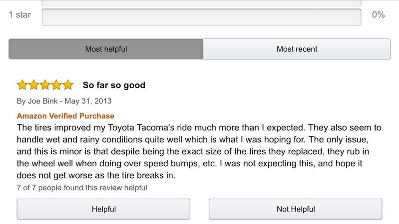

    I'm planning on finally replacing my stock Bridgestone Dueller's with a set of Michellin ltx ms2 tires. I saw this review on Amazon from some guy saying his tires rubbed on his Tacoma,despite replacing his old tires with new tires the exact same size as his old ones. It's got me a little concerned. I don't want my tires to rub. My question is #1 if the new tires are the same size tires as your stock tires,is it possible that they could be taller and not fit? #2 Does anyone here have Michellin ltx ms2 tires on stock wheels size 265 60 18 without any rubbing issues? Thanx!

    Or an idiot.

    Clearly a retard, look at the last statement 'hope this doesnt get worse as the tires break in...' Ya cause tires typically grow as they break in as we all know.... Dumbass!
    I wouldnt worry about rubbing with theses tires, but you can look for yourself by going to a curb andnplacing your front tire on it at full turn and see uow much room you have to work with. This is not perfect science but will give you an idea at least.

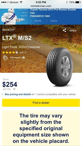

    I found this on the Michellin website, according to Michellin it looks like it should fit..... I hope!

    Just thought I'd give an update. I got the Michellin's installed today,no issues,no rubbing. They look great & The ride is smooth as glass! I couldn't be happier! Thanks for everyone's help!
