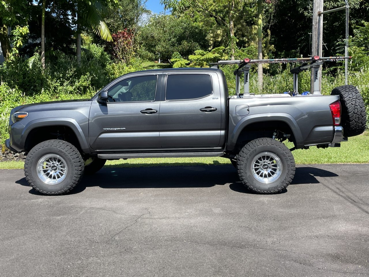

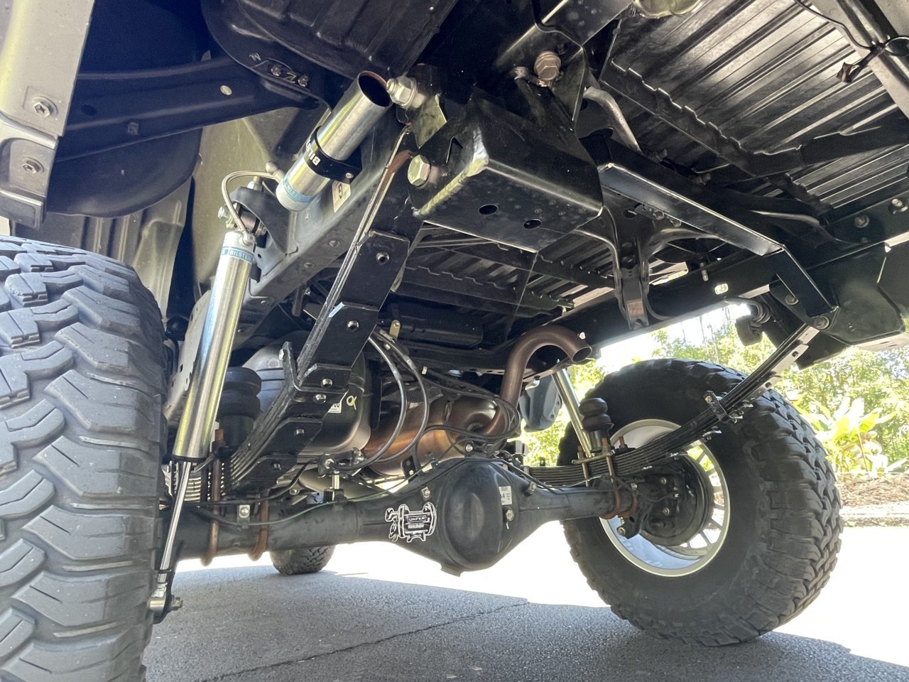

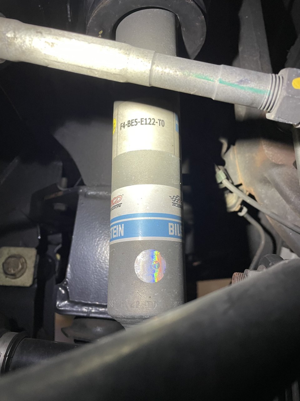

    Here’s the front shock number in case you just want a Bilstein 5100 full length
    I have 5160’s in the rear, 12” travels. My truck is on 35s
