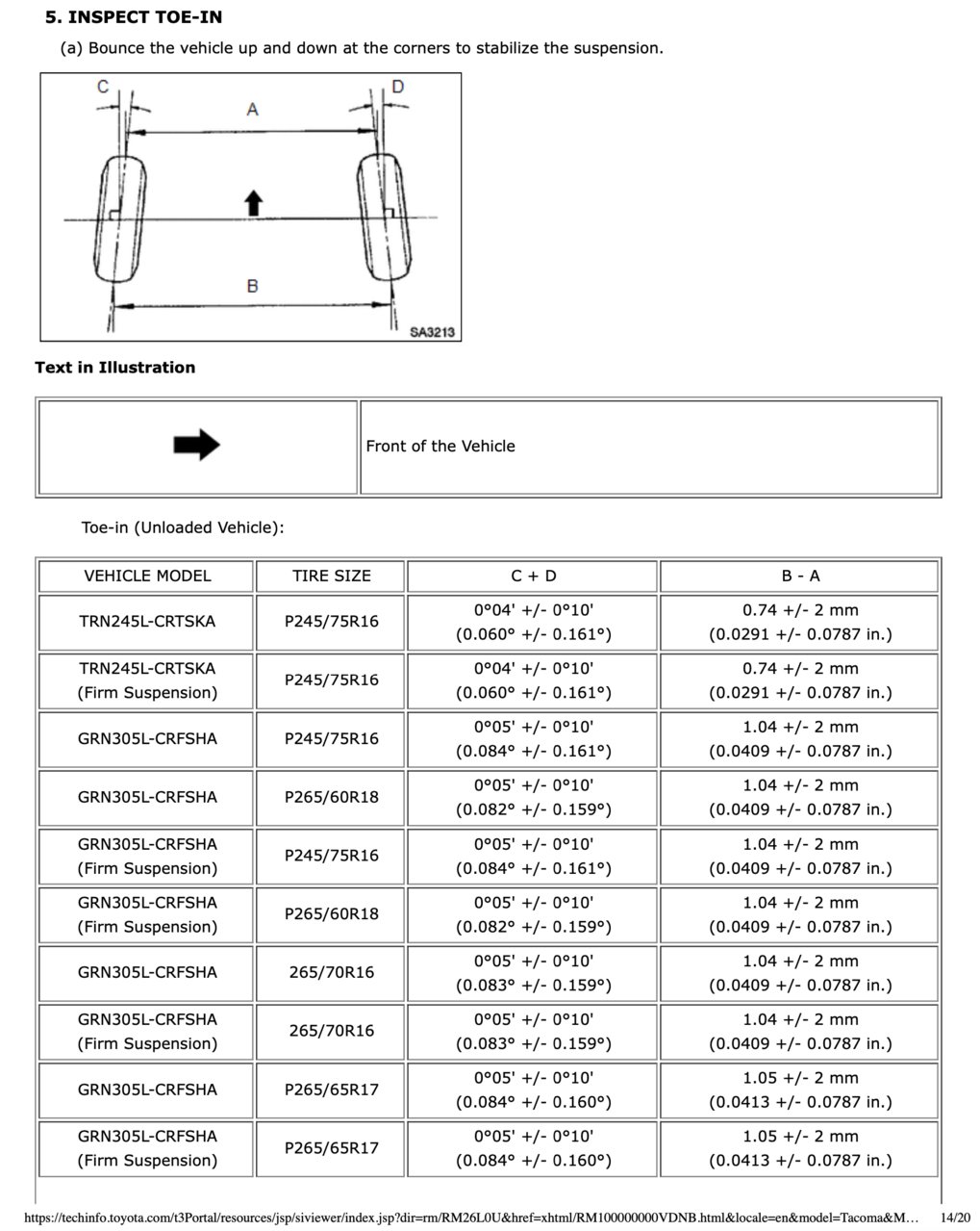

    I've been wondering about this too, the majority of answers online and even in professional shop is that if I'm only changing wheel offsets, I don't need new alignment, because offsets will not alter camber, toe-in, and caster settings.
    However, what you are saying about scrub radius makes sense to me. I'm just not sure if I understand it correctly. Here is what I think is going on:
    • going from more positive offset (OEM) to smaller or negative offset (aftermarket) will push the center of the contact patch away from the original line and thus introduce more positive scrub radius
    • this deviation of scrub radius will somehow change the steering behavior of the vehicle
    • your suggestion of give it more toe-in to counter that deviation
    Does this deviation of scrub radius only affect the vehicle when cornering? If so, by giving it more toe-in to counter that deviation will mean that when going in a straight line there will be extra amount of toe-in (still within the plus and minus delta in the factory spec)
    so in summary, I can choose:
    • leave it alone, don't do anything but the steering behavior will change to some degree
    • change the toe-in angle slightly, but will slightly increase tire wear because adding extra toe-in
    or there's something I'm mistaken fundamentally?
    Thanks for your reply
