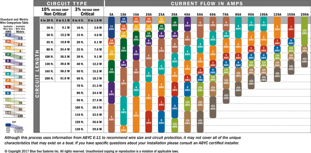

    Not sure which cables you're talking about, but the factory ones coming off the batter are 2 ga iirc
    Yes, distance matters a little bit. As does surge (or startup) amperage
    As JdevTac said, always better to go too big.
    See the chart below for some better info
    http://www.offroaders.com/technical/12-volt-wiring-tech-gauge-to-amps/
    JimboAnz[QUOTED] likes this.

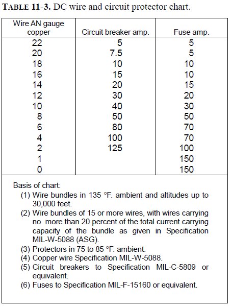

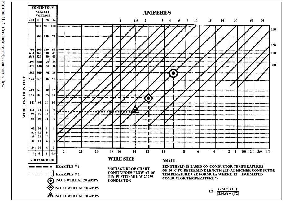

    This doesn't directly answer your specific question, but just want to remind that there a few items that go into it:
    Aviation guy here, so all my wiring is based on AC 43.13 using 100degC MIL-W-22759 wire...
    See Chapter 11, Section 5 (also Section 4),
    http://rgl.faa.gov/Regulatory_and_G...9baac81b86256b4500596c4e/$FILE/Chapter 11.pdf
    All examples below are based on good (not rubbery shit) wiring insulation
    Normally sizing wire requires
    Sufficient mechanical strength (use #20 AWG or larger wire, and for smaller wires or wire bundles support more often and shield, use fine stranded wire and be especially careful at solder joints).
    Sufficient current carrying capacity for the circuit protection device.
    Sufficient wire size to keep voltage drop at acceptable levels.
    So normally 2 separate checks are required:
    if the wire shorts to ground we want to make sure the fuse blows before the wire gets too hot, melts the insulation and lights the vehicle on fire. The wire will get kinda 'hot' for an instant before the fuse blows, we just need it to not self-destruct.
    we want to make sure that the device hooked to the wire will operate correctly without excessive voltage drop in the wire, and the wire getting too hot.
    Example, the fancy LED only pulls 1 amp, which requires a tiny wire. But the wire is hooked into a 5 amp fuse which powers a bunch of separate LEDs. The voltage drop check will not be critical for this wire, only the circuit protection check for 5 amps without damage (22 awg aviation wire can handle this theoretically).
    For separate example, assume that a 4amp led on a 5 amp fuse. The same fuse condition applies giving 22 awg minimum, but now the voltage drop check at 15 ft long requires 18 awg. (Remember full current path length is critical, although a good ground to frame has pretty low resistance for smaller currents.)
    As already stated, larger wire is always acceptable, provided it is mechanically acceptable (with acceptable insulation, strands, etc).
    Cudgel likes this.
