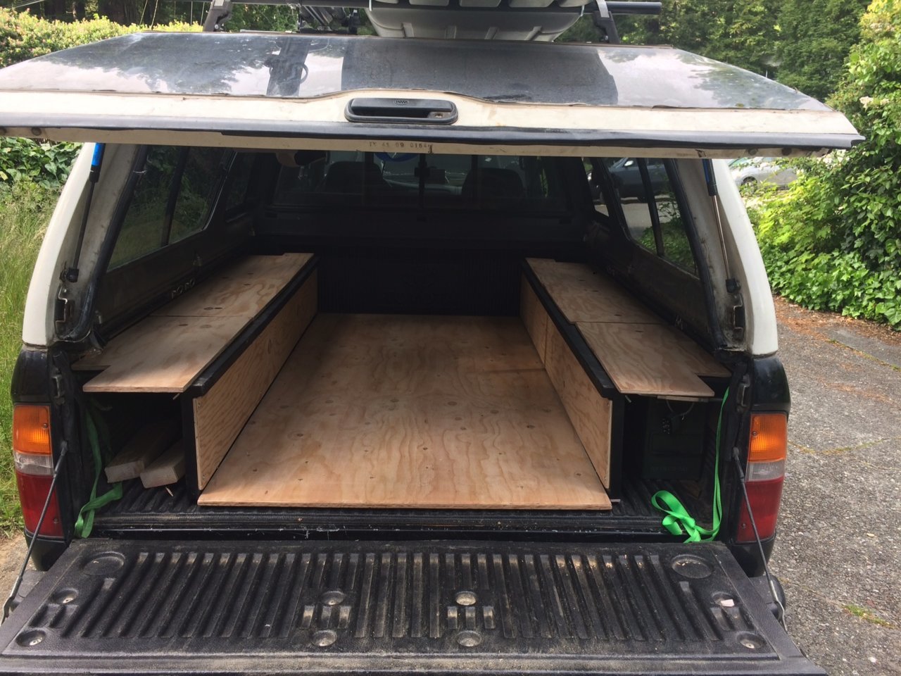

    jnossoff 2000 Xcab Pre-Runner with Leer 122 shell
    Jan 1, 2014
    #119667
    400
    Joel
    Albuquerque NM
    2000 PreRunner SR5 TRD Xcab V6 A/T
    @ScampTramp
    @Greg3492
    For a very different approach to a sleeping platform, take a look at https://www.tacomaworld.com/threads/sleeping-platform-dog.308557/#post-7938389 from @sc
    The link to his photos at http://s941.photobucket.com/albums/ad254/phlyphishers/sleeping platform/ is v e r y s l o w to load. But worth it.
    I suggest you read the TW thread from beginning to end, for details, suggestions, and improvements. I used his bed-frame idea as a starting point, and made some adjustments of my own, which I added to the thread on page 2.

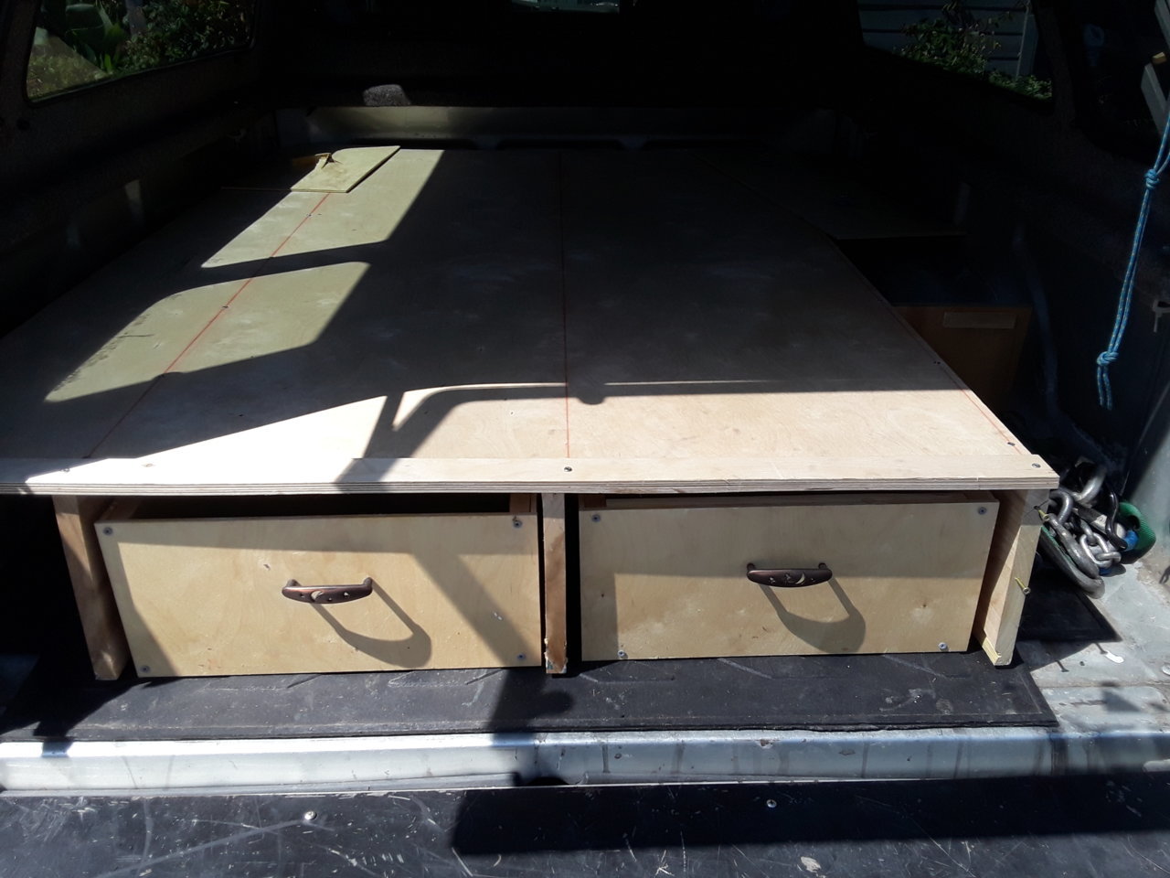

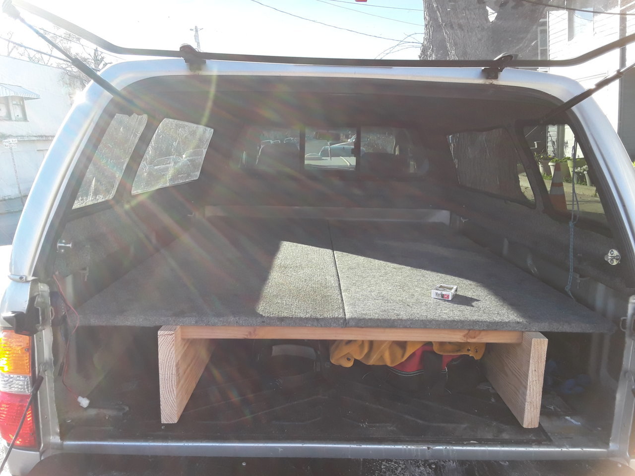

    Here’s mine.
    chrispchicken9 likes this.

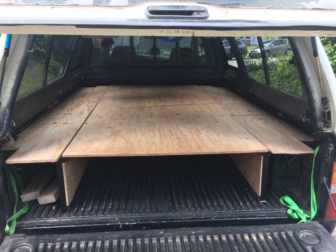

    otis24 Hard Shell Taco
    Dec 3, 2012
    #92402
    6,484
    Mark
    California
    OtisBound Outdoors Bodonkadonk
    OtisBound Bodonkadonk
    I've built 3 platforms for my truck. The 1st two were wood. They were heavy, vulnerable to water and broke apart from off roading and my crappy build quality.
    The 3rd one I built out of Aluminum with a 3/8" plywood top. It's 65 pounds including the top. The last plywood platform I built out of 3/4" plywood weight 250 pounds with one drawer. The aluminum one is vastly stronger and way lighter.
    Here it is in it's current shelf mode.
    What the weight on your platform. Most of the ones I see are super super heavy.

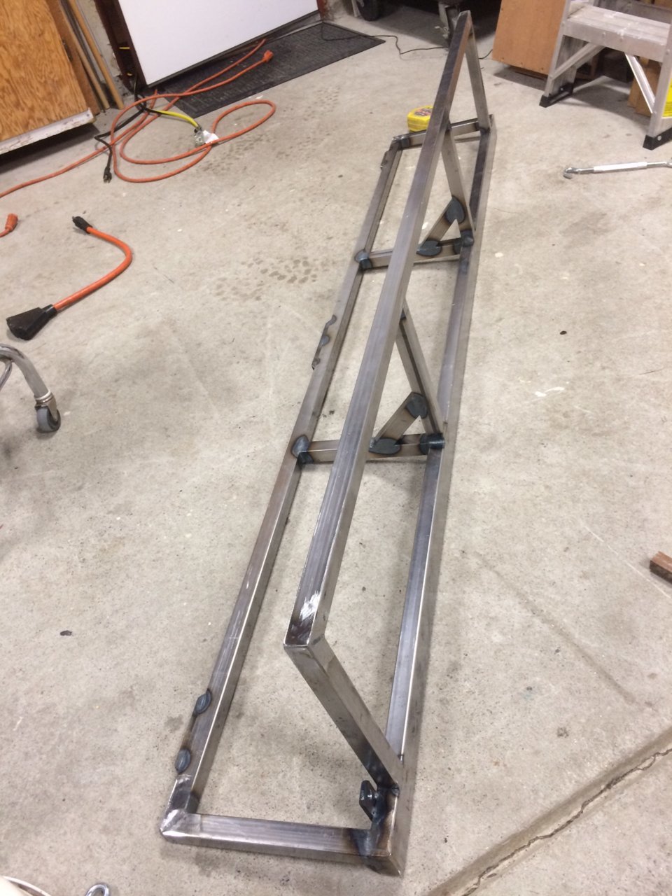

    steel camping platform with wood siding. you can put the platform down so you can still use your truck to haul stuff or put it up to sleep 2 people/hide gear.
  11. May 27, 2019 at 9:02 AM
