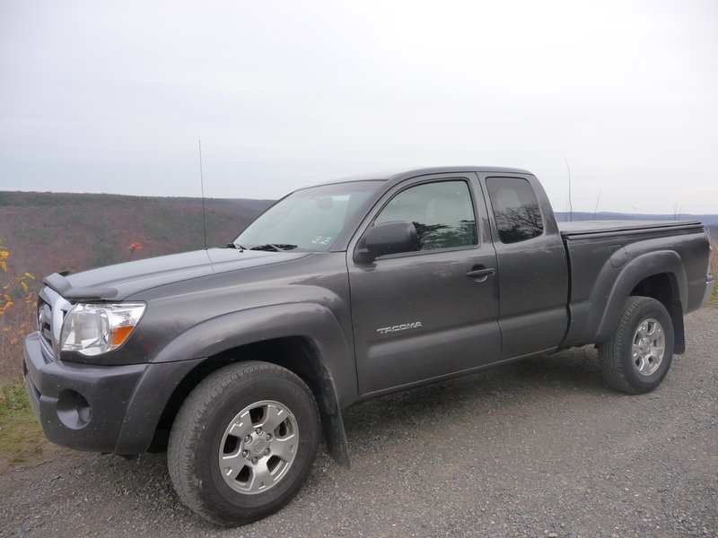

    Stock tire size on 2010 Access cab, SR5, 4x4, 2.7l, 5 speed MGM Tacoma
