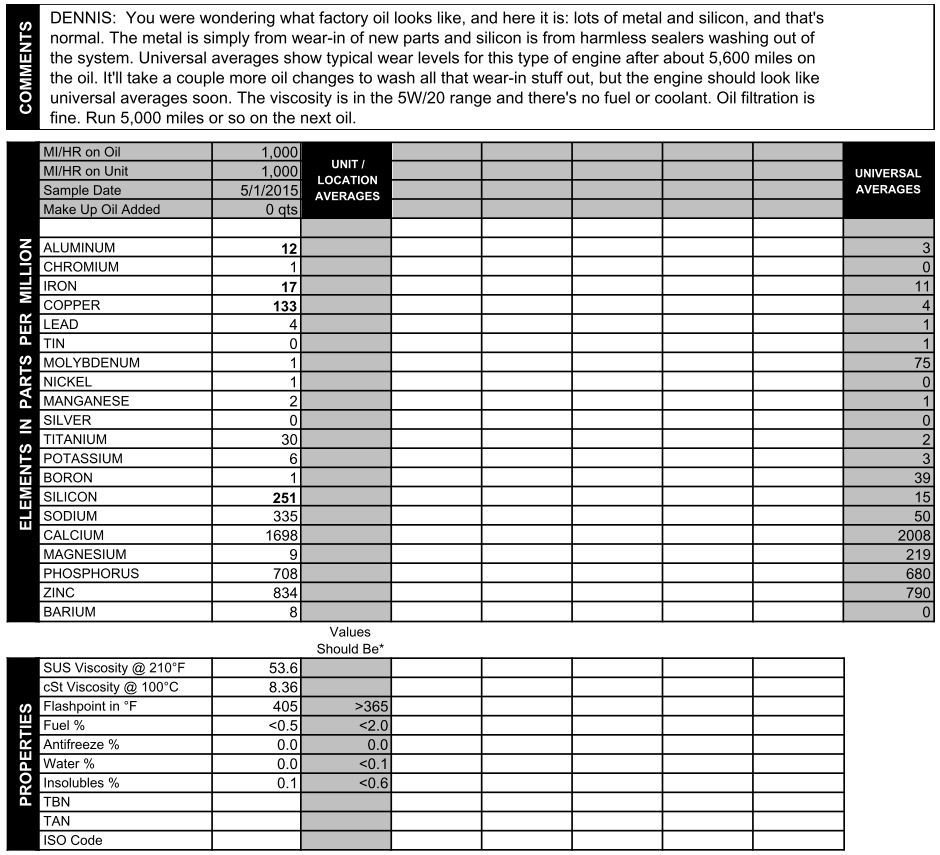

    I just bought a 2015 Tacoma back in late February, 2015 (less than three months ago). At 1,000 miles, I changed engine oil, Front and Rear differentials, and transfer case oil. Just for grins, I had the used oil analyzed even though it had only 1,000 miles on it. The link below is to the report for the engine. Highly elevated wear metals were present.
    TACO_Engine_1_zpse8ixteog_92a2ba50f4ed204810a199389500e2fa68ebcaa3.jpg']TACO_Engine_1_zpse8ixteog_92a2ba50f4ed204810a199389500e2fa68ebcaa3.jpg[/URL]

    That seems to verify that you had oil analyzed which had come from a brand new engine. Reading the comments section appears to me that they in effect said "Denis your oil came from a new engine and has exactly what is expected for oil coming from such an engine you should change your oil at the standard 5000 mile interval after two to three changes your oil will show normal (broken in levels).
    Having been a ground support equipment technician in the Air Force I fully understand the importance of oil and changing it routinely. At the same time one can grossly over complicate things. Where aren't maintaining NASCAR or Formula One engines here these are trucks. I will say with confidence that 99% of Tacoma owners will be fine and have a long lasting engine following the 5k routine for oil. In extremely dusty conditions perhaps more often.
