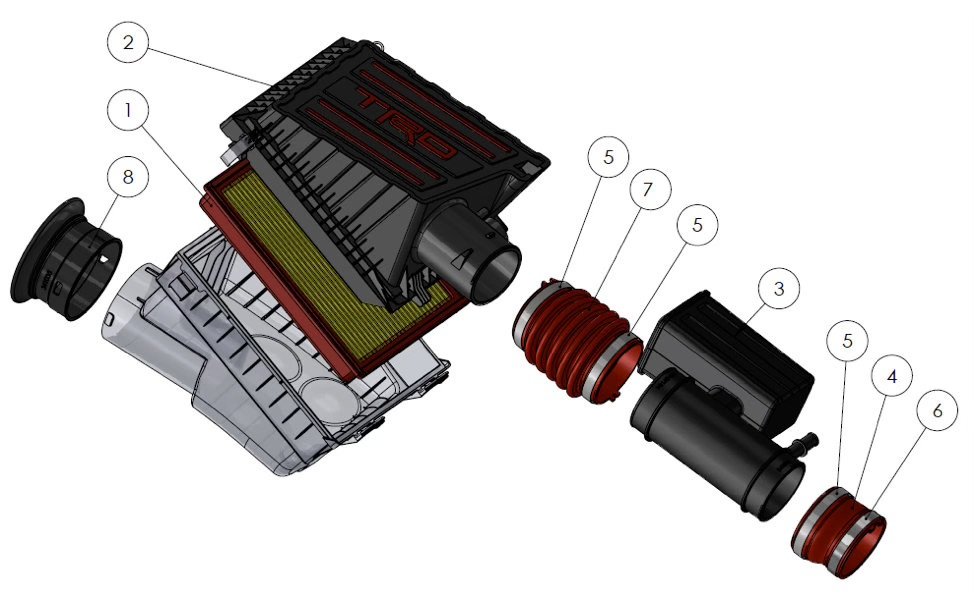

    Parts List:
    1: PTR03-34140 (TRD Panel Air Filter)
    2: PTR03-35160-AA (Upper Airbox)
    3: PTR03-35160-AB (Intake Tube) & PTR03-35160-AC (Throttle Body Coupler Kit)
    4: 341032 (Coupler)
    5: #52 (Hose Clamp)
    6: #48 (Hose Clamp) & PTR03-35160-AD (Airbox Bellows Kit)
    7: 341033 (Bellows)
    8: PTR03-35160-AE (Intake Flow Accelerator/Horn)
