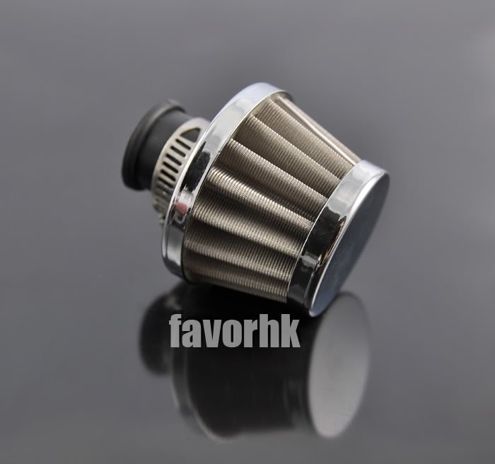

    I was at Off Road Warehouse today (Escondido) and they have these from K&N for the valve cover vents... two sizes, the smaller was 1/2"... looked just like this one... they are small and could fit over the extended breather or with a barb coupling, on the end of the tube without the factory breather.
