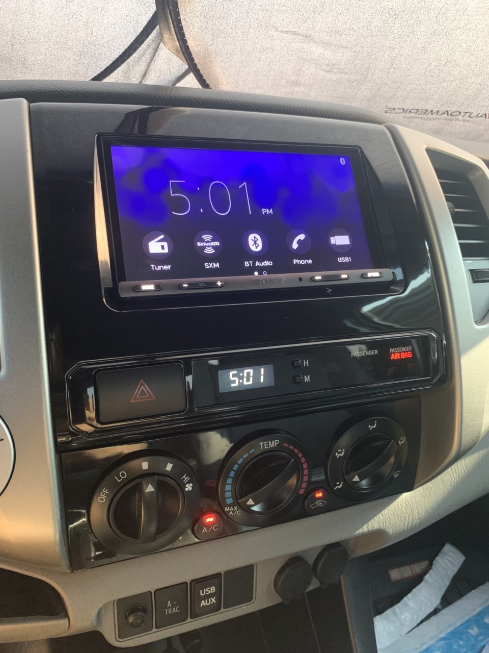

    AzTACOHH
    AzTACOHH Aztaco
    Jun 6, 2020
    #330594
    12
    Ernie
    2013 Tacoma TRD 4WD
    Bilstein 5100 leveled 4runner TRD Pro rims 265 70 17 Falken Wildpeak AT3’s
    I went with Scoche since they’re the only ones that do piano black, looks identical if not better than OEM
