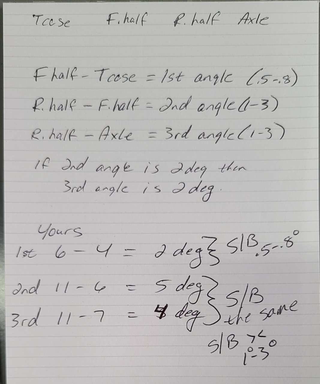

    Something easy to try would be to add some washers or spacers on top of the center support bearing mount. This will drop the middle of the driveshaft. I’d start with 1/2” spacer or stack of washers. I’m currently running a 3/4” spacer on top of mine. Drive it and see if it makes any difference.

    So your 1st, 2nd and 3rd working angles are 2deg, 5deg and 4deg?
    1st s/b 0.5deg.
    2nd and 3rd s/b equal and within 1-3 deg working angle.
    Way off unless I'm missing something? which happens
    A 2-3 deg wedge under your leaf pack would get you closer. I would go 3 deg with those numbers.

    These are correct. Well, like I stated, with the phone. I bought an a handy measurer a couple of weeks ago & darned if I can remember where I put it....
    When you put "2nd and 3rd s/b equal and within 1-3 deg working angle.", by working angle do you mean the 6 & 11 should be more like 6 & 8?

    I don't think the transfer case angle can be changed but idk. That being said I think you'll have to play with cb spacers to correct 1st angle.
    A 2 - 3 deg wedge should correct the rear angle being off by 2-3 deg.
    Ujoints only have working angles of 1-3 degrees. Your center and rear are working at 5 and 4 degrees.
