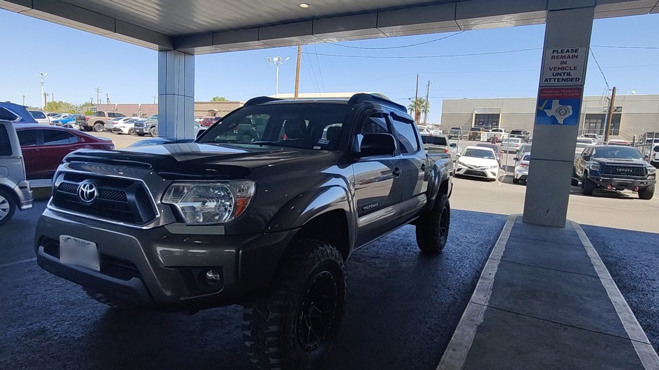

    Talk me out of the belief, I messed up buying this truck. l
    Having owned two previous 2nd gens, I wanted another go at it and got one at end of July.
    84A7EAF8-8E20-4957-B748-CE8F3D0FE07F.jpg 1A28371B-D45A-49F3-B15F-E9CFB6BFF200.jpg 7108DF93-5CBF-467A-A092-2CABEE1636ED.jpg 1DA5A3E6-DFF1-47FD-A8F4-85E787D0EA3D.jpg 177B63C2-CA75-4022-92E4-76AB51B80D16.jpg
    I love this truck, but the amount of things I’m already having to fix before doing mods of my own, makes me think I overpaid heftily and got taken.
    I don’t even know where to start with myself, because the research I undertook to replace my very high maintenance vehicle with something practical and dependable, was a very lengthy and intricate process, to ensure I’d keep it a long time and be content. I have a serious case of what I call “Goldilocks syndrome”.
    I’ve already spent quite a bit doing repairs since August, that either it’s just expected for an 8 year old pickup with 103k at acquisition or I’ve been duped big time compared to other “recent” 2nd gen buyers, who have bulletproof trucks.
    Wrote a longer post, but cut it down for it not to be too lengthy to start…

    Those photos don't shed much light -- other than that with the various cosmetic mods (roof racks, window rain shields, fancy wheels and bigger tires, etc.) it would immediately suggest to me it was owned by someone who was into "looking cool," and sometimes these sorts of people also want to "drive it hard" and not really keep up with maintenance...
    Everything depends on the maintenance history. Personally I wouldn't buy any used vehicle without a complete, written service history for me to review before purchase. I found a used, private-party sale first-owner 2014 Taco, with 61K miles on it, like this. It took me about a month and going through 15 or 20 different for-sale postings on Facebook Marketplace before I found it.
