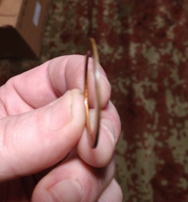

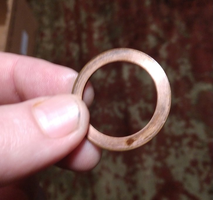

    Here's what it looks like, not sure if this helps.

    Copper washer. Put it back on there..
    You won't lose 10¢in fluid.
    Edit: Drain and refill. LOL

    Idk how fast y’all are at wrenching but damn. You really think you could pull the drain plug, put a washer on it, and reinstall without losing much oil? There’s only a quart and a half in there.
    OP, if you have a clean container you could drain it out into that and just pump it back in. Also if you’re going to go through the effort of putting the washer back on, may as well get a new one. 90430-24003

    That copper washer is the drain plug washer. Ok to reuse. Fill plug has a stainless steel crush washer that should be replaced.
    Yes you should drain the dif and install that drain plug washer.
