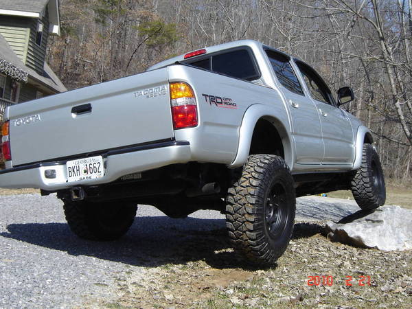

    Guys running these wheels, i was wondering how far the 16x8 enduro, running a 265/75/16 tire will stick outside the body? Not really wanting to have alot sticking out, but cant seem to find any wheels 16x7 that i like. any help is apppreciated.

    This is a 16x8 4.5 BS with a 265/75/16 ,that I ran on my truck a year or so ago..
    not a very good pic ,but better than nothing.

    That's high dependent on the backspacing.
    But assuming you get 4.5" BS in a 16x8, the wheels will stick out 2" more than the stock wheels, 1" due to width and 1" due to backspacing.
