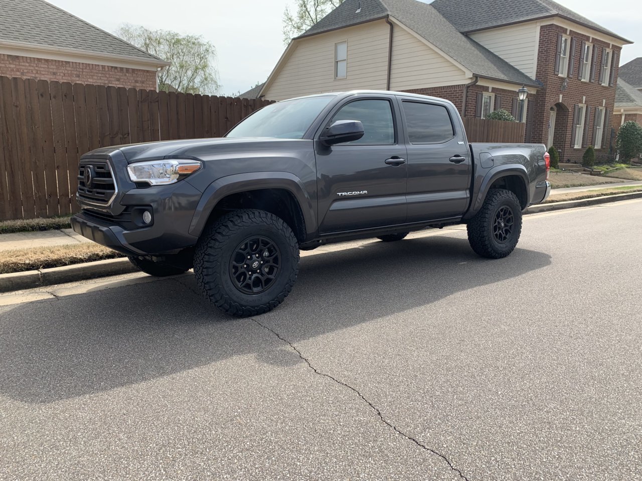

    I did the exact same thing when I first got my truck. I’ve since upgraded suspension but here is what it will look like with the exact setup you mentioned
    “265/75/16 KO2s and Bilstein 5100s setat position #3 (1.10") installed!”
