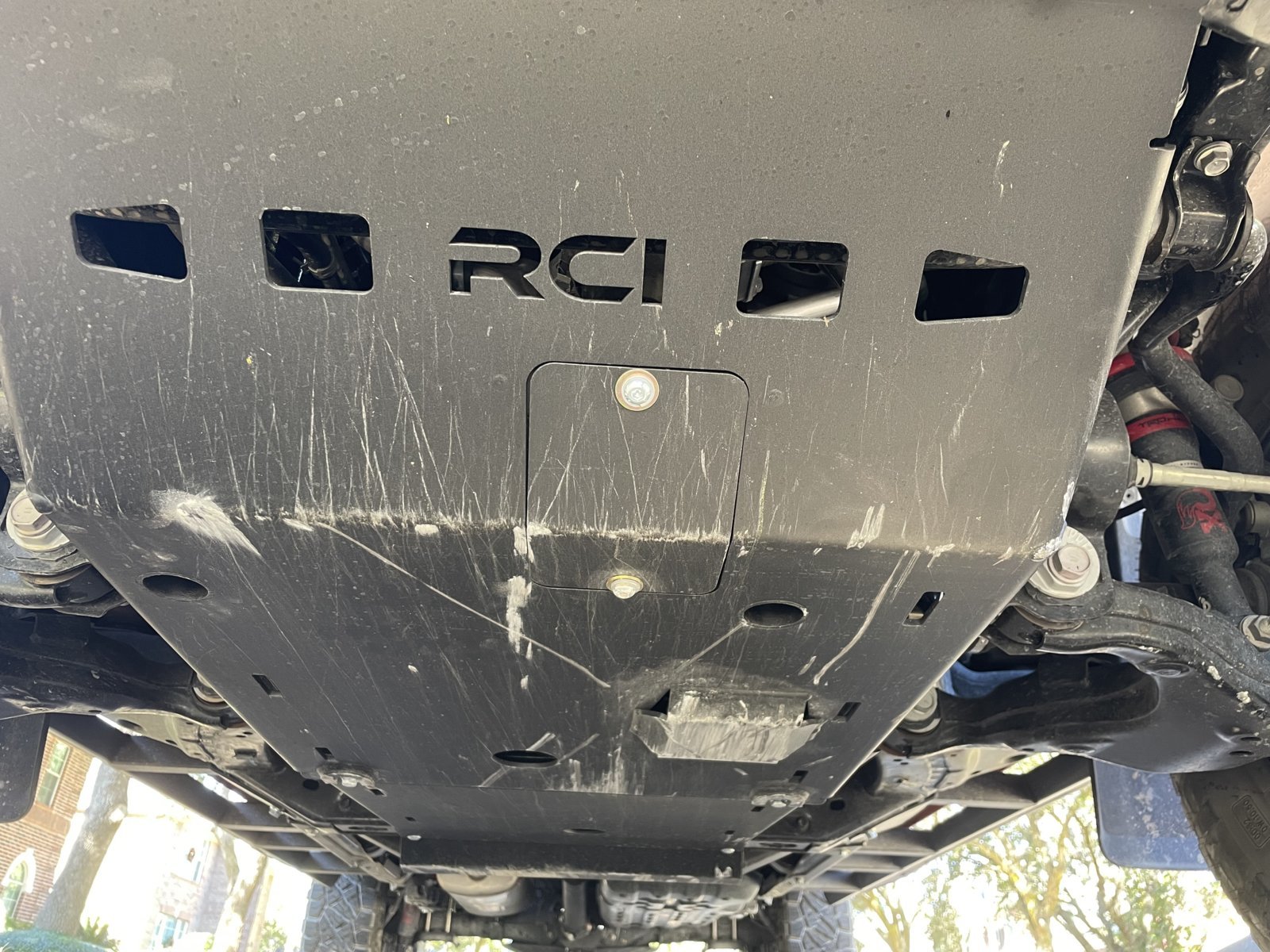

    2. I understand that the lift will not increase the ground clearance of the axles/diff. I am hoping that increased clearance will save my skids though! I also realize that more driving experience will save my skids too :) Pics attached. The increased height that the new springs provide will help decrease damage to my skid plates though, right?

    Replacing the coil spring in the front will be the best solution as it will provide lift and handle any extra weight. While retaining proper piston position.
    Front lift will barely get the skids any higher, control arm angle doesnt get it much higher. But it does a bit.

    Not entirely true. The only tire clearance gained is at ride height. Only true way to clearance is to cut
    Your skids are doing their job. Their purpose is to take damage
