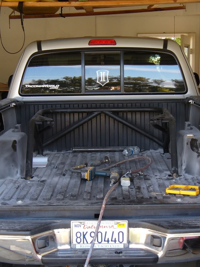

    Well I decided to bite the bullet and install a DMZ long travel bed cage. Only in my case this will be an extended mid travel rear end for the time being. Here is one picture of the cage half way through the build. I will post more in the build section soon. This is just my attempt to use photobucket and see if I know what I'm doing :D
    Oh and a big shout out in appreciation to Dellosa89 for helping out in a big way. Thanks bro!
    Hopefull this photobucket thing works for me.

    oh hell yeah dude. thats gonna be sick
    your going a very smart route. building the rear first and having mid travel up front is better than going the other way which is what most people do (including me)
    what shocks you gonna run? 16" stroke?
    once you get spring under on their you're gonna be able to mob it pretty hard.
    cant wait to see how it turns out

    Thanks! I've heard a lot of people say building the rear first is a good call, you included. After a few trips to Ocotillo I can see what you mean. The rear falls short every time but the front hangs in there solid. I'll be running 14"s for right now. I went FOA on account of money but I got the upgraded viton seals and billet end caps. Basically every upgraded part I could get. I think the setup will be solid. Can't wait to go spring under, but I know that with spring under comes new bed sides. One day....:)
