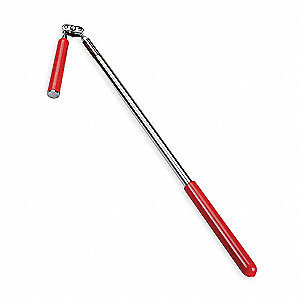

    I think he may have changed the design since I bought mine since I think that was a nut welded to a backing plate on mine. Either way, a magnetic pickup tool is invaluable I find for stuff like this but I think I just held it in place with a couple of fingers.
