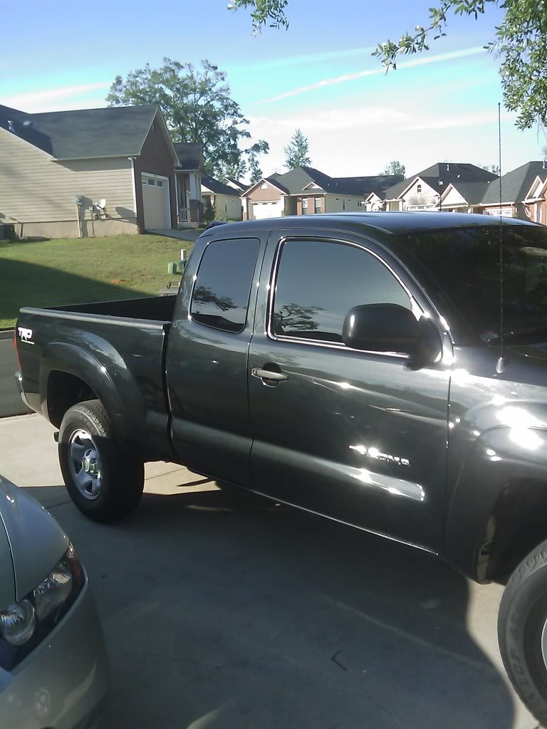

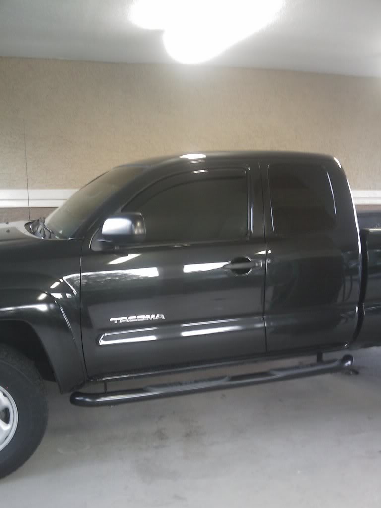

    Hey guys, i just ordered and installed these
    http://cgi.ebay.com/ebaymotors/NERF...ptZMotorsQ5fCarQ5fTruckQ5fPartsQ5fAccessories
    Question is, my co-worker said i need to screw them down with an impact wrench. All i did was hand tighten the mounts and the bars themselves with a socket wrench. Do i have anything to worry about?
    also notice the new window vents. what do ya'll think? I have before and after posted.IMAG0006_02665af87efbe3e7ab0439cae706708519eb9333.jpg

    Should be just fine. Go back and re-tighten in about a month just to be sure.

    If they come loose get some loctight.... I’m curios trd with steelies and the Dunlops???

    haha, yeah check my other posts. theres a loooooooooong story about that one. the previous owner put them on. i am taking them off on the next HOT and SUNNY day!

    :thumbsup: That, too. Loctight is a gift from the gods.

    I just ordered these for my black double cab last night off eBay $269 shipped. I've installed 4 sets of Nerf bars over the years and never had a problem with hand tightening and them coming loose.

    If they bolt to the factory locations ( threaded holes under the cab with plastic plugs in them ), I wouldn't over-tighten them.
    I have the Toyota steps and they only recommend tightening to 14 lb/ft.
    It doesn't sound like much, but it's a good "hand tight".
    I haven't had any loosening issues...6 months now. If I do, Locktite will be on the list.
