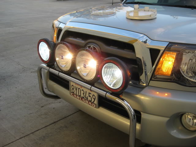

    Here are my off road lights... the most I could afford...
    2 Hella 4000 8" 100 watt Halogen Pencil Beams in the middle and 2 Kragen HID 7" 35 watt Euro (driving) Beams on the outsides:
