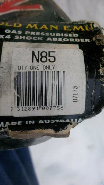

    He said they are N85.

    Looks like a fit:
    Scroll down till you see: OLD MAN EMU SUSPENSION SYSTEMS. You will see rear shock info...No lift listed.. So i would say good 2 go! The asterick noted, stiffer shock, still a nice upgrade....
    Confirm with Box-Rocket....

    I haven't bought yet. The seller sent me those pics.

    There is no problem of them sitting like that for 2 years, they will be perfectly fine. Yes they will bolt up, but like BoxRocket said they are made for lifted applications. On stock leaf springs they could bottom out and ruin the shock. It would be wise to get a new leaf pack or AAL for use with these.

    Incorrect, they are for use with Dakar rear leaf springs, which provide a lift. They are a longer rear shock because they are designed to be used in conjunction with lift springs.
