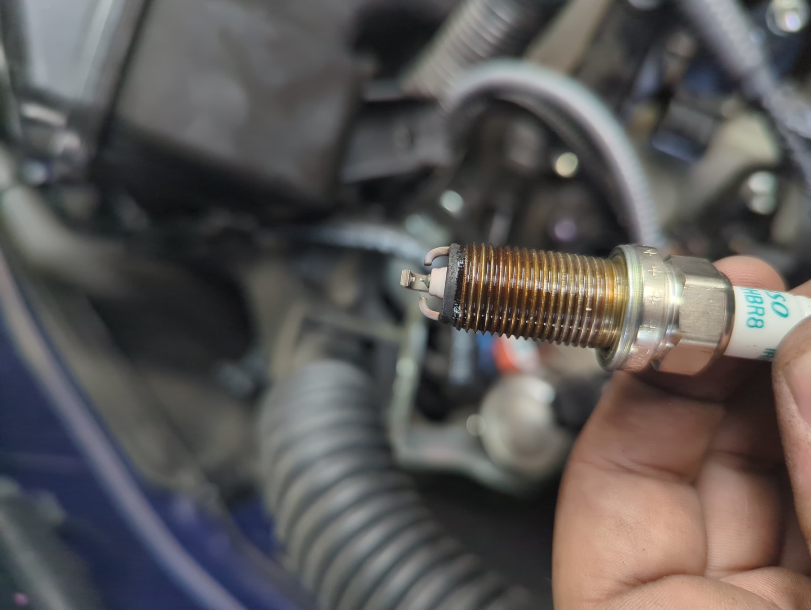

    I am having the exact same issue as op to a tee. I am pulling my plugs to check. Below is bank 2 closest to cab spark plug. It is oily and came out a little hard shedding some metal where the threads were. The middle plug was barely hand tight when loosening. Am going to check the rest when it quits raining.
    I had worse jerking and some slipping which was solved by adding 1.5qts of atf.

    Because you said this and hearing about loose spark plugs, I just checked all 6 of them. 5 of them felt too loose for my liking and one came out hard leaving small metal shavings behind. I am at 10,000 miles. I backed them all off and tightened them to my liking.
    After reading about low ATF and having 3rd gear slip twice, I had to check it for self assurance. I thought mine would be fine but checked it anyway in my driveway. It ate one quart, and spit out half a quart after adding another. It then shifted sooner, it was less jerky from a stop, and it coasted better after adding just one quart.
    Checking and topping off the ATF eliminated most of the low speed jerking I had. You have a 23 like me. Tightening my plugs also looks like it may have solved my 6th gear jittering problem as well, too soon to tell. But man they felt loose.

    Based on what you said, from experience, check your ATF level and see if that solves it. Otherwise your tune might be too sensitive. But I went through the same rodeo to discover it was the ATF and not the tune.
    They are coming low from the factory. The stock tune masked it completely. After tuning, the bucking/jerking appeared. Back to stock, it drove normally. It is very similar to this thread. Then after deciding to rule out low ATF after just reading about it, lo and behold it was the cause. After the fill and check no more bucking/jerking. So it may be that rather than what sensitivity you have although you may want to go down in sensitivity anyways. I'd check that first just to be sure. Hopefully that solves your problem.
