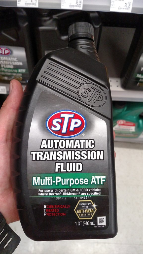

    Can I use this to top off the power steering, it says it is suitable for use where dexron 2 and 3 are specified

    Trying to decide between these 2 ATF’s for a steering flush!
    Thoughts??
    Mobil1 Synthetic ATF Dexron/Mercon
    or
    Valvoline MaxLifeMulti-Vehicle Automatic Transmission Fluid

    I have been using Valvoline MaxLife synthetic ATF in my power steering with no issues. It's dirt cheap at WalMart and its really good stuff. I use it in the tranny as well.

    ATF.
    I also used valvoline atf.

    Every oil change I syphon out the reservoir and fill with Amsoil Universal red cap atf or Maxlife atf.

    ATF (like Dexron) is hydraulic fluid with friction modifiers for the clutches and the red dye added. PS fluid is hydraulic fluid. The PS system doesn't need friction modifiers in ATF, hydraulic fluid is fine. Dexron has been used/specified for 50+ years in PS systems because it is commonly available, but typical PS fluids will state something like "for use in all vehicles..."

    This is how I do mine in all of my vehicles. All use the same fluid (even the bmw). I have a lot of the dex 3 from malwart and it's cheap and just fine.
