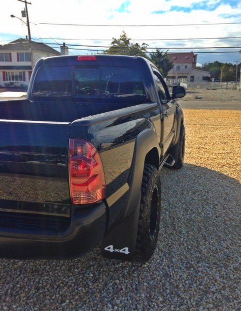

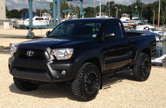

    Hey guys... i just ordered a set of the Pro Comp 7031 wheels. They're 17x9 with 4.75 BS and -6mm offset.. ordered them from 4wdParts.com... i punched in my vehicle and they said they would fit, but the backspacing seems a bit much... wanted to know if they would fit, or have any rubbing issues
    The truck is a 2013 Regular cab (no lift), and the tires are 265/70/17 Cooper Discoverer STT
    thanks for any info guys..

    They fit! Great looking truck.

    thanks guys.. ! just wanting to get the info to others, should they want to do a search..
    stock height, aggressive 265/70/17's... they rub a TINY bit on the front mudflap, but not even enough that im going to trim them.. overall i am quite pleased!

    Hey sixtydashone, nice set up
    man this helps out a lot. been researching for days regarding the pro comp 7089 17x8 with 4.5bs and 0 offset and the 17x9 with 4.75 bs and -6 offset
    im currently running the mb tko wheels 17x8.5 with -6 offset with my stock 265/65/17 bf rugged terrain and its only about maybe half an inch out of the fenders.
    my concern was that the 17x9 pro comp with -6 offset might stick out too far from the fender. about how far does your wheel stick out from the fenders?
