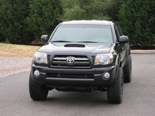

    se7en, are those 8" wheels in your pics? i currently have 16x10 mt with 285/75s on them and the stick out too far. i was about to purchase some 16x8 and put 265/75s on them. will they still stick out as far as in your pics? oh, the new wheels are 4.5 bs and 0 os.
  5. Feb 12, 2010 at 4:37 AM
    se7en
    se7en Go Vols!
    Jul 28, 2009
    #20286
    279
    East TN
    16 Limited 4x4
    I'm running 18x9's with a 4.5" bs. Mine stick out exactly 2.25" past the fender. The 8" ones your wanting will stick out less...maybe not the 1" less that the wheel width indicates, though. This is because the tire is a 285. 285 tires are 11.25" wide (slightly varying from manufacturer to manufacturer) and this won't change. So even though, you're on a 1" narrower wheel, the tire will still be somewhere in the 11" wide range. If I were a betting man, I would bet that your 285's on an 8" wide rim with a 4.5" bs, will stick out anywhere from 1.5" to 1.75" past the fender when all is said and done. When/if you go this route, please post back up so we'll all know.

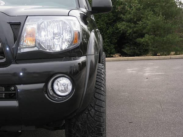

    i just measured the mt 16x10's with the 285's and they stick out about 2.5". FYI, i was planning on getting Helo 791(i think that was the #) 16x8, 4.5 bs, and 0 os. and i was going to put Dayton timberline at 265/75/16s on them. how far do you think they will stick out. i dont mind a little, but tired of the mud throwing im getting now.

    Let's go back to stock wheels for a second. Stockies are a 5.5" bs wheel. Your 4.5" will push that out an extra 1". The stock width is 7.5" vs your new ones at 8". That's another .5". The 265 tire width is the stock width. So, I'm guessing (and that's all we can do) is that you will stick out about 1 - 1.25" past the fender.

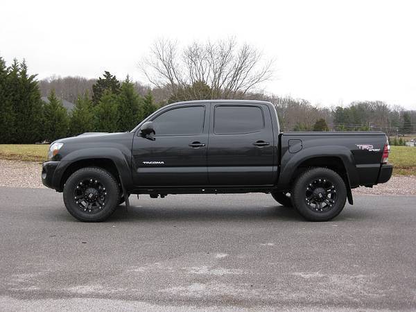

    se7en, i forgot to mention that i had to go with 4.5bs and 0 0s because other wheels would not fit over my brake calipers. did you run into this? also do you have side pics of your 18s

    Nope. I have 18's. PLENTY of room.
    Only one I have...
