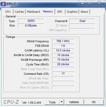

    Hello All,
    Can you please Tell me if this looks right? I'm running Crucial Balistix sport Ram. 2x 4gig dims. @ 1600mhz. Here is a screen shot of the results when I ran CPUZ.
    it Says its only 798.1 MHz. Does that look right? or is there something that I need to correct in my Bios? Please advise?

    So I went into my Bios and it looked like everything was registering as 1600Mhz. so I looked through the rest of the settings and found that XMP was Disabled. So I enabled it rebooted and its still only registering at 798.1Mhz. Frustrated.

    Yeah, it's right. 798.1 x 2 = 1596.2 (1600)

    OP, because it's ddr (Double Data Rate), the 1600Mhz is calculated by multiplying the 800 by 2. So it checks out

    As Bob and Robnik said, it IS running at 1600. DDR (double data rate) of 800 is 1600.
    What I would check however is the timings. Make sure it is running at the timings and voltage advertised on the sticks or packaging. Sometimes the BIOS doesn't pick them up correctly and runs it with safe (slower) timings. Yours appears to be running at 10-10-10-28, just make sure that's right. If so, you're all set.

    Yes the labels on the ram do show 10 10 10 28

    If the voltage is right, then you are all set.
    A quick look at this Crucial product sheet doesn't show any 10 10 10 28 DDR3 kits.. maybe you have a different model # than shown.. I was looking for voltage info.
