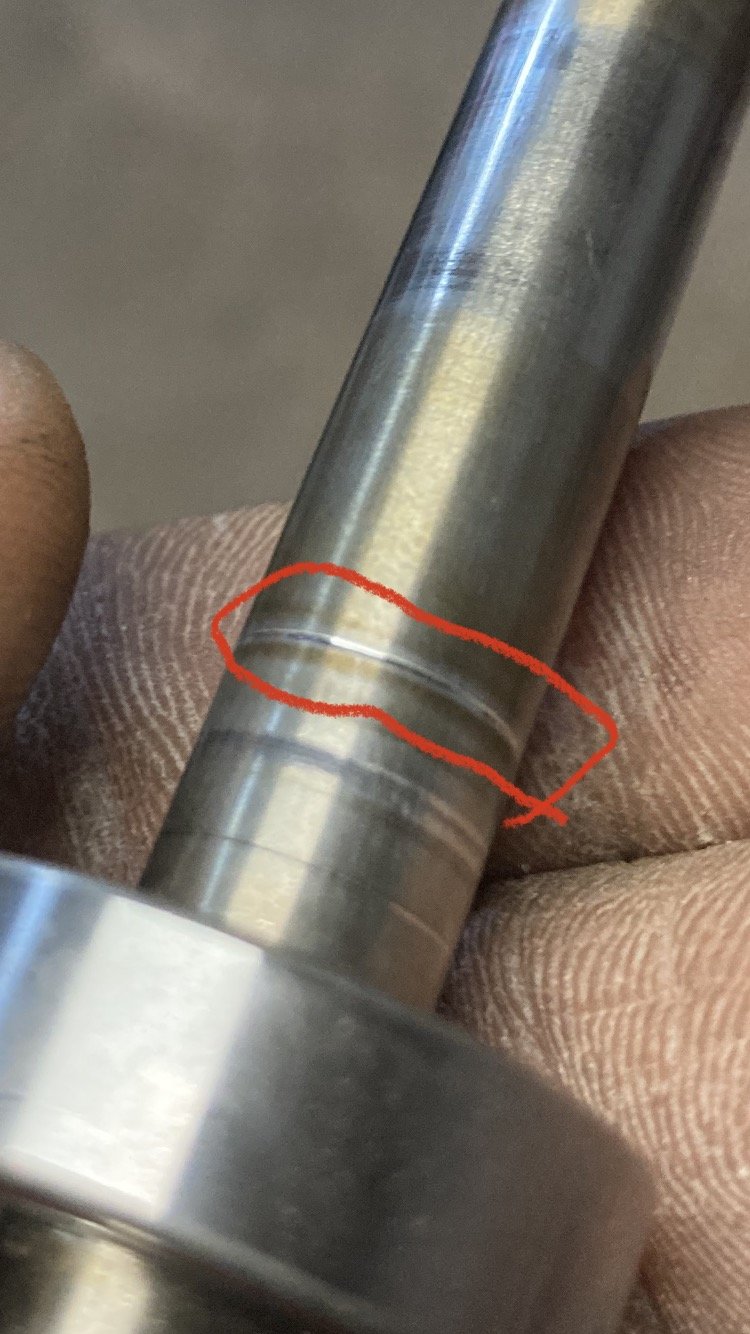

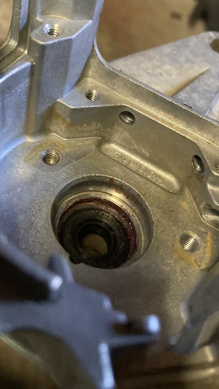

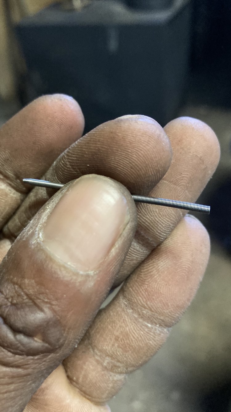

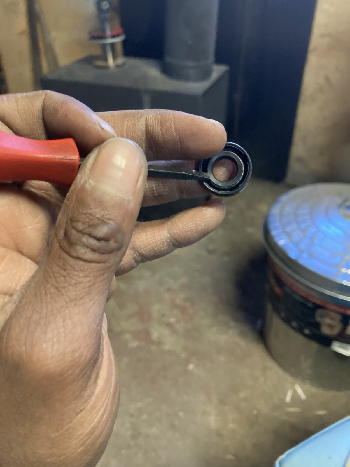

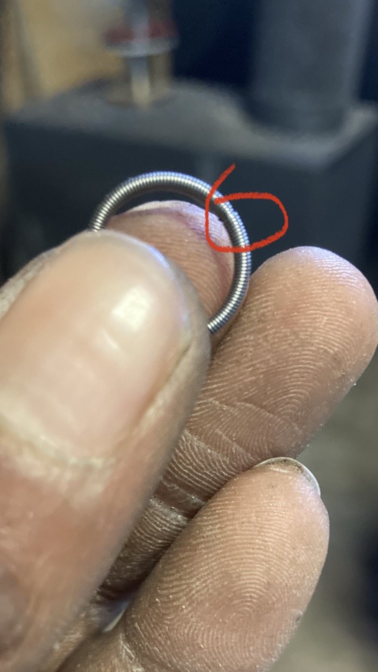

    So I happen to be rebuilding a distributer for a 92 Camry I got for fun. The distributer shaft had a slight groove. Typically I would just drive the seal to a different depth to avoid the groove but I figured this was the perfect candidate to demonstrate my plan c.
    When you remove the spring from the seal and look closely you see a small section that narrows. Thats the section that can be separated to transform the spring into a straight spring. You would snip a few coils from the wide end then curl the spring back to itself and connect the ends again by pushing them together until you feel or hear then interlock and the spring stays together. I then reinstall it with my trusty pocket screwdriver to it's home. I apply a little anaerobic sealant to the OD of the seal. It wasn't needed in this situation but it doesn't hurt. The sealant between the seal and wall will cure but the excess that is exposed will not and was wiped away by me before continuing reassembly. RTV on the other hand you shouldn't really wipe away as it can pull the RTV out of the area it needs to seal in the process as it tends to stick to itself more than anaerobic sealant. Any on the other side of the seal will remain fluid and be washed away by the oil once the engine is running. I believe they say it seals gaps up to 0.015". Not much but a little. It doesn't really harden for say, it tends to stay kind of gel like but will get firmer.
    I sealed up my ranger manual transmission with it once but the surfaces have to be clean clean. Brake clean is not sufficient. For that purpose I used aerosol AcDelco glass cleaner on both case surfaces before sealant application and assembly. For oil seals though I just clean the seal bore with brake clean then install. I don't clean the OD of the seal. Not sure why the case halves weren't happy with just brake clean like RTV is but that's been my experience. My reason for anaerobic over rtv on the transmission is that the thickness of the rtv can space out the case halves too much and add end play it isn't supposed to have. Some transfer cases require anaerobic over rtv for the same reason when sealing both halves of the case together.
    If you want extra security when you install your seal then I would use it.
    I got my tube of anaerobic sealant back in 2016 and it still works but is almost done. It's nothing special, just the permatex stuff from Canadian tire that was 6$ a tube back then. Somewhere like Pep Boys, O'Reilly's or Napa should have it on the shelf near the other sealants. I also attached a photo of the one that I got.
    The spedi-sleeve is brilliant and if it was an option, my distributer shaft would of been an excellent candidate for the repair sleeve but just sourcing the seal alone took over a month and required me to purchase 6. So between having 5 spares now and not wanting to try to get one made as the shaft has a slight taper of a few thou over it's length, I'm going to put it back into service as is. Worse case I have plenty of room to drive the seal to various depths to avoid the groove if that becomes an issue. 0EBD526E-B0E2-47B8-8F42-E341C885B552.jpg 91828D66-3D75-4897-B426-87C399800149.png BBC2B3A9-2C5E-43B7-BA8E-2922FFC53990.jpg 32F566F4-B5D6-4318-AD8E-B1324D03FB17.jpg 51906C18-FDB0-4E5D-A3C9-8F9744C1F8E8.jpg 5A5C3A73-FDE3-4938-BB8D-70AF54BB9AC1.jpg 4291AA96-D651-4ABD-90D9-4D8605BE0D91.png B52AE08B-8971-44A6-A993-499C7B40B2FB.jpgEB088747-E239-4E8A-AC02-AB6B84DBBC81.png

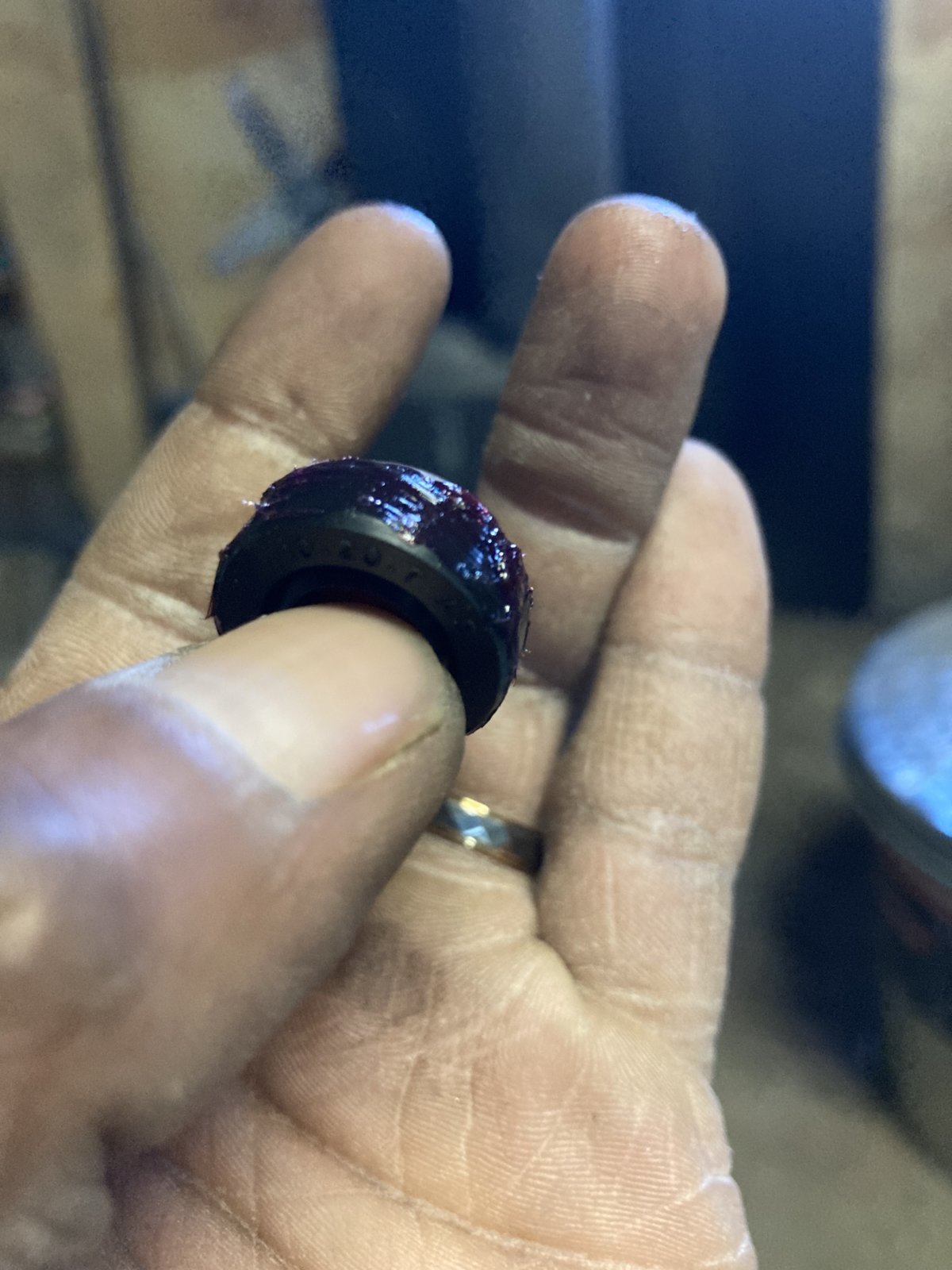

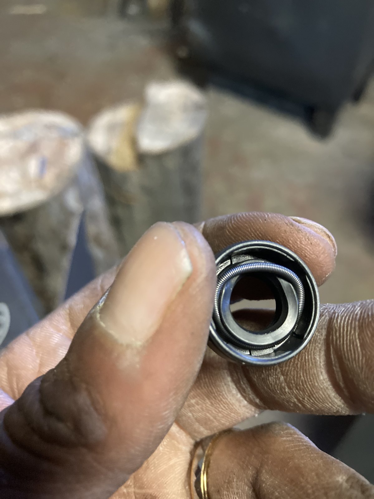

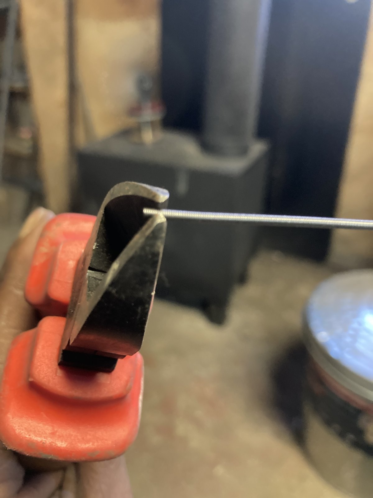

    So after re-reading everything, I suspect we were thinking of two different PTFE seals. I feel you were referencing a PTFE seal which resembles the crankshaft seal that you have like my first picture. I was referring to a PTFE seal like the white "o-ring" on the injector and pipe fitting. For the crankshaft "style" (I forgot the proper term for a seal like that) seal I do nothing different to be honest with you. The white o-ring type seal is the one that I warm in my mouth before install. The oil ring type seal has to slip over the cone into position as trying to manually install it without such a tool will almost ensure it gets damaged and leaks or just breaks. They aren't very elastic. After installation you would use a tool like the one I have circled in the third picture which fits over the (in that case injector) shaft and the seal and you let it sit for a few seconds to "size" the seal back down to it's proper shape. Warming the seal there helps increase it's elasticity for install and how easy it contracts for sizing afterwards. Larger PTFE seals used in automatics I don't fit into my mouth due to size

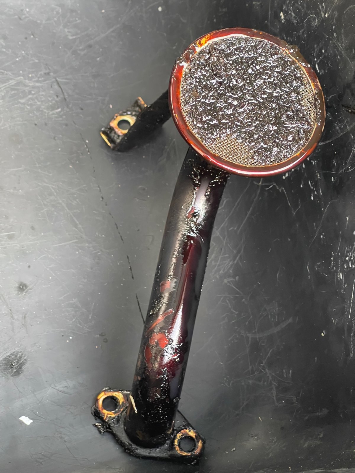

    If there was a coolant leak to the oil, I am thinking that would make the oil form a kind of whitish foamed pudding effect since oil doesn't easily mix with water. I need to show you some (9) photos so you can see the way it was sludged, all the places I have been hand desludging.

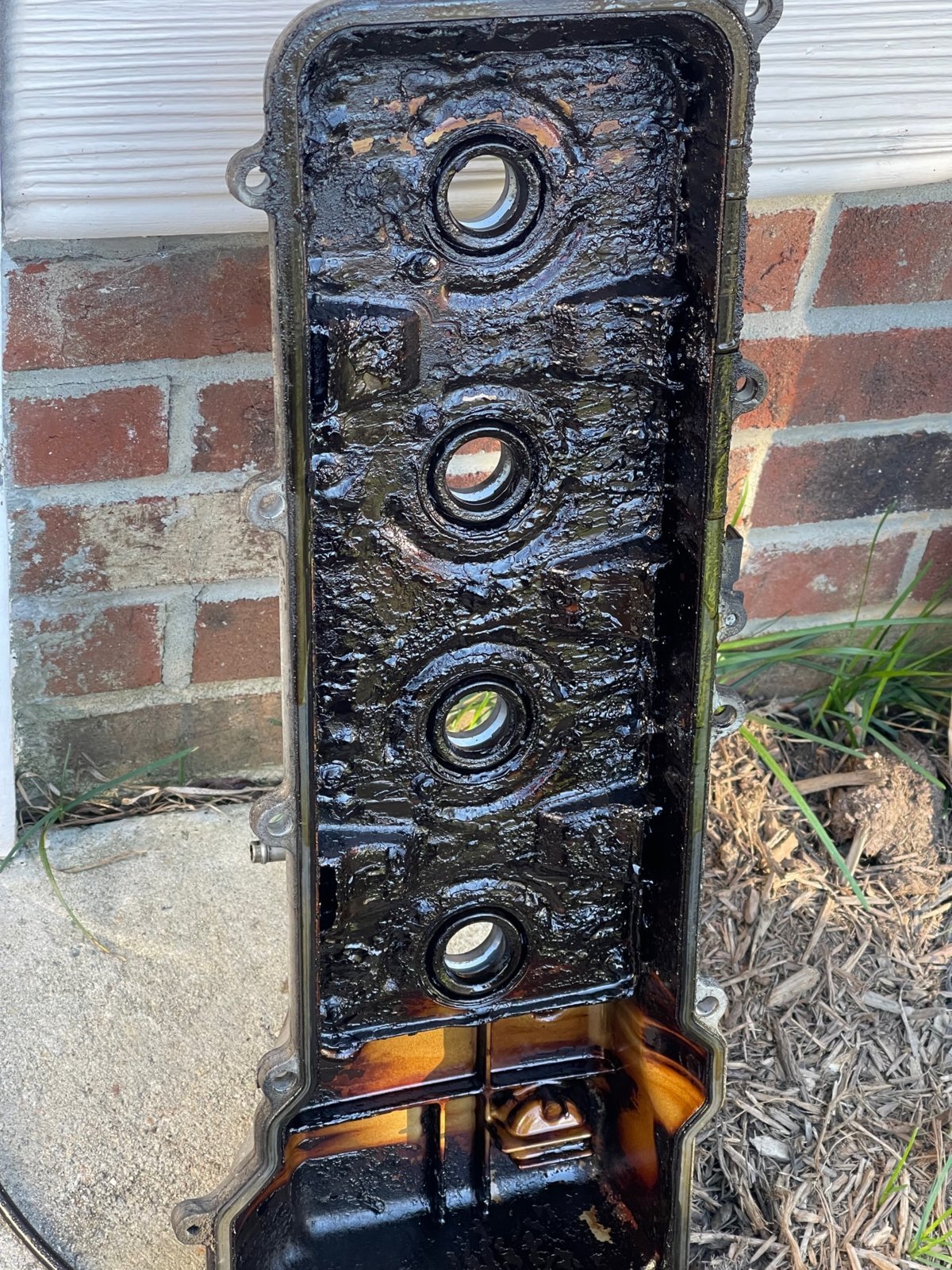

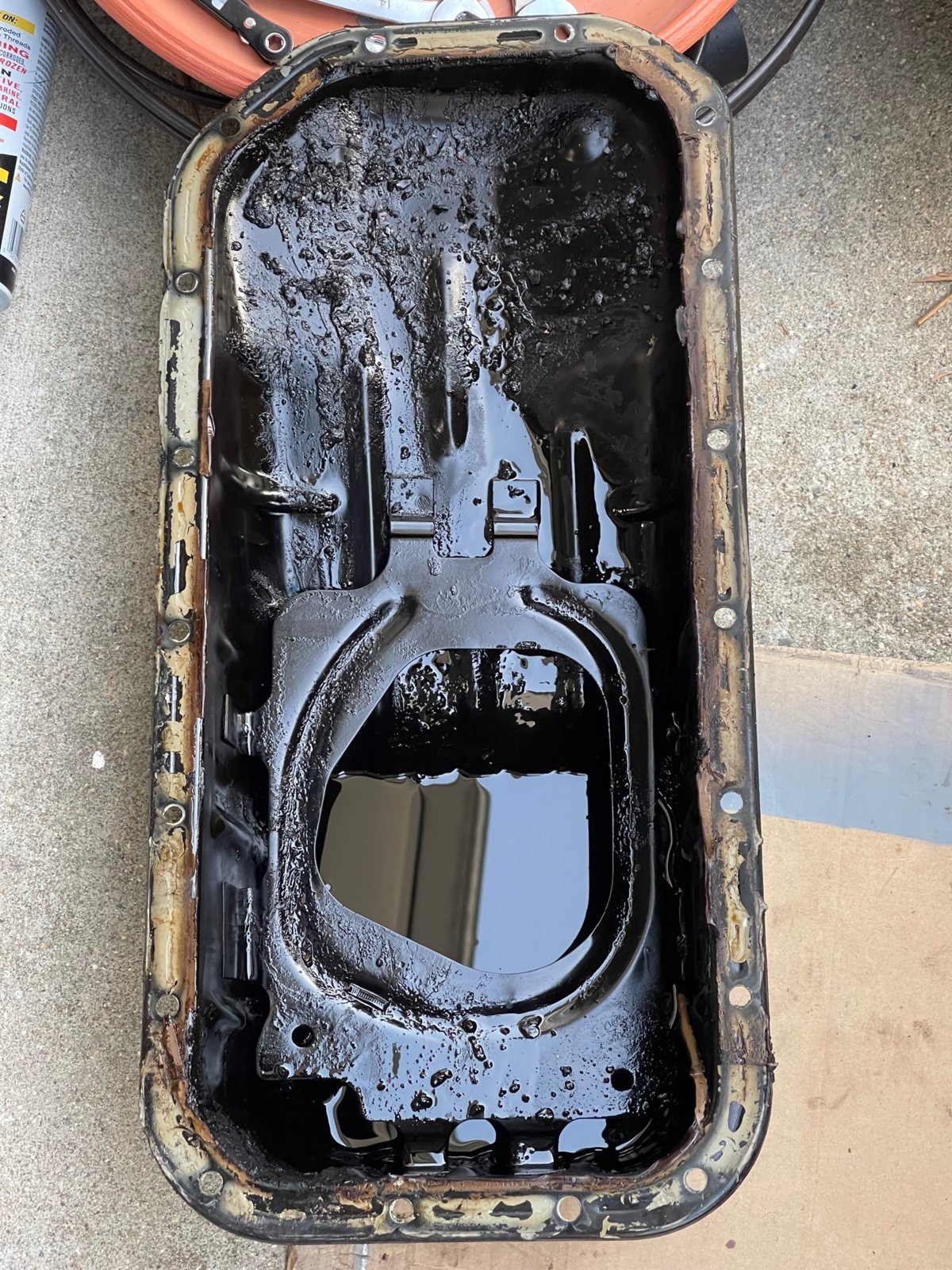

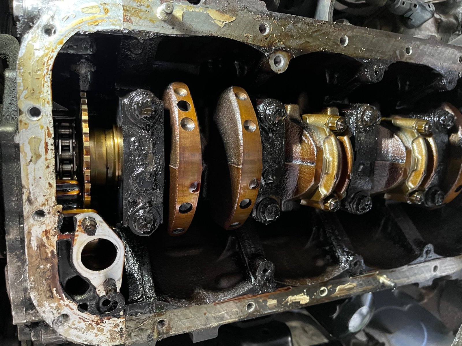

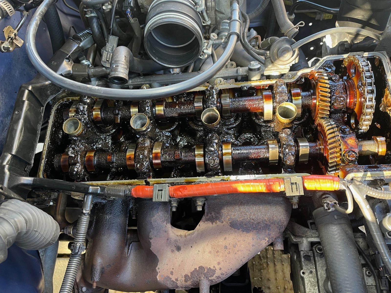

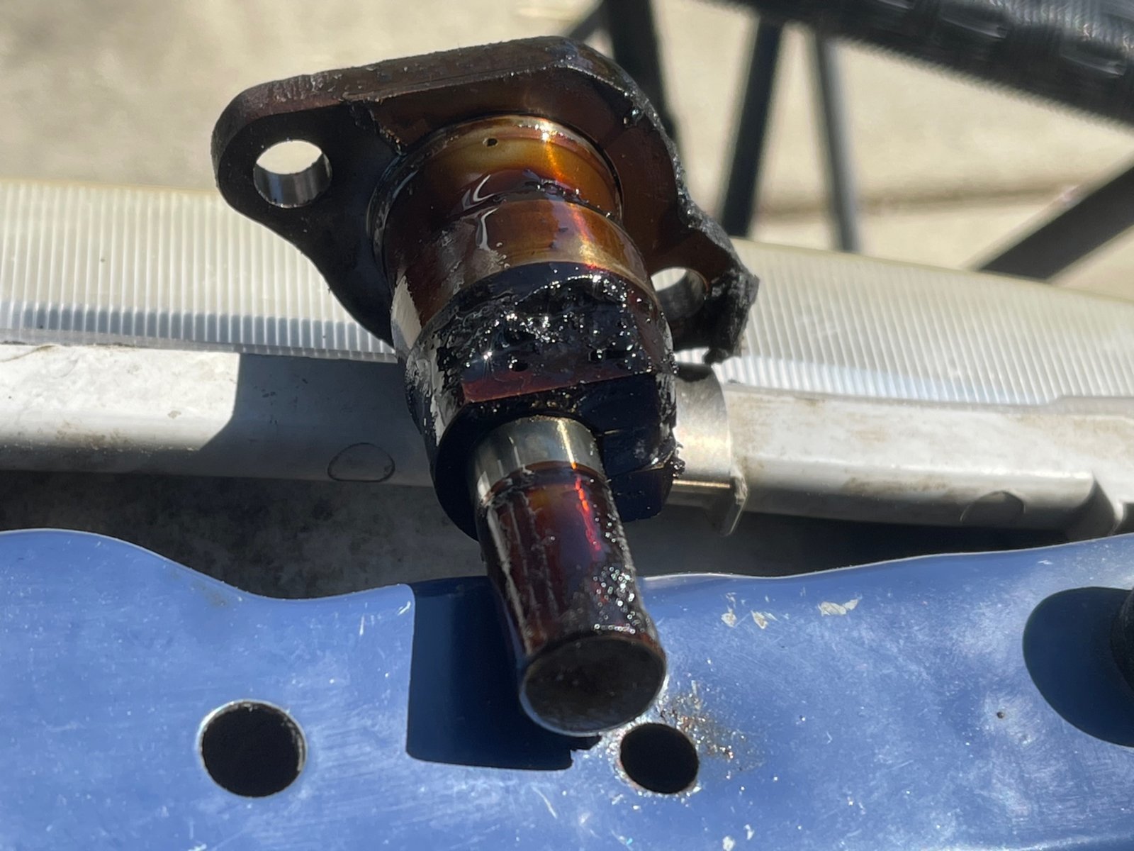

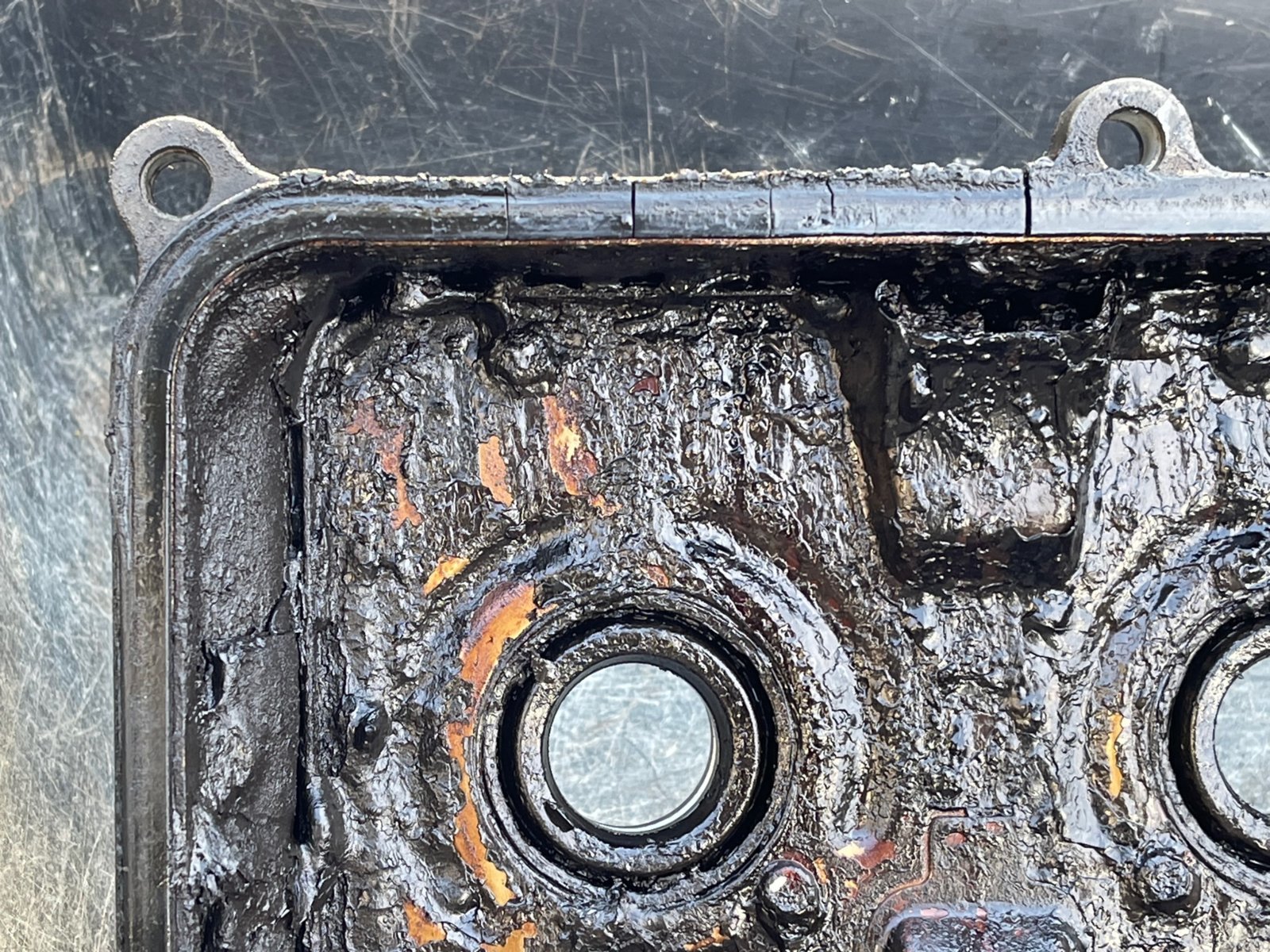

    IMG_7204.jpg IMG_7207.jpg IMG_7203.jpg IMG_7404.jpg IMG_8178.jpg IMG_8181.jpg IMG_8182.jpg IMG_8183.jpg IMG_9130.jpg
    Sorry for the many photos, but I was trying to show the sludge, so you can understand how it looked, and where I have hand cleaned the engine, top, front, bottom, and now am replacing the rear main seal, before installing a new clutch kit and then rebuilding the areas I have cleaned, after cleaning more of the parts.
    I do not think that sludge was caused by water, or condensation. What do you think? I would have expected it to have a different color and texture.
    I don't know this to be true, but in the back of my mind I worry that there may be some other possibility for the creation of oil sludge that has to do with the engine not functioning properly, in some manner that is beyond me to even imagine. For example, I have not removed the cylinder head, or the intake manifold, but there is a picture in my mind of carbon plugging up the input ports or the intake manifold, or something being wrong with the valves that I cannot see with the cheap inspection camera that I own. When i cannot actually see something, there remains this suspicion in my mind that I am overlooking something fundamental that could have caused the oil to form sludge. Maybe it's because of my laziness that I will do all this work, put it back together, only to have it happen all over again because I didn't fix what was actually messed up while I had the engine largely torn apart. Or am I being silly?
    Also, I remind you that when I measured the chain, it was out of specifications, meaning it was longer than when first installed, and I think that effects the timing somehow, and I wonder what that poor timing would do to the engine, over a long period of time. With your background, you are much better suited to figuring these kinds of things out than I am.

    Holy, thats actually alot more sludge than I was imagining. Only time I saw that much sludge was when a lady came in with 62'573Kms for her first oil change. I believe the Dexos oil spec at that time was only semi-synthetic too. It was a 2015 Chev Trax with a 1.4 ecotec engine.

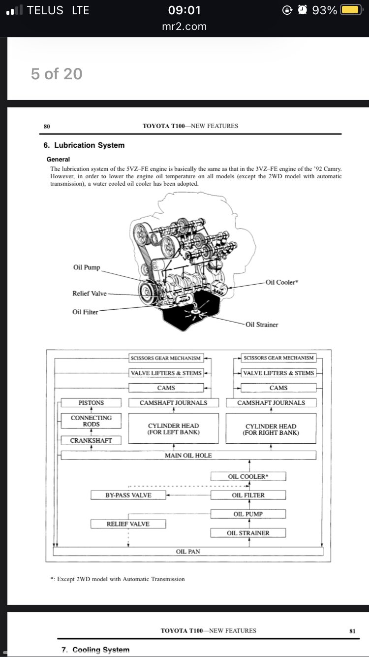

    Before my response I stumbled across an article on Bob is the Oil guy that doesn't specifically pertain to sludge but the relationship between fuel in the lubricant and relates to sludge in the crankcase. https://www.mdpi.com/2075-4442/9/9/92
    In regards to the sludge in your engine specifically, yes moisture will have a tendency to form more of a whiteish/creamy sludge but when the engine gets up to temperature that moisture/sludge tends to evaporate leaving behind the more difficult to evaporate materials. The varnish though suggests to me the sludge formation is related to the degradation of the oil due to either lack of previous maintenance, excessive blow by from worn rings possibly, or with the mention of your engine sounding "laboured" under load possibly either a partially stuck egr and/or a partially clogged exhaust causing too much exhaust back pressure. I have to refer to a service manual or school books because I don't recall the exhaust back pressure spec... I think 0.25 PSI at idle and 1.25 PSI at 2500 RPM on a gas engine sounds familiar but don't take my word for that. I've never measured exhaust back pressure outside of school. I used to either just feel/check the exhaust temp with an infrared thermometer near the cats (or any other spot I suspected to be plugged)for a significant temperature differential. The outlet(closer to the muffler) should be hotter than the inlet(closer to the engine) when the cat is warmed up and functioning properly. I think around 50*F was the magic number. A reading like 300-400*F hotter on the outlet though suggests that something abnormal is combusting in there. Excess fuel, oil, etc. If It happens to be a plugged cat. Even if that's not found though it's still wise to investigate for possible sources of cat corruption from combusting abnormal substances. Especially if the replacement is due to a cat efficiency code. Coolant, silicone, lead(not really a problem unless you're finding leaded gasoline to purchase somewhere still), oil or excess fuel can ruin the cat. They do eventually wear out with age but atleast a quick check for no other cause of the failure is good practise. I would strongly suggest against aftermarket here as they tend to fall under efficiency standards early leading to a check engine light of P0420 for such. Sometimes I would just use a vacuum gauge or look at the map sensor (if applicable) with a live data capable scan tool but working at the dealership on the same vehicles I could get a baseline easily to know if a vehicle had low vacuum or sometimes driving with the vacuum gauge connected and going up a long hill at a steady speed you could see the vacuum start to decay as you maintained speed up the hill.
    To check the egr, if it's vacuum operated I just apply vacuum with a handheld pump while the engine is idling and look for a linear response to it's running state as the egr valve opens due to the vacuum you're applying. If it's an electronically actuated valve then I only really know how to easily check them with a scan tool that can command it on in increments while you observe the change in it's running condition. You may be able to progressively activate it with a variable resistance circuit but they normally operate in a pulse width modulated(PWM)fashion that would require a PWN signal generator to operate properly in the absence of a scantool.
    As long as your pcv valve is working properly, you have no mechanical engine faults, compression is reasonable and not too low or excessively high then I would proceed as planned. Deposits in the intake are usually caused by either pcv issues or oil with a high NOACK valve or in other words, oil that evaporates too readily. Cleaning your intake doesn't hurt but I don't consider a dirty intake to ever be a problem on it's own but a unreliable symptom of another issue. Intake condition is yes influenced by engine health but poor quality fuel, driving patterns, oil quality can all drastically change the condition of it and possibly provide a red herring during diag. Some carbon from non-VVT achieved egr systems is normal, some oil in the intake from a properly functioning pcv system is normal. A change in either engine health, fuel quality or oil quality alone can net a big difference in the condition of the intake in a very short time frame. Cleaning it is helpful but I wouldn't go out of my way to clean it unless it were already removed. Maybe an oil analysis could be of benefit here? I wouldn't do it the first oil change after this though as it could give falsely high readings of somethings like silicone from the rtv used in places.
    In regards to the oil specifically, unless your engine has a special oil spec beyond the basic SAE, API, ILSAC, or ACEA specs (which I doubt) which are usually all labeled on basically every commercial oil such as
    SAE: 5w-40
    API: SN/CK-4
    ILSAC: GF-5
    ACEA: A3/B4
    I would say in current times there is no oil that would be inadequate for your engine or have too much NOACK. oil back when the truck was new is another topic.
    When a timing chain is worn to the point of causing issues, (specifically with an overhead cam engine) you'll hear the chain slapping inside the timing cover constantly. Momentary chain noise on startup that goes away I would say is more so a chain tensioner or on new engines possibly a VVT gear issue. (For all timing chain engines) the other usual telltale sign is that under light load such as idling or steady speed cruising, the engine will run like garbage and buck, jerk, misfire etc but when you punch it everything will appear kosher as the load from punching it will take up all the slack in the chain. A check engine light related to engine timing is also possible. Even though your chain was worn beyond the limit I don't feel any issues would of been caused with your engine because the chain tensioner I imagine still had the travel to keep the chain tight. You may notice the engine runs a bit healthy with more power and efficiency but I would 't say any damage occurred for say. If the computer could no longer compensate for the chain wear, it would of threw a code for something like timing itself, fuel trims, camshaft-crankshaft correlation error, etc. Measuring your chain and finding it out of spec since you were in the area makes sense. Timing chains aren't actually lifetime parts but I also don't do anything with them unless an engine code points to an issue or a driving concern is present. Typically if I can still see the paint marks sharply that are used for installing it, then I consider the chain okay. If they're dull and otherwise not highly visible like they are when new then I replace the timing components. For the vehicles that have timing chain issues **cough** BMW, GM** cough** yes design plays a role but largely what causes the chain to "stretch" is elongation of the holes the link pins go through due primarily to particles in the engine oil that are too small to be filtered out. Toyota OEM/factory timing chains are fantastic and especially with the fact that oil standards specifically incorporate timing chain wear tests nowadays you'll probably never have another timing chain wear out again. For a long long time.
    I do consider the metal plate in your oil pan surrounding the pickup tube to be a windage tray of sorts. What you found is correct and ya it basically just reduces the oil's ability to slosh around as you drive around which in turn helps keep the pickup tube submerged in oil and helps keep the oil from becoming aerated. There is no downside to a crank scraper and the benefits you've found are correct. Don't quote me hear either but I believe the physics term used in school to describe the oil mist and gasses being drawn to the crankshaft was referred to in our literature as the "tea leaf effect" named after the tendency of a tea leaf to find itself towards the middle or the cup when you stir a cup of tea. You may not notice much from a crank scraper though because the difference will be small. If price wasn't obscene and I had the option while in the area I would add one, honestly my reason would be to squeeze a little more fuel economy out of the engine but it would be a low priority mod for me unless I was building a race engine as I don't think the fuel economy or power benefit would be significant or noticeable enough the justify the cost. Mind you i've never looked at the cost of adding one to an engine except when I changed the oil pan on my ranger... at that time though it appeared no one made one for my engine. The crankcase gas does come from blow by. The pcv should pull a slight vacuum on the crankcase when working properly. The vacuum in the crankcase helps the seals last longer and increases performance of the engine. There is a special tool that goes in the dipstick hole to measure it but i've never used it or seen one in my life. Even though it was mentioned in the service manual for diagnosing pcv issues as a gm special service tool (SST) my dealership didn't have one and none of us saw a use for it so no one tried to get their hands on one.
    Hey, every technician worth his salt shouldn't just be able to fix the issue but should also look for the why it happened. If you don't you could end up in the same boat again soon.
    A stuck on fan clutch will consistently have the roar to it that is characteristic of a cold start when you hear that initial fan howl that settles down after a few seconds or a minute if it's really cold out. If you have the truck running and raise the idle to 1500-2000rpm you should hear the fan disengage and the engine get quieter after a second to a few at that fan idle. If you decide to replace it anyways, I also recommend either OEM or OEM supplier. No matter what though, don't ever get the heavy duty option (if there is one) I don't know what they expect but those heavy duty ones always seem to stay engaged at full tilt boegy no matter what. You will 100% feel the parasitic draw of that fan clutch.
    To prime the engine I usually just leave the spark plugs out (depending on how hard they are to access) and crank the engine with my foot to the floor on the gas pedal or otherwise disabling the fuel system until the oil pressure light goes out or I see pressure on the gauge (if applicable). Don't crank for more than like 10 seconds though or you could overheat the starter.
    For cleaning of the innards that final step, I would indeed use some of the High Performance Lubricants engine cleaner or even the oil if you feel like it. I want to try some of their products but with shipping to Canada the cost is insane. Otherwise a flush is also an option. I'm not deathly against flushes, I'm gonna try one in my Camry(once It running) but the engine is decently clean given the car is 32 years old. I just feel that a cleaning over a longer duration than 15 mins would work better. It did take more than 15 mins to form the mess inside the engine so I imagine it should take more than 15 mins to clean.
    I couldn't find a link to your engine specifically to a "New features" document someone would of posted but I found one for the 3.4 V6 that was optioned for your truck. Different engine but the oiling system will be the same and in general all engines are. Exceptions are engines with VVT and turbos which have the VVT circuit added to the camshaft lube section and the Turbo usually having a separate and direct feed circuit from the oil filter. Parts just might be in a different location or have a different shape to them F5649FD1-D73F-4BCA-AF4C-28D87C027667.png Lubrication circuit is on PDF page 5. https://www.mr2.com/files/mr2/techinfo/Random FSM Data/3vzVS5vz.pdf
