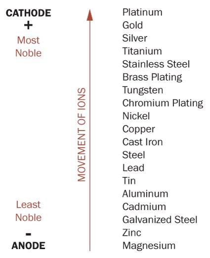

    OMG. . . I wanted to refresh my memory a bit and Googled something like "Galvanic current" and everything that came back was about beauty treatments of the skin!
    Finally, galvanic action "is a corrosive effect that occurs when two metals that are electrochemically different (read dissimilar) come into direct contact with each other." And for their example they show a diagram where Aluminum (Anode) is in direct contact with Copper (Cathode), and at the metal interface there are -ve (electrons stolen from the copper) moving from the cathode to the anode while +ve (Aluminum ions -- aluminum atoms stripped of their valence electrons) move from the Aluminum to the Copper, leaving less aluminum metal on the anode. Let that run long enough and the aluminum will get eaten away. They say it happens in the following way:
    1) A conductive path is created for electrons an ions to move between the metals
    2) One metal corrodes as its ions (atoms) move onto the other metal
    3) The least corrosion-resistant metal's corrosion rate increases, while the more corrosion-resistant metal's corrosion rate decreases.
    4) One metal becomes the anode and corrodes faster than it would on its own, while the other becomes the cathode and corrodes slower than it would on its own.
    They go on to describe galvanic action that occurs when two or more metals come into "electrical" contact (via an electrolytic environment, say the metals are all in water). In this case the movement of electrons and ions is facilitated by the electrolyte (water), but the effect is the same as the first example. And finally, they talk about galvanic action that is used in primary cells to create an electrical voltage (battery) that powers portable devices.
    Metals are just elements in the periodic table, and elements can be arranged in various series, according to certain properties, in this case the property of being more or less electrochemically acting (or reactive), so metals can be selected for minimizing the effects of corrosion, such as, say choosing gold to plate the terminals of wires that are run into automobile connectors, so they don't corrode. Gold is electrochemically almost nonreactive, as can be seen in the electrochemical series:
    Imagine bolting a copper water pipe to a cast iron engine block. Their galvanic action would be unremarkable. But then imagine bolting a platinum water pump to a magnesium timing cover. WOW!

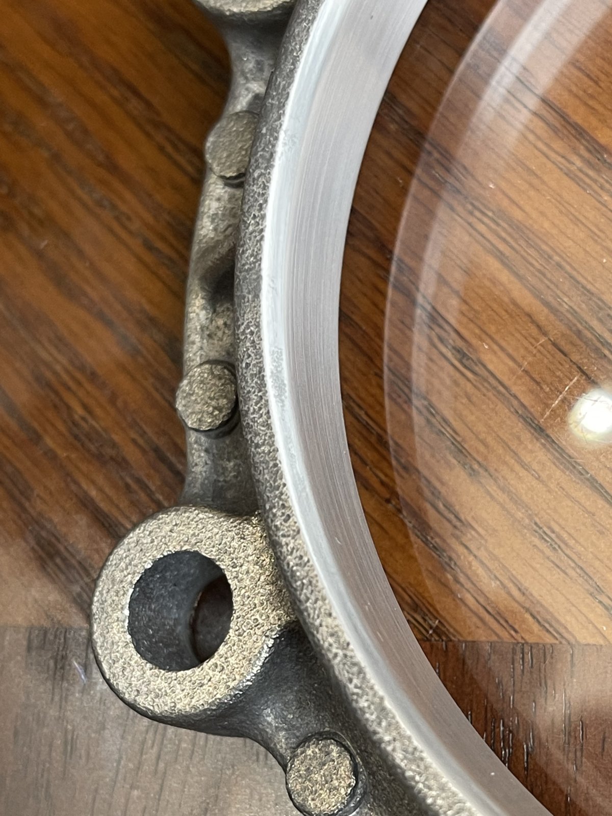

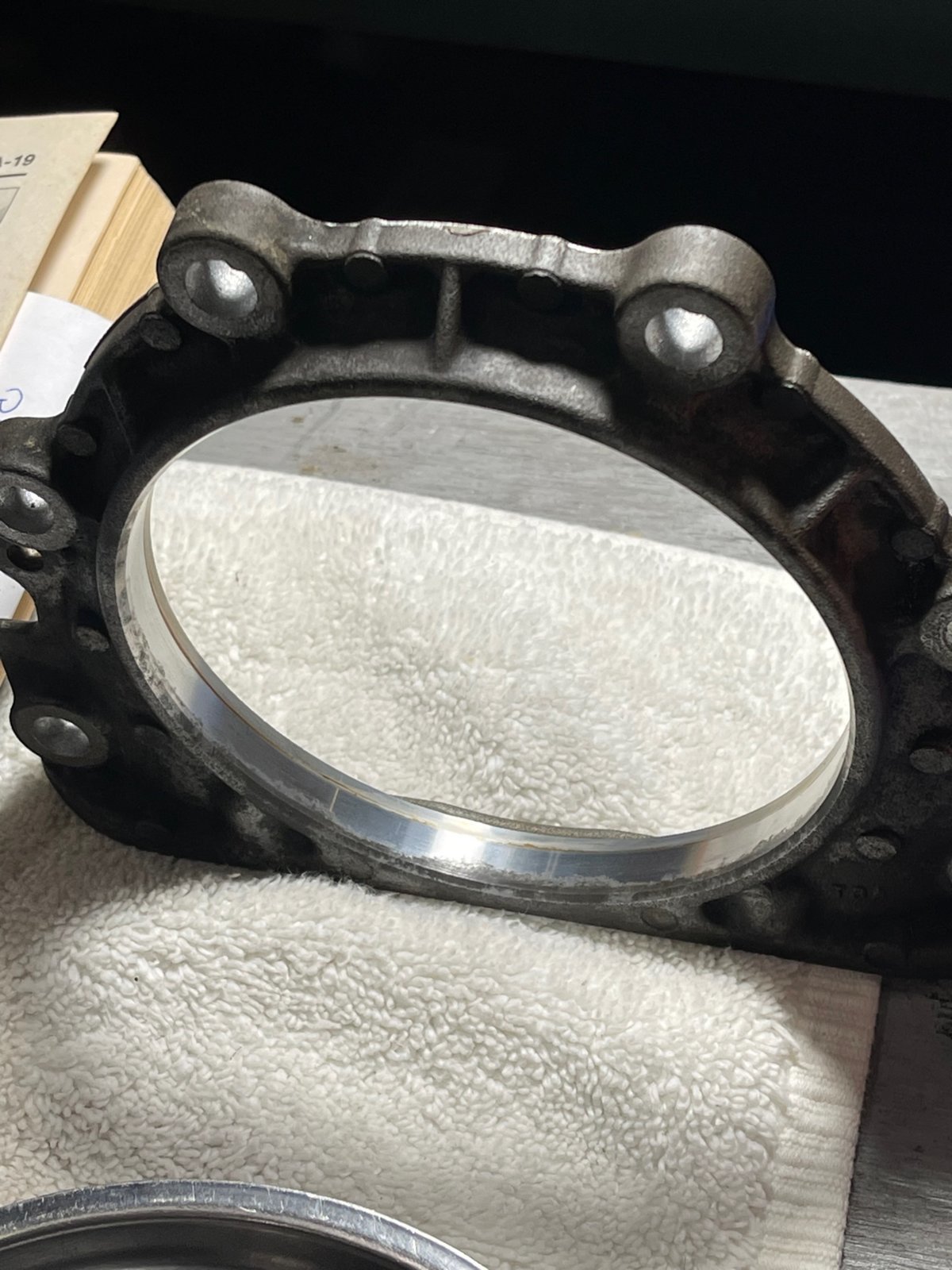

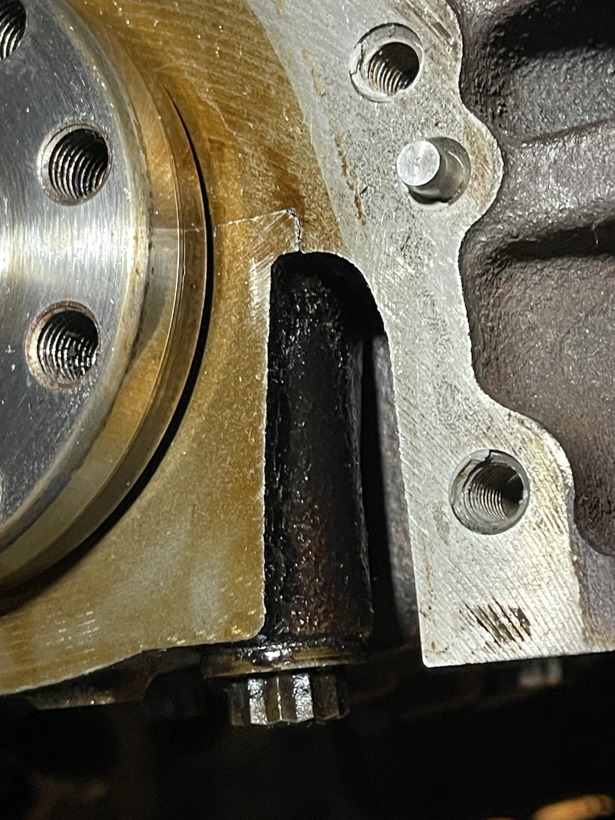

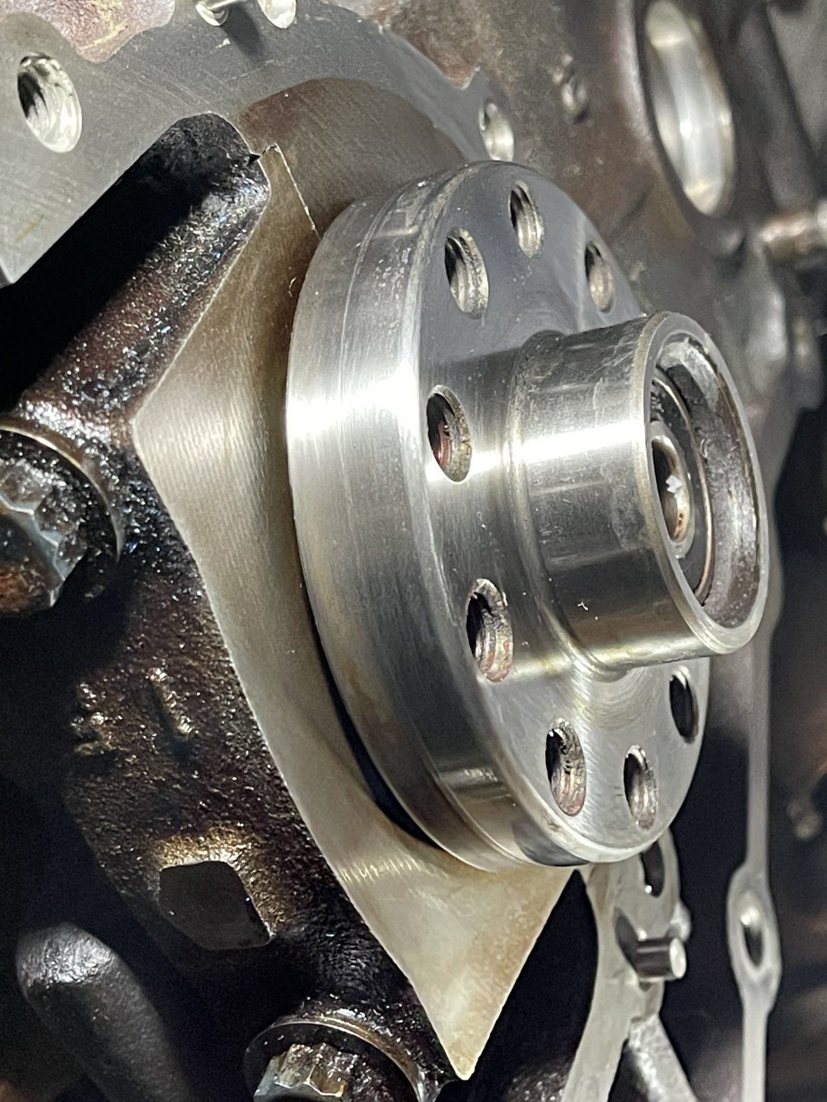

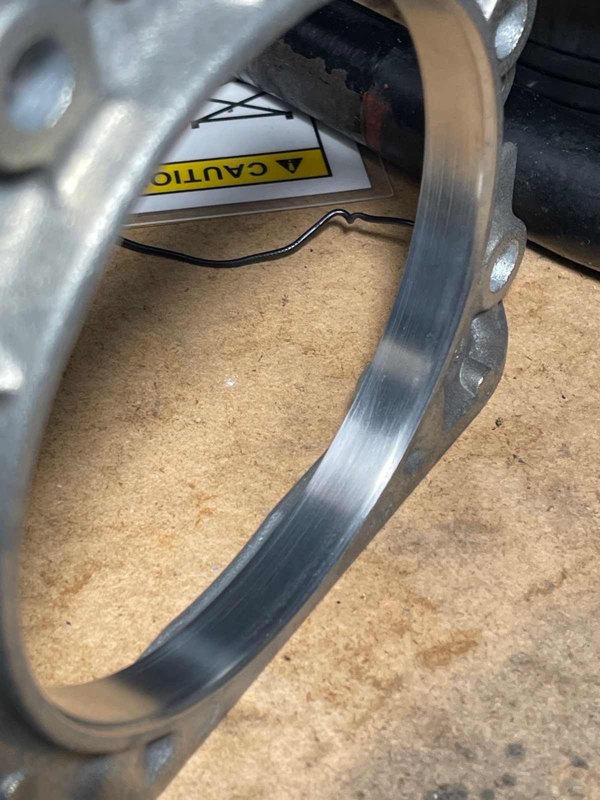

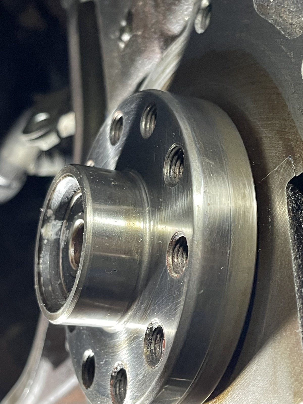

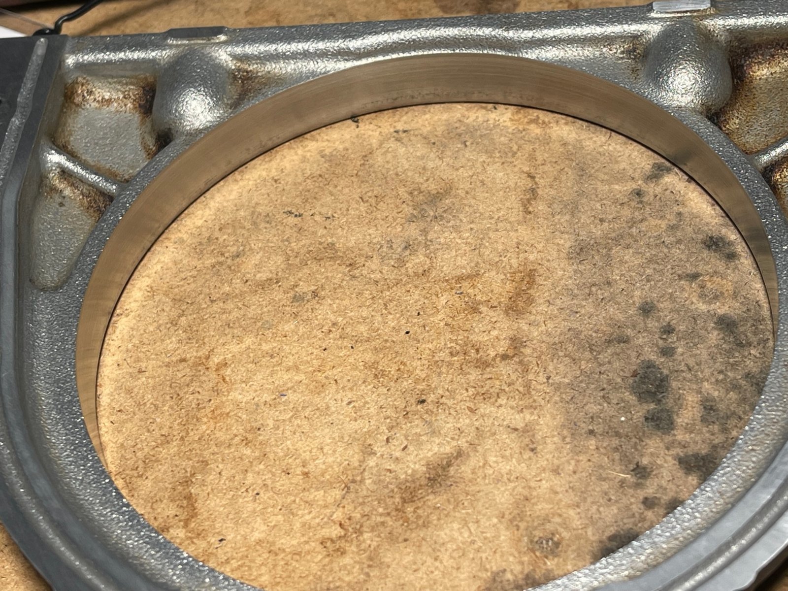

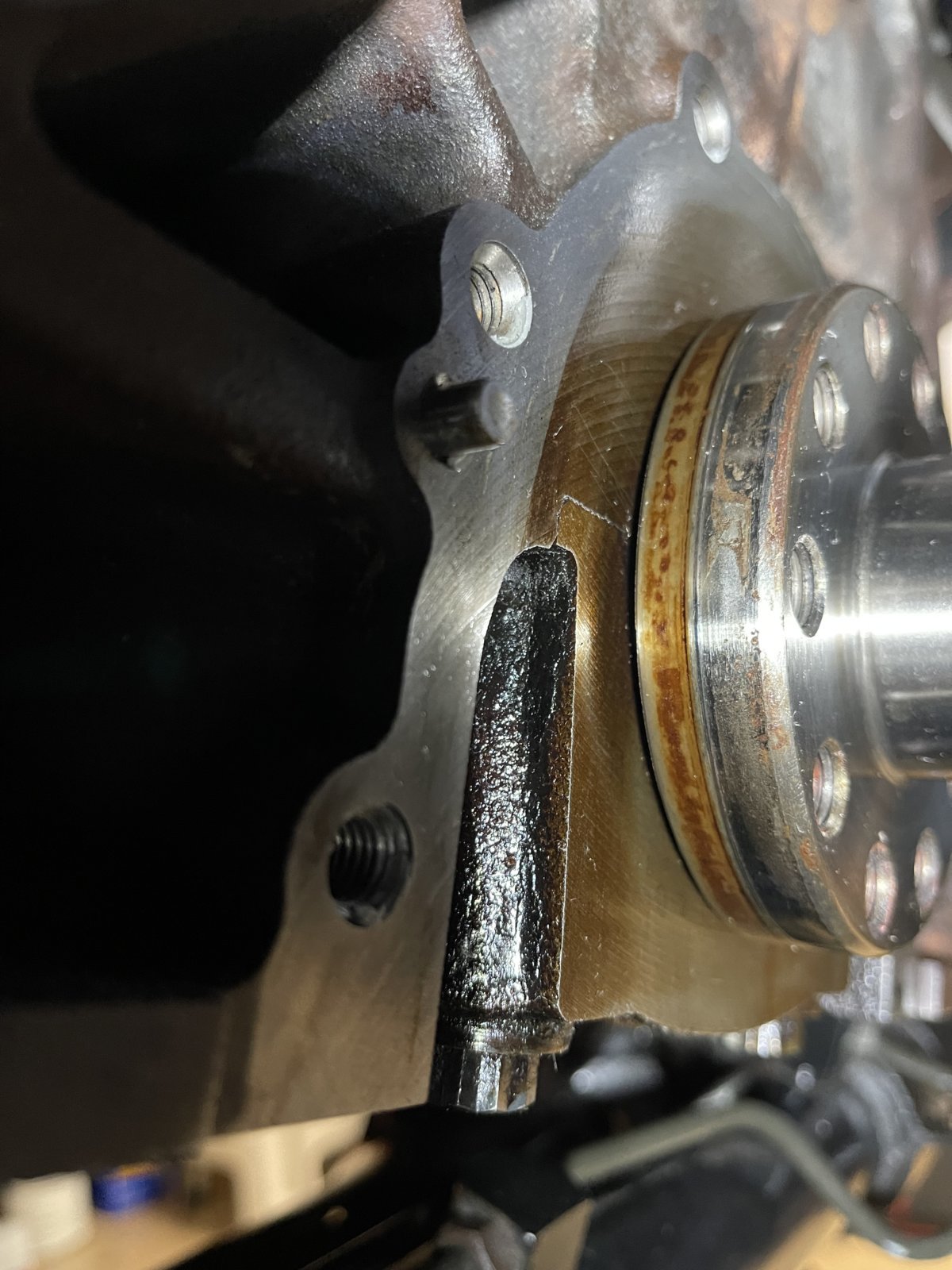

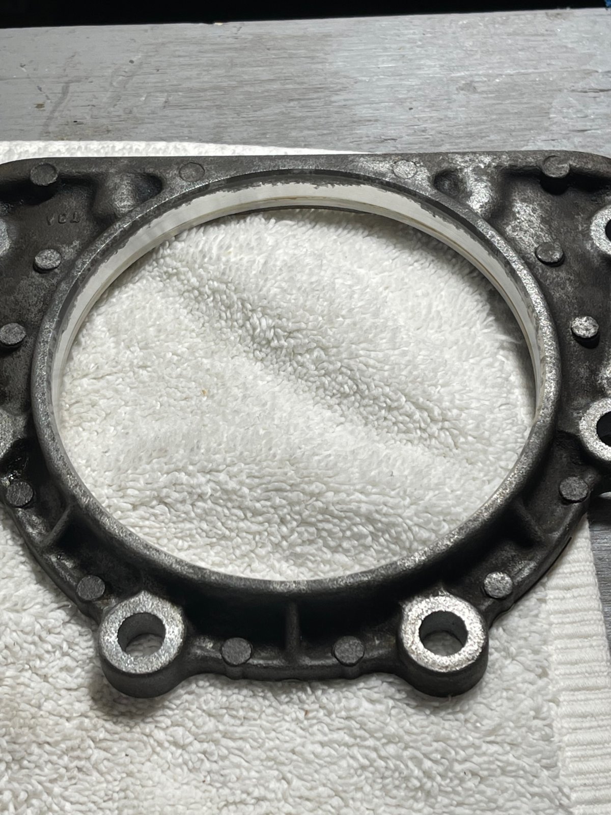

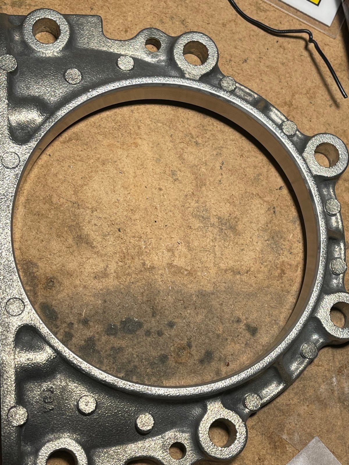

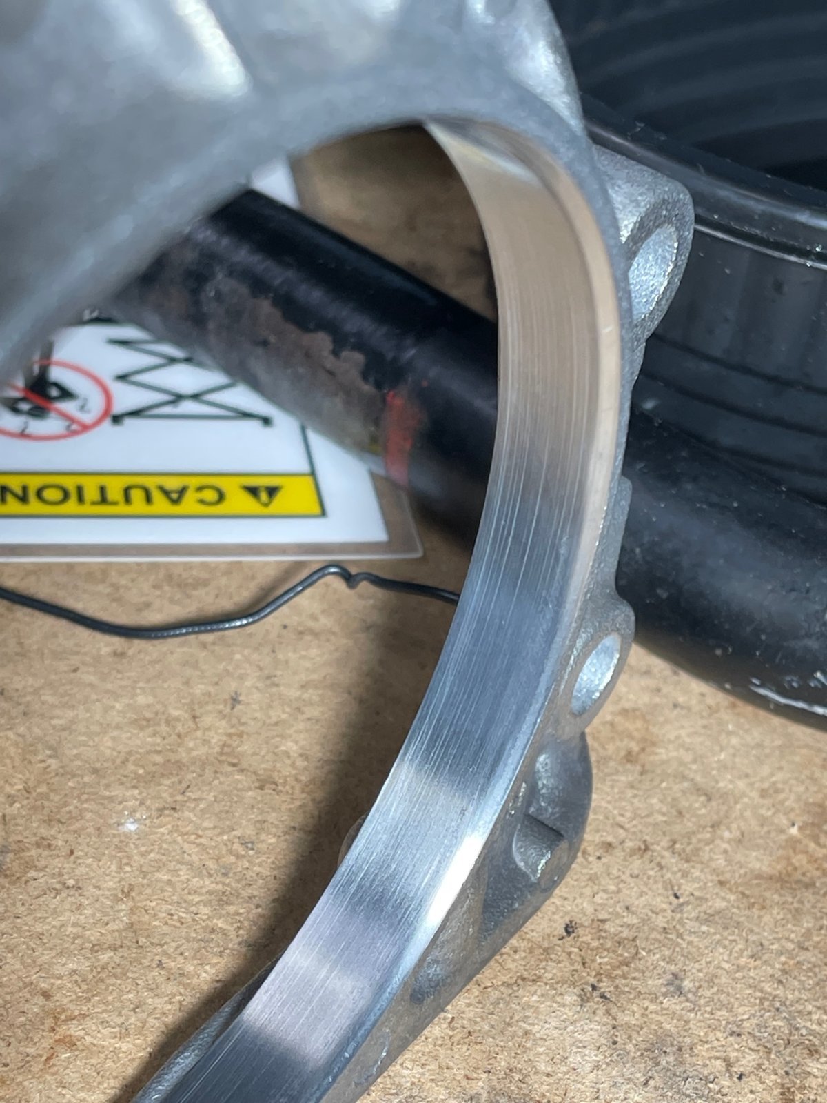

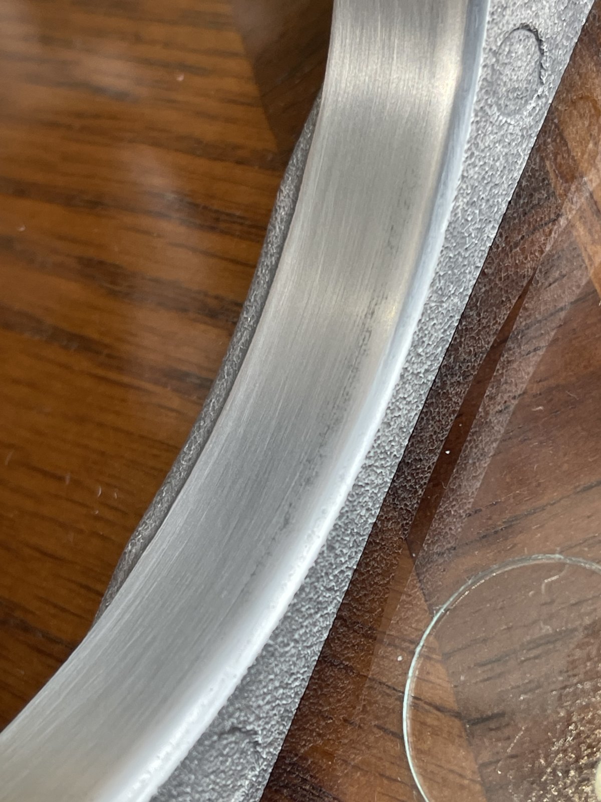

    You were right about the rear main seal retainer. I can see that it cleans up pretty easily without a lot of work. Used on sheet of 800 grit black wet sanding paper and got rid of most of the corrosion. Take a look at the photos and see for your self. I'm not sure if it is necessary, but was thinking that maybe I should use a finer grit and make that surface a little better polished?
    First the before:
    And now the after:
    IMG_9403.jpg IMG_9404.jpg IMG_9405.jpg IMG_9406.jpg IMG_9407.jpg IMG_9408.jpg IMG_9409.jpg IMG_9410.jpg
    Oops, now that I see them all blown up, I can see scratch marks that are bad enough that I know I need to spend time to polish them out.

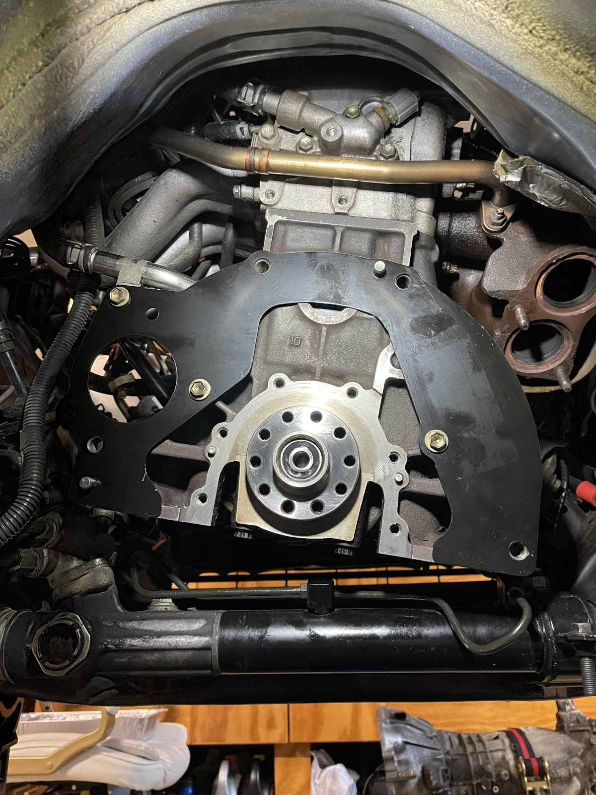

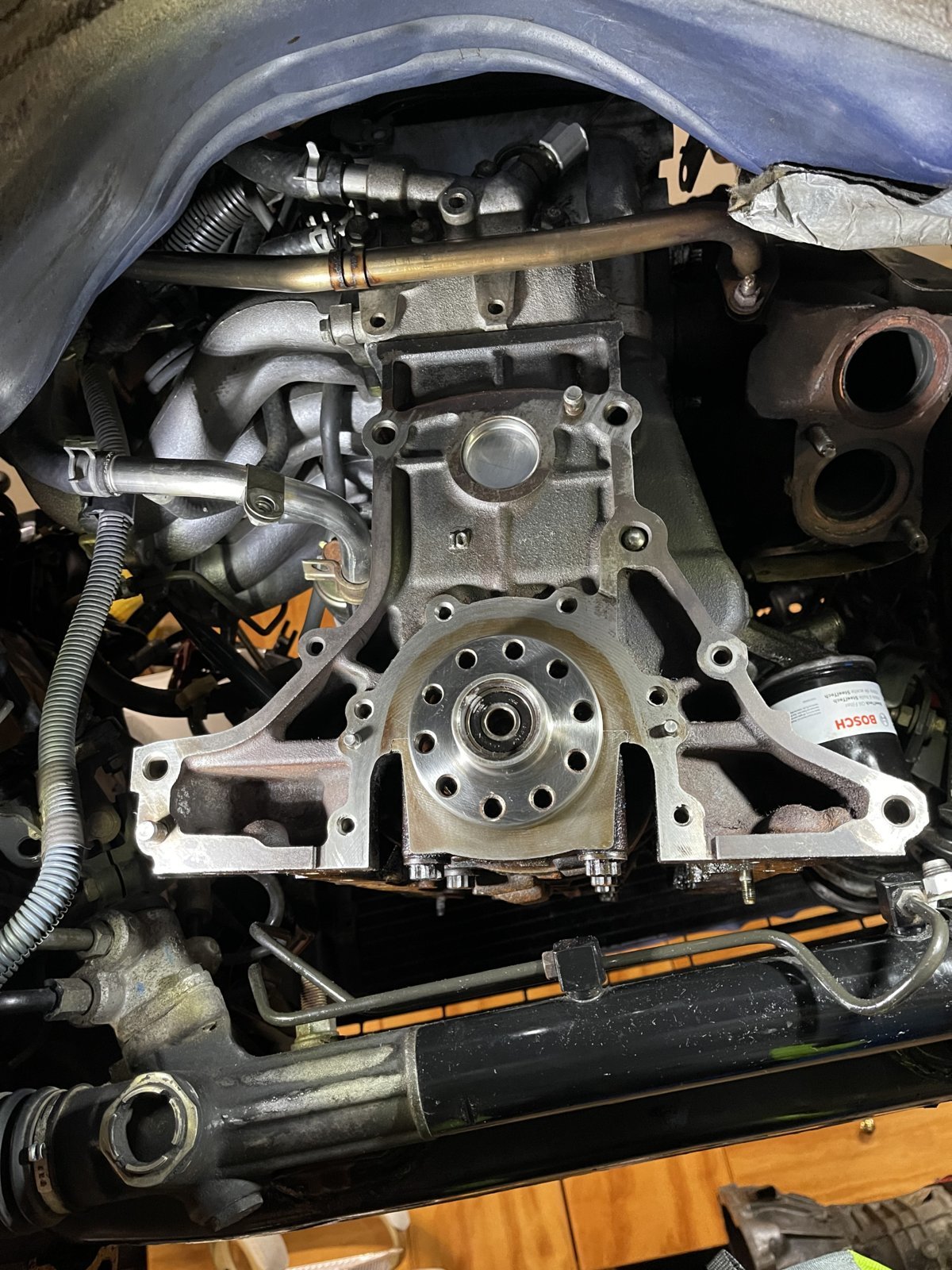

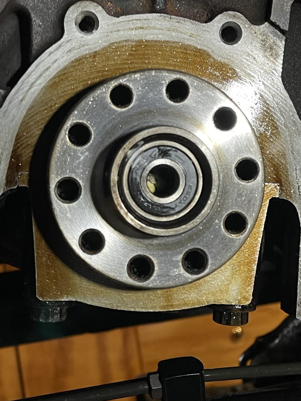

    Then I am sending a few other photos to show where things are at, and ask a couple of questions:

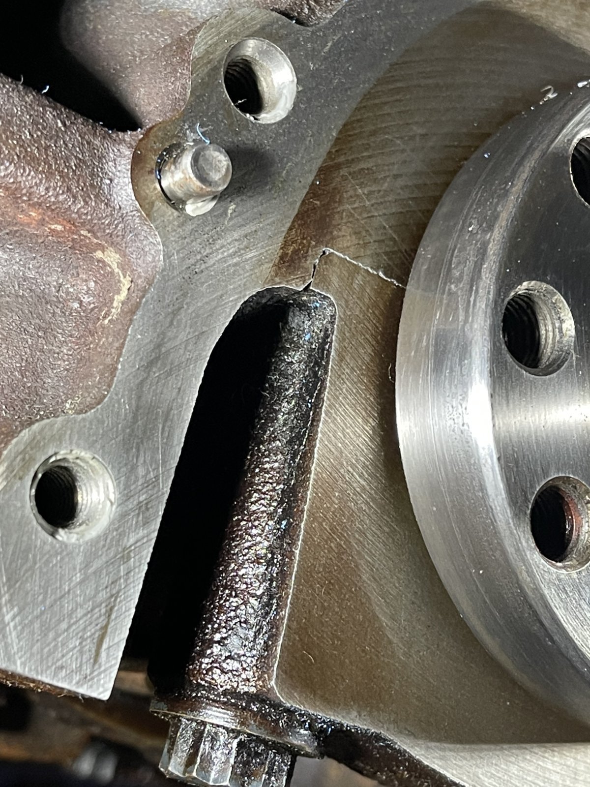

    1) The rotating shaft of the rear of the crankshaft, where the rear main seal is going to keep oil inside the engine. I will have to clean that first, to see if there is a ridge or something rubbed by the last seal, and maybe use one of those neat Speedy Seals that you showed me (?whatever they are called that slip over the shaft so the seal has a perfect sealing surface to ride on.).

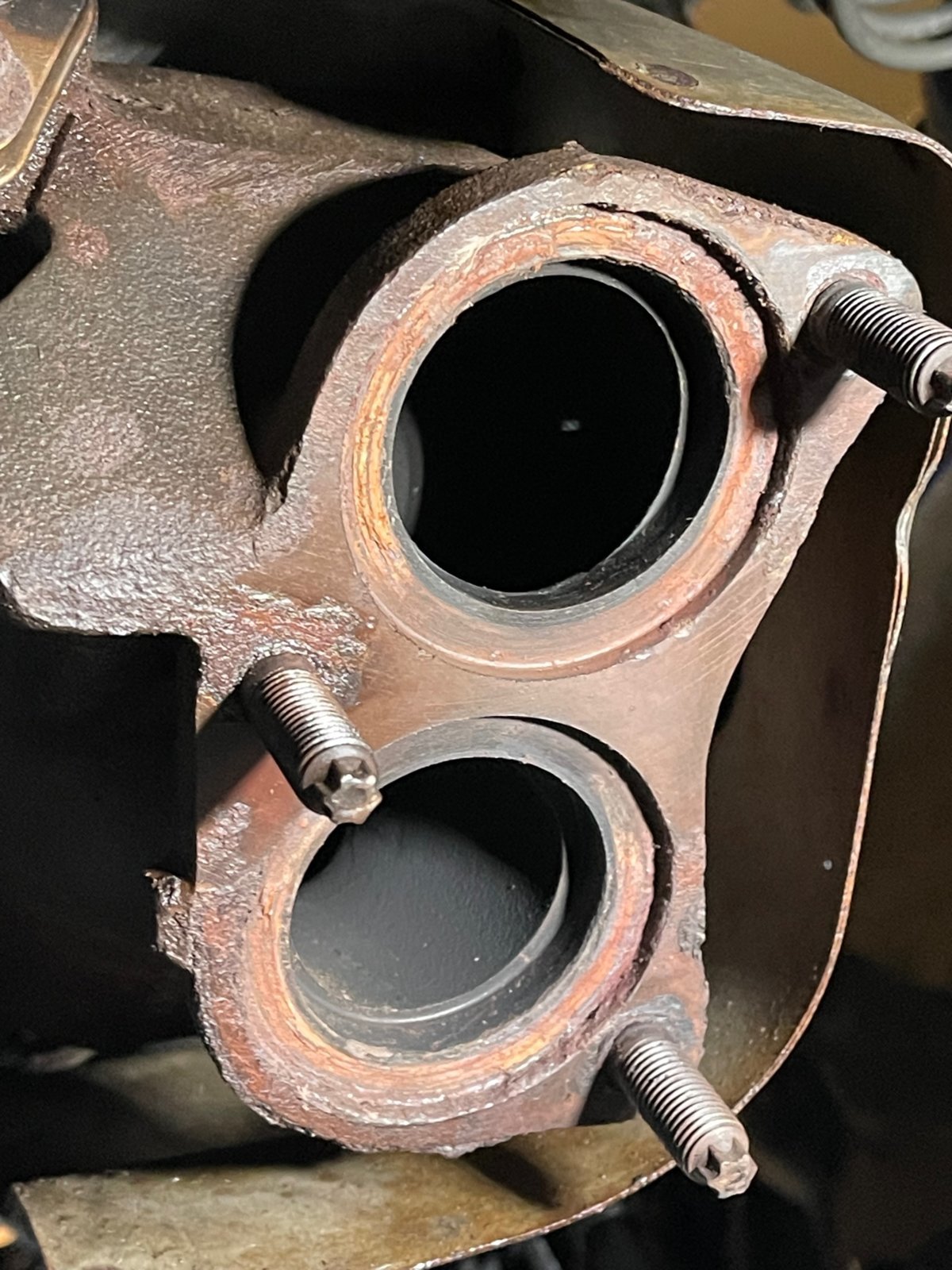

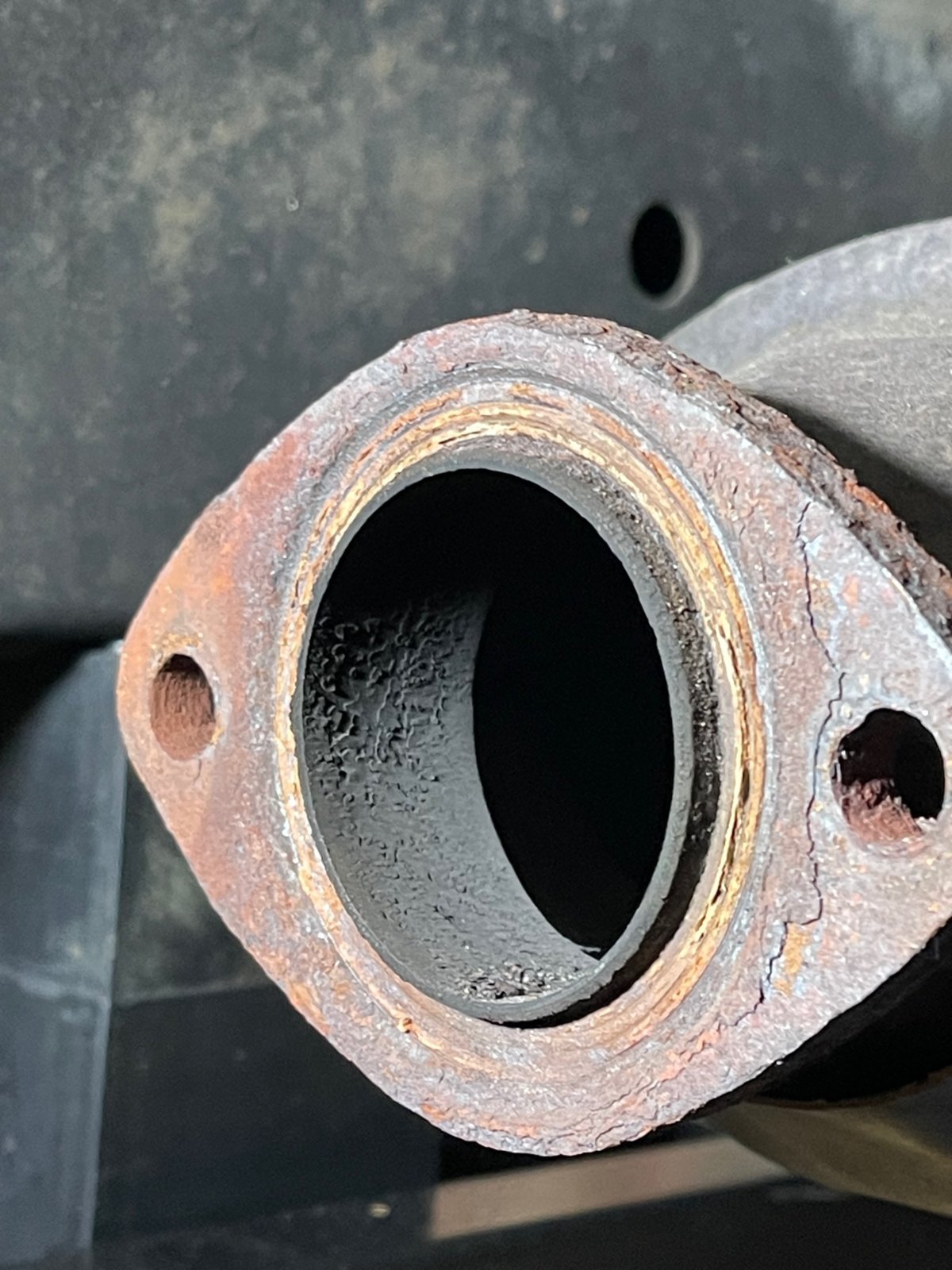

    And then two photos to ask about how good of a job do I have to do to make sure the exhaust seals form properly. First experience cleaning old sealing material out:

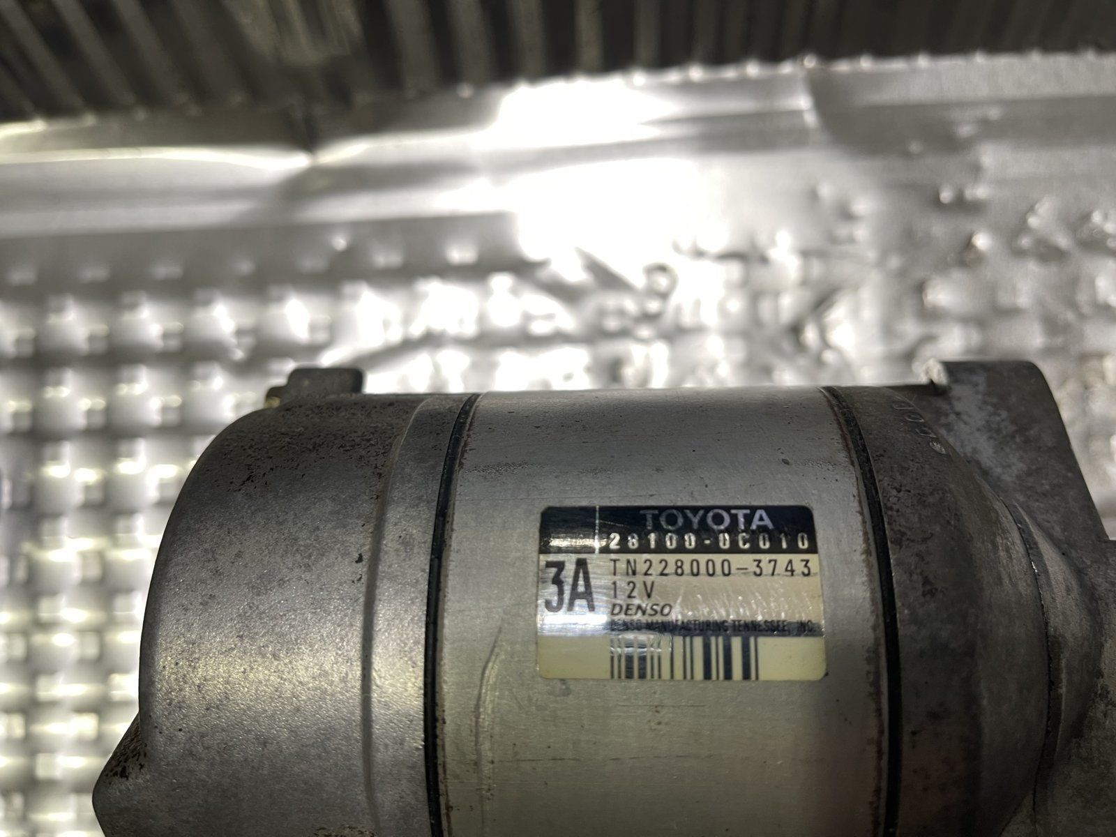

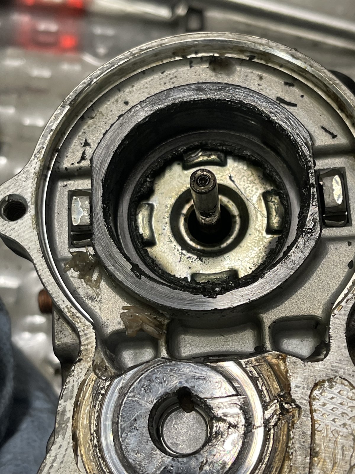

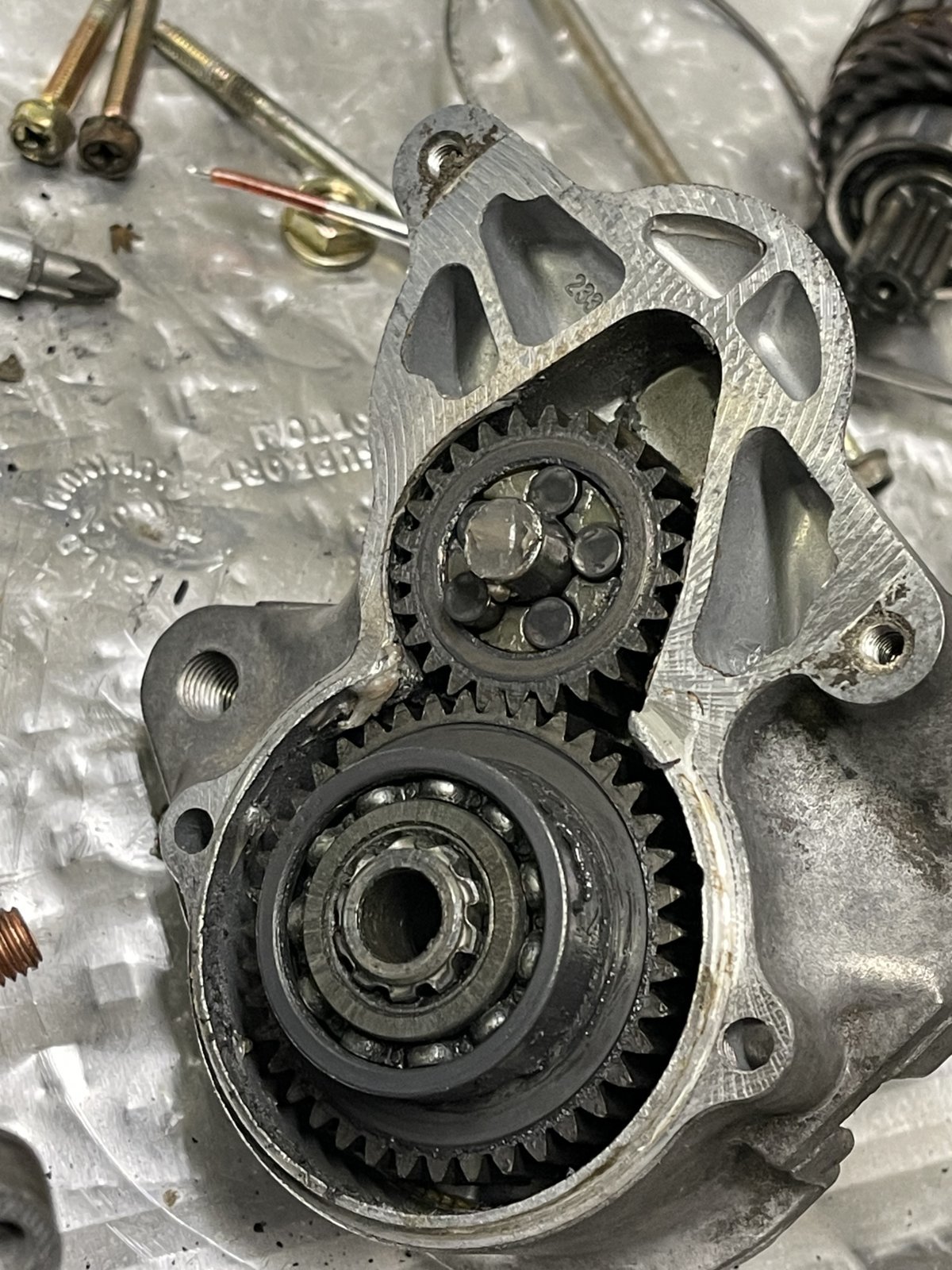

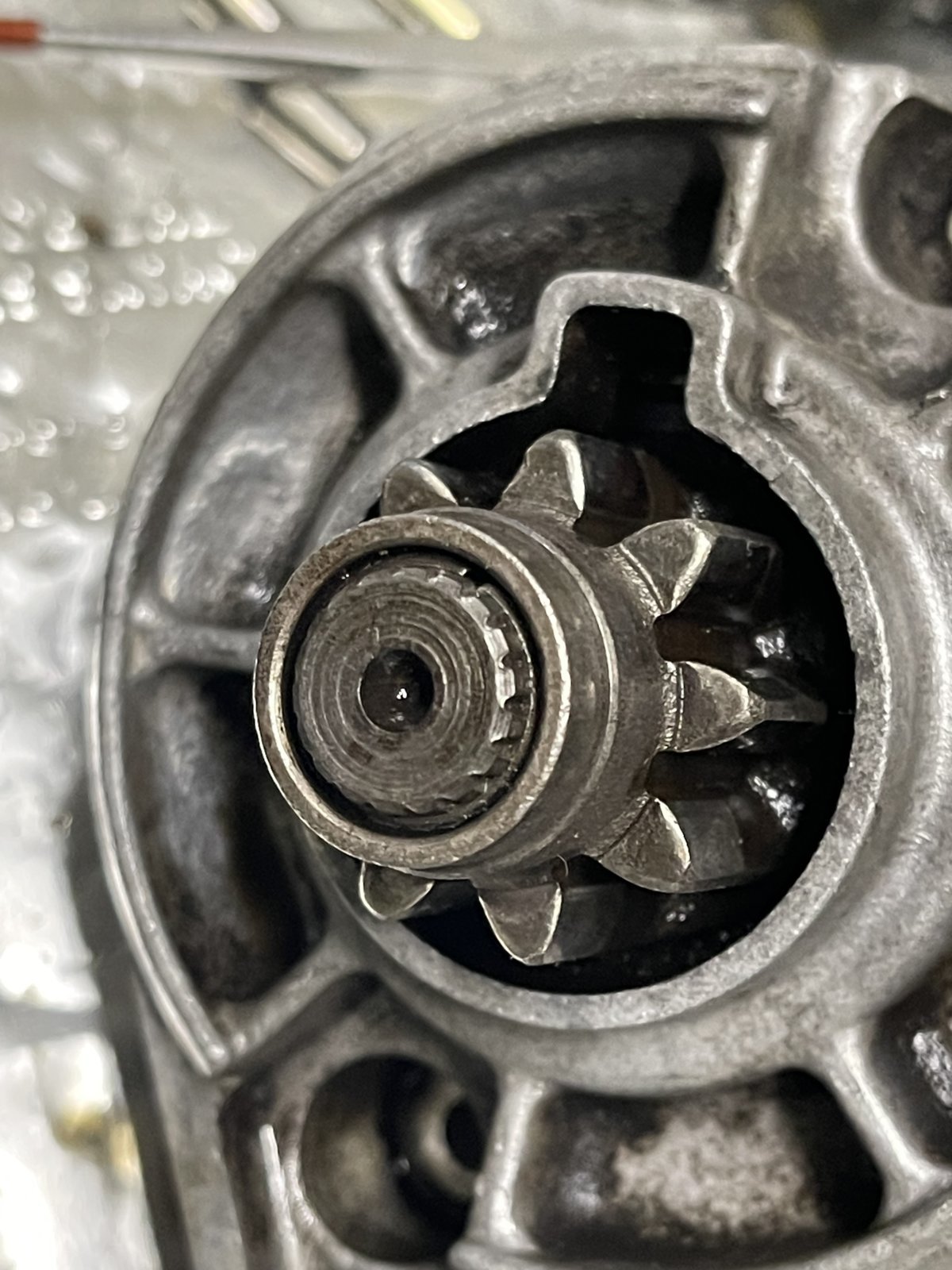

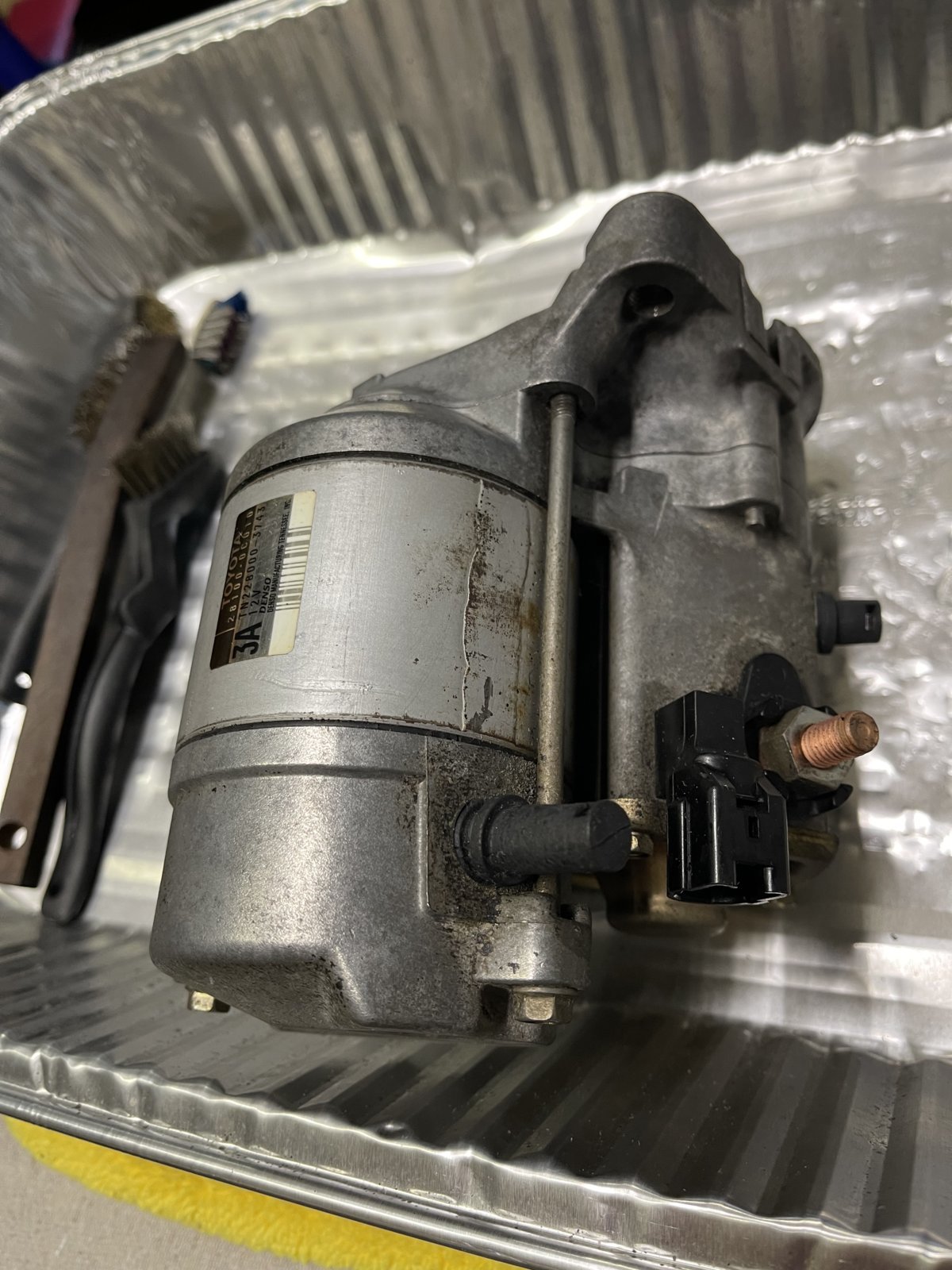

    Then, a look into the teeth of the starter motor. I twisted it with my fingers and it spun out strongly, as I thought it should:

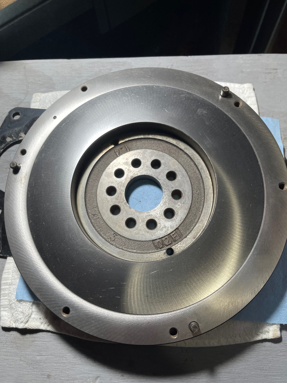

    Finally, the look of the resurfaced flywheel. . .
    That's an idea of where I currently am in getting down to putting all the Tacoma parts back in place. I'm getting excited now that things can move along more quickly.
    Thanks for your transmission explosion story. Now it is easier to comprehend why you called it an explosion, because it kinda was. And the reason is quite amusing to me because one of the things I had been thinking about potentially doing, since I had the truck torn apart as far as it has been, was to replace the spider thingys of the U-Joints (there are only 2). Now, hearing your story of your attempts at trying to replace your own, and not being able, that makes me feel like crazy because I had been thinking (to myself) that doing that job would be actually a little bit fun (never having done it before). Now, I have been forewarned. They don't look like they need to be changed out, so it will be easy not to do that job.

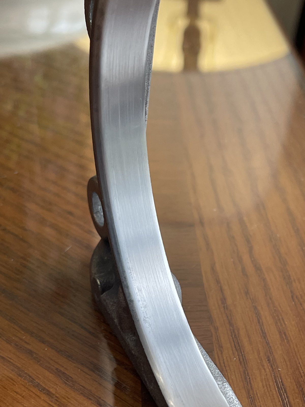

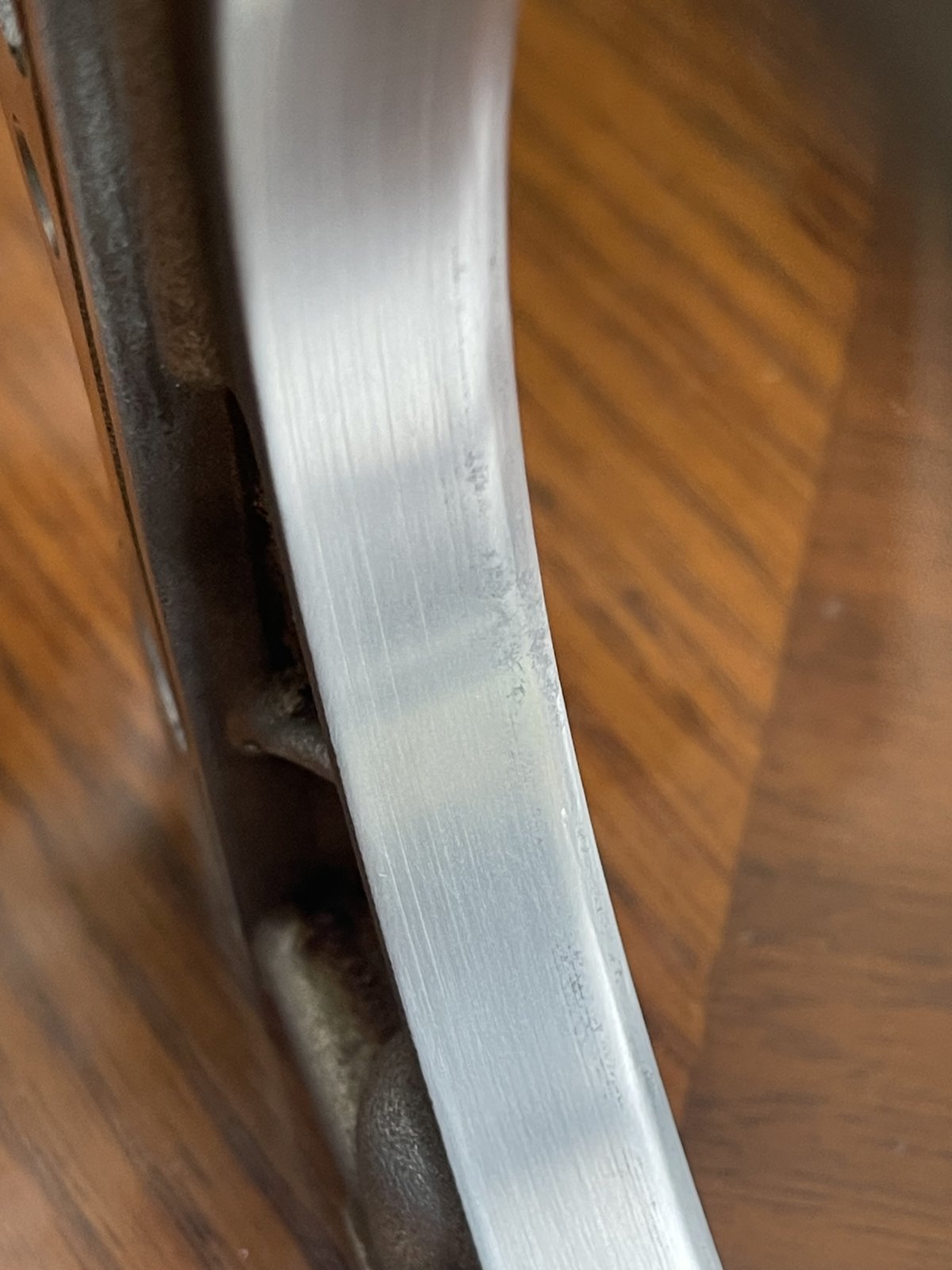

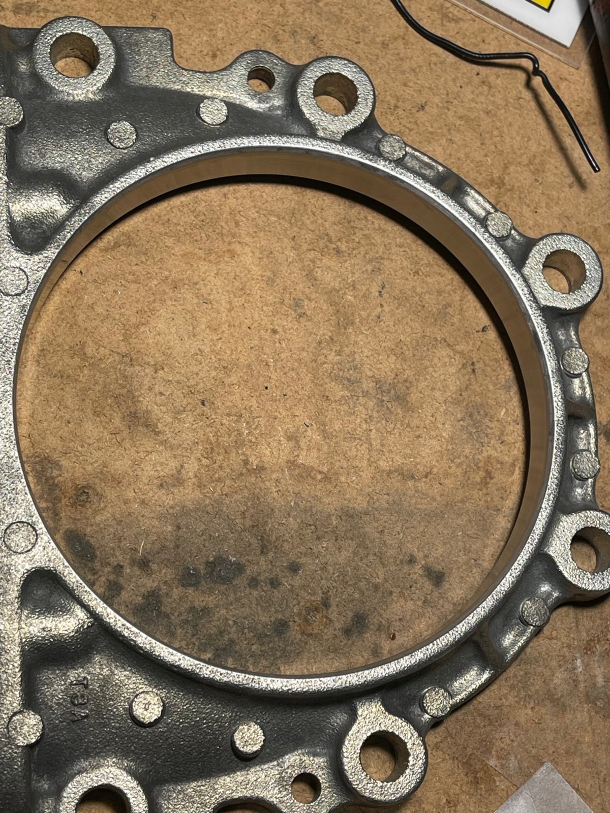

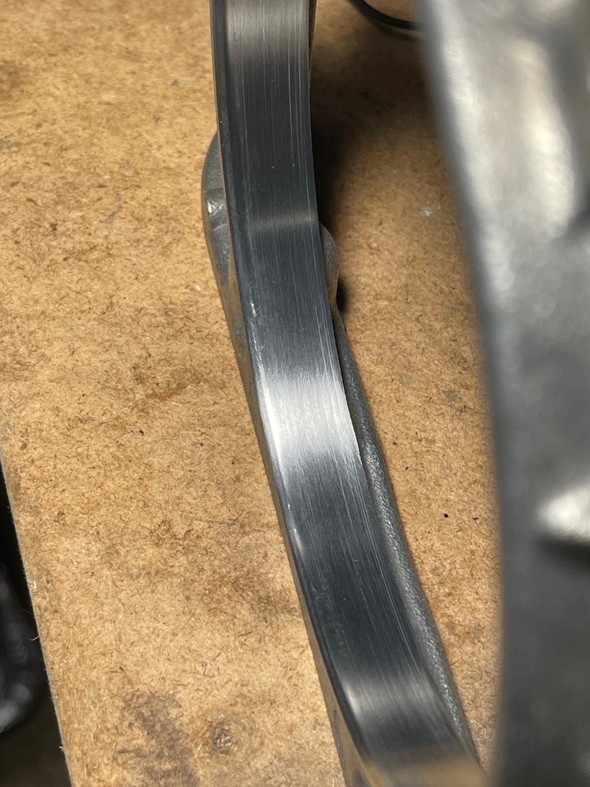

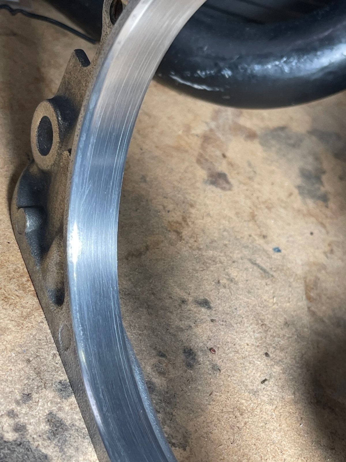

    Spent about an hour with 1,500 grit wet black sandpaper polishing away to try to eliminate the streaks created by the 800 grit. Laying around the garage, the next finer grit was the 1,500, so I tool a piece of it, knowing that I really first needed a more course grit such as 1,000 (after the 800), and after that move to something else between 1,000 and 1,500, before finally using 1,500.
    The result isn’t “jewelry” polished, but maybe it is good enough. The corrosion is barely perceptible now, and from a little distance, the surface appears “polished,” and to the touch feels pretty smooth.
    Anyway, since I got the high heat anaerobic sealant now, my plan is to grease both the polished surface and the aluminum with that sealant before pushing the seal into place, trusting that once the anaerobic seal has cured, without air, the seal/metal interface will form a lasting seal.
    Pls let me know if you disagree with me on this.

    I had planned, and was ready to put Permatex 51031 High Temperature Anaerobic FLANGE SEALANT between the polished aluminum surface of the seal retainer and the seal itself, instead of driving the seal in DRY, according to the FSM, thinking that my sanding may have opened (widened) the bore enough that oil might be able to penetrate between the aluminum surface and the seated seal that press fit to the aluminum. Also, that sealant would block any micropores in the aluminum where corrosion might have eaten into the bulk aluminum material.
    Then I asked myself what a FLANGE SEALANT was designed for. It is normally used like FIPG between two machined metal mating surfaces, such as the rear main seal retainer as it mates to the block, which is where my plan had been to use Permatex Ultra Black. The Permatex 51031 is used between two machined metal surfaces, same as the Ultra Black, normally. At that point, I called an application specialist at Permatex, but their bot told me they are only there during Eastern Time hours, so leave your phone number.
    I downloaded two Permatex product summary data sheets, one being the Material Data Safety Sheet. They never mentioned any materials that could be mated using their anaerobic product, other than metal.
    IYO, do you think that 51031 sealant would mess up the rear main seal's construction material when the seal is pressed into it, whatever it is (Teflon?), if I used the 51031 the way I planned to use it, to gain an extra secure oil seal? I think we had discussed this and you explained that using the anaerobic sealant was a better idea than non-aerobic because it cures in the ABSENSE OF AIR, so any of that sealant that got into the engine side would never cure to a hard substance, and would just disssolve into the oil supply, and not bother the engine. And any slop could just be wiped off with a cloth.
    Similar question: since the anaerobic sealant cures in the absense of air, why should I not use that same sealant to mate the rear main seal retainer to the block, giving the same benefits? For the retainer, the FSM says to clean both sealing surfaces and apply seal packing PN 08826-00080, or equivalent. Somewhere in my reading, someone suggested the Permatex Ultra Black as the best equivalent, so I bought some back then. Then I bought the high temp anaerobic sealant. Then I read all the fine print on the plastic tube of 51031, and I felt like they were telling me to be extremely careful with this dangerous product, though there are YouTube videos showing techs using it for sealing mating surfaces of all kinds. Note: One of the ingredients is CUMENE, a known carcinogen, in experimental animals [It caused tumors at several tissue sites, including lung and liver in mice and kidney in male rats. Dec 21, 2021 https://ncbi.nlm.gov/NB...).
    Maybe I will wake in the morning and realize I am overthinking again. . . at least I am THINKING!

    Everything looks real purdy and shiny aha, I fully support doing what you have to do to ensure the rear of the crankshaft is in good condition to accept the new seal and work properly. Especially seeing that it's not exactly a quite and easy job if the seal were to leak.
    The retainer should be more than fine. One of my confessions to bad habits "that i've done for years with no ill effects (insert other common things that people say when they're justifying something wrong)" is that I normally remove seals by hammering in a #2 flat head a small amount between the outer diameter of the seal and the bore then prying out the seal like that. You have to be very careful to not nick the surface of the shaft it has to seal against or you'll have problems. If there's a knick in the static sealing side of the bore, I usually just take down the high spot with a round file or sandpaper as appropriate so that no part of it stands proud to the rest of the bore. As long as there is no path from the knick to the inside edge of the bore which is the fluid side, it doesn't leak. Even without additional sealant. I know that's bad... don't tell my mom.
    For how good the exhaust surfaces have to be.. maybe a 7/10? Typically i'll either scrap off the larger pieces or hit the surface with a wire brush on a power tool and call it a day. Alot of guys I worked with along with myself when I was just a teenager trying to make my car work again, would simply replace the gasket and call it a wrap with zero cleaning and have no exhaust leaks either. Especially if it's that thicker graphite(I believe) type gasket, sealing the exhaust tends to be quite forgiving. If it's just a "fire ring" type seal then those also tend to be quite forgiving.The only exhaust gaskets i've encountered so far that are some what particular about their surfaces are the multi-layer steel types. Mind you even those i've seen installed with no cleaning and not leak... albeit on relatively new vehicles which light corrosion on the sealing surfaces. Nothing major and no pitting. To more directly answer your question though, I wouldn't polish the surface for say but getting the looser debris off would be as far as I would venture.
    I personally hold the view of not touching u-joints unless I absolutely have to beyond just "don't fix what isn't broken" but who knows, maybe you'll be a whiz at changing them aha. I've never met anyone who's encountered the difficulties I have with changing them. No matter if they use a hammer, vice, 20t press, ball joint press, u-joint press or some combination of them all. I assume it's because I don't follow my high school auto teacher's advise for when things aren't going smoothly, which was to "talk to it like your girlfriend"
    Ya, there isn't any issue with using the anaerobic sealant between the outside diameter of the seal and inner diameter of the retainer that i'm aware, similar jobs are the primary reason I keep the stuff on hand. In regards to using it to seal the retainer to the block. Short answer is yes you can use it in place of the RTV/FIPG that they suggest in the FSM. Down side to the anaerobic seal instead of RTV is that it's not as forgiving of imperfect surfaces and doesn't seal as well. Like the anaerobic sealant is primarily for applications where the two surface contact areas could almost seal on their own because they're machined so well, along with it doesn't form as robust a seal as RTV would. If both RTV and anaerobic sealant were subjected to progressively increasing pressures of the same medium they were sealing in a side by side test with all other variables controlled and optimal application procedures, the anaerobic seal would fail quite quickly in comparison to RTV. I think of anaerobic sealant more as an assistant in sealing than that the primary seal. The only places really that it's specially called for in FSM's is applications where the thickness of the RTV would change the spacing of the components too significantly to allow for proper operation. With that said outside of helping the outer diameter of a seal, I've used it on transfer cases and I sealed the tail shaft of my Frankenstein'd ranger transmission with it after cleaning the surface with acdelco glass cleaner. I haven't had it leak even to this day (I know the person I sold my ranger to) however a manual transmission and transfer case don't see pressure to their cases beyond the physical weight of the fluid in them unless there is an issue with their venting systems. So in conclusion, you can use anaerobic sealant in lieu of RTV but it's less forgiving and requires the surfaces to pretty much be within machining tolerances of each other to work. I believe the Permatex literature for the sealant you acquired stated it would seal gaps up to 0.02" when using the primer... I don't know what the primer is exactly but I know that brake clean alone is not sufficient when anaerobic sealant is the primary seal. As mentioned, i've used AcDelco glass cleaner as that's what my shop foreman recommend. I imagine something like strong denatured alcohol would work in place of the primer but I don't know. I've never used the specific stuff before. It could also be a "promoter" like the stuff you have to apply to plastic oil pan's prior to the RTV bead which in that case increases the adhesion to the plastic more so than cleans it.

    I have seen someone using one of those with the vice grips, and it seems to be a good idea for the reason you gave. Where did you get yours? When I have the flywheel mounted, since the engine is non-operational, I am thinking that maybe my wife can turn the crank while I watch the dial indicator.
    That's a big relief to me, having you say that it is ok to use the HT anaerobic sealant to ensure that the retainer side of the seal will not leak over time. I rubbed that surface in knocking down the 1,000 grit sanding ridges so much that I was turning against myself thinking that surely oil will eventually find a way out in that pathway, and was thinking that my only hope was the anaerobic sealant filling in the very small (potential) gaps. Now, I am feeling very good about moving ahead.
    Check me on this:
    The Permatex HT anaerobic sealant I have has a tube opening that is a small hole. It's directions say to make SURE that you apply a continuous bead; they don't want any discontinuities in the bead. Now, when I apply it to the retainer surface, I guess I should make the (continuous bead) application as close as possible to the front edge of the sealing surface (which has a chamfer), possibly to include the chamfer, so when pushing in the seal the seal's leading edge will carry (smear) some of the sealant into the sealing area all around the retainer sealing surface. That is totally in my imagination at this point. I don't know exactly how the sealant will get inside the sealing edge from its "continuous bead", so let me ask you. Should I use a nitrile glove and smear that substance all over the retainer sealing edge, and not pay attention to the manufacturer's requirement that I lay down a continuous bead, considering that a continuous smear, rather than a continuous bead, would likely fill in all the potential gaps imagined, while obeying the spirit of the manufacturer's rule?
    You gave an enlightening discussion of the differences between this anaerobic sealant and RTV, and yes, the specs on the anaerobic do talk about it sealing two well machined metal surfaces and how it is able to fill in small gaps, on the order of a few thousandth or so, and 20 was probably the upper limit. Curiously, that was the "step" measure of my flywheel that the guy just quickly ran his fingers over and said "yes, that's a 0.020-inch step" hahaha. Also, it seems reasonable to me that it is not as capable as RTV, as you pointed out, which answers my other question, thanks. Originally, I only wanted to use it for the very tiny gaps that might exist in the retainer-to-seal space, to ensure a good long-term oil seal, but when reading the (almost unreadable crammed in font) information on the anaerobic I started being confused about it being used in making oil seals. That unfortunate issue of wondering off into the weeds, from time to time, is a big problem when you lack solid experience. On the other hand, sometimes it leads to alternative solutions that sometimes turn out good. You are keeping me balanced, so I really appreciate your being there.

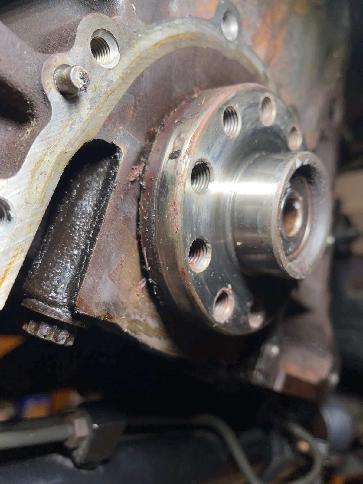

    The AcDelco Glass Cleaner you use as a final cleaning step. I found 100% Isopropyl Alcohol does a good job at cleaning the final layer of oil from metal surfaces, even use it now when I want to clean my tools before storing them away. I was thinking of using it as the final preparation step before sealing anything to metal, such as the retainer-to-seal surfaces, and the retainer-to-block surfaces. Am I not understanding what AcDelco Glass Cleaner is? I have been a Windex champion for cleaning glass all my life (reminds me of a movie titled something like "My Big/Fat Greek Wedding"? where the main character was also a windex champion). Should I chase down that AcDelco Glass Cleaner to have it around my garage? Or, am I misunderstanding what you meant by "primer"?
    After cleaning the garage preparatory to digging in in earnest, I started cleaning the varnish off the crank-shaft end where the seal rides, along with the rest of that end of the block where other things get attached, so everything will all be ready when I am. I tried to look closely at where the ring around it made by the old seal might have scarred it beyond repair. I am thinking that your other idea about a "sleeve" that goes onto the rotating shaft renews the surface perfectly, so want to ask you the best way to take the measure and where to get the sleeves. Do I need micrometer accuracy, or will a harbort freight caliper get me the proper measure? Though not yet done cleaning, I wanted to show you the condition of the rear end of the crank-shaft.

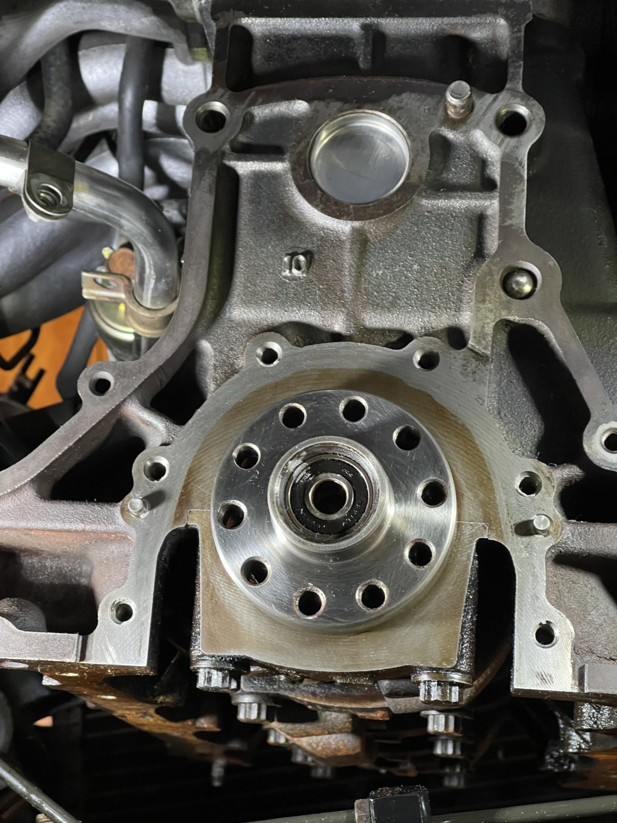

    I will replace the pilot bearing, and once finished cleaning the shaft surface will again use some very fine grit wet sanding paper to see how well the shaft will clean up, and see if I can't remove the abrasions and rusted spots that can be seen in the photos. Just remember that this engine started with horrible oil sludge, so that varnish is hard to whittle down.
    I have used some degreasing chemicals, but found that diesel seems to do pretty well. Scotch Brite might help as well, but haven't yet tried. I am especially concerned that I get the mating surfaces perfectly clean of all oils.
    Finally, I really had to laugh when you discussed the U-joint phobia:
    "I personally hold the view of not touching u-joints unless I absolutely have to beyond just "don't fix what isn't broken" but who knows, maybe you'll be a whiz at changing them aha. I've never met anyone who's encountered the difficulties I have with changing them. No matter if they use a hammer, vice, 20t press, ball joint press, u-joint press or some combination of them all. I assume it's because I don't follow my high school auto teacher's advise for when things aren't going smoothly, which was to "talk to it like your girlfriend"
    It is my honest opinion that your auto teacher's advice is solid! Even inanimate objects have something inside that can talk to us, at least if we are men. So many times just falling back and giving an unyielding effort a little bit of free time from the frantic banging, resting your mind, relieving the particular stress of the moment, and then coming back a little later and just looking very carefully at everything involved, every place where one thing touched another, or where some kind of mark might be telling a story, a sudden insight can occur that tells you (sometimes) a whole different way to do the same thing, or you see something you had overlooked. Come to think of it, that's maybe more something I do because I am not already skilled, but maybe it has a more general application?
    Moreover, I am not going to attempt to replace any U-joint that is not clearly in distress, based on your experience. After all, it only requires removing the drive shaft, which is silly easy in comparison to taking out the transmission and changing the clutch, so I could have that simple pleasure whenever I might want, and will not push it.

    Having your wife as a helper is awesome for things like that. Even though mine is willing to help, i've gotta so used to primarily finding a way to struggle on my own unless it's a significant difference in time to have help or a guy just happened to be next to me at the right time. I used to either end up turning the engine via a flywheel mounting bolt if I could without torquing them more or install a bell housing bolt for a pivot point and use a prybar to rotate the flywheel via the ring gear. I couldn't always get a ratchet and socket on the crank while looking at the dial indicator.
    Smearing the sealant on vs. Applying the bead wouldn't make much if any difference here. Yes most of it will be displaced by the seal but I agree with your thought process and do the same sometimes due to the same reasoning. The two reasons they want you to apply a continuous bead is so that it's not contaminated via contact with something after application and because if there is a break in the bead it creates a potential leak path.
    In the event of sealing a large component like a timing cover or some oil pans or anything else were a continuous bead isn't possible due to having to reposition or apply more pressure to your sealant tube to continue it's flow, I was shown two ways to go about it. First way is to back track a little bit as you near the point of having to end your bead and start again, then continuing from that retracted position creating a small overlap of two smaller beads that will fuse together upon fastening the component to it's home. The second way I was taught is to just apply the bead and leave any potential gaps until the end then lick your finger and lightly dap any gaps closed. Licking your finger will prevent most sealants from sticking to your finger and also allow you to verify your sealing surface is clean. If it's clean then the sealant will stick to the surface and you'll just get a dap from contact where as if it's contaminated the whole bead will lift off the surface when you dap... I only really use the overlap method as it's quicker and i've developed techniques like occasionally lifting my sealant applicator further from the surface or "leading" my applicator a little further ahead from the bead to see if it lifts off the surface along with I typically make sure my surface is prepped before I even get the sealant then another quick cleaning and wipe before I start the bead.
    Hey and in regards to your machinist feeling a 0.02" gap, it's possible ahaha. When I frequently had or worked with vehicles that had tapered wheel bearings that needed some play in them when setup properly to allow for heat expansion due to braking I could pretty reliably adjust to 0.001-0.003" of play. I don't know if I can anymore because I haven't touched a setup like that in about 3-4 years. Not to say I never verified by measuring. I'd rather be sure than just confident.
    A guy could for sure wander off and encounter slender man looking for better and alternative ways to do things but I honestly feel that the majority of my learning has come from trying something different. Especially on my own vehicles. One of the top lessons I learned from experimenting is to experiment first on things that are easy to do again and/or cheap to replace if the experiment were to epically fail. If it falls into that category of hard to do again or expensive in a worst case Ontario situation, then do your research and do a cost benefit analysis. An example of that for me is that there are few situations where I take fluid recommendations as a requirement and not just a suggestion. That has a potential though to be very costly if I were to experiment by running a 0W-12 motor oil in a Ram 3500 6.7 Cummins then go towing a camper across Montana. Or using atf in place of brake fluid. I support experimenting, those are just my tips for deciding when and where to experiment.
    My latest rabbit I found myself in, which is minor in comparison to others, is trying to decided what brake rotors and pads to get for my truck when mine wear out as i'm at 168'000kms and had 6mm on my front pads when I serviced them back in October so I expect by either the summer or next fall they'll be up for replacement. The pads I pretty well have picked out which will be ceramic and Akebono's as they made my factory pads and my only grip is I want a little more bite from them and a firmer pedal. Otherwise I think they're great. Rotors i'm unsure about because they haven't warped for me(much) but I can feel they are a bit and have been for atleast 100'000kms. I may get factory ones again but I'd prefer ones a bit denser and heavier if possible since I tow commonly... it's a challenge to figure that out without weighing them or holding them as manufactures don't tend to post such info.
    Isopropyl is a better option than the acdelco glass cleaner for this application. I think the acdelco glass cleaner is amazing stuff made with fairy dust but, my main reason for using it was because the acdelco glass cleaner was provided as "shop supplies" so we could get a can for free where as the alcohol we would have to go purchase on our own after work. At home I use isopropyl. The primer is a different thing altogether. It's a specific chemical that you apply before the sealant to help the sealant work better... to be honest I think the "primer" is just an expensive cleaner the sealant manufacturer sells to make some extra pocket change.

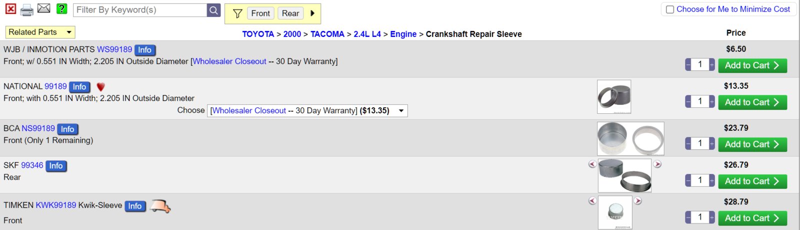

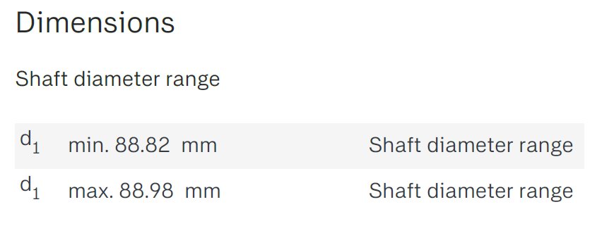

    After the crank is cleaned up, the general automotive way for checking machined surface imperfections is to run your finger nail/a toothpick across the surface and if your nail/toothpick catches the groove/imperfection then it'll be a problem. If nothing catches and you just see a "shadow mark" then you'll be okay.
    When possible I prefer a micrometer to be more precise but if your caliper is accurate and the measurement is repeatable then I don't think it'll be an issue. If you have long enough reach with your calliper then I would recommend placing them perpendicular to the length of the crankshaft and not on the sealing surface section so that you'll surely measure over the highest part vs placing the calliper length wise to the crank and, there is a potential albiet small, that the crankshaft either has a greater or lesser diameter at the sealing surface area depending on how the seal lived it's life there.

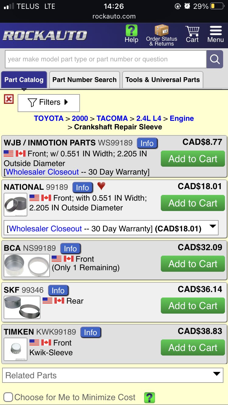

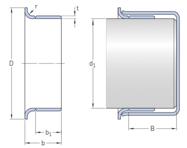

    Also I looked and Rockauto does sell one option for a repair sleeve for your engine so if you wanted to verify your measurement I would even just search the SKF 99346 part number listed here and compare your measurements to theirs 97009088-7B89-4266-A2F2-ACC1181B6A6D.png
    I will not believe you if you say you have a leak ahah. The only time I see cleaning that well is when I guy is changing head gaskets and even then a strong case can be made that you're still doing a better job. The typical and GM recommended cleaning choice for blocks, heads and basically any other machined surface is either a plastic razor blade(which sucks) or a metal razor blade held perpendicular to the surface and scratching the surface. Holding the blade perpendicular prevents it from gouging the surface which is more likely if the blade is angled to the surface. The biggest no-no from gm for internal component cleaning is a roloc disk other abrasive cleaner on a power tool as the material will heavily disintegrate and contaminate the lubricant with particles too small to even be filtered out "causing component failure in as little as 20'000kms" one guy though that was a joke and would clean blocks and heads with a roloc disk on his drill when he was doing head gaskets because it was much much faster and never blew an engine but I don't know. The rest of cleaned manually with brake clean, a razor and, scotchbrite pads. I imagine GM publishes that bulletin every year and did a tech talk about it for a reason.
    I speak sweetly to things when someone is around for the entertainment value but maybe that's something I should do more. I for sure value and am getting better at taking a break then returning to things with a clear mind as that's usually been very favourable.
    I'm also biased but I fully support not changing your u-joints until they require it aha.

    Before I stopped for the day, I snapped a few photos so I can see how far I have gotten and how much is left to go. Use a lot of diesel on blue paper shop towels, three different colors of Scotch Brite, including a thick whithish square Scotch Brite-looking thing whose instructions sounded like it was sandpaper, something I found unexpectedly stuffed in a drawer, some used wet fine grit sandpaper, and a lot of hand movement. Oh, (admission of guilt) and I also used a razor blade set at a very slight angle to the cast iron for the block surfaces. I would never do that on an aluminum surface, but the cast iron seemed to enjoy being dared, and the age of the block, plus the fact that it got sludged created surface imperfections, caked on stuff that looked like the blade at an angle might have been the only way (then I read how you set the blade perpindicular to the surface and scratch it with the blade -- and I can see that is a way to get off the same stuff I did without using the blade at an angle).
    I'm just going to pull up the photos so you can see them. I plan to attack those surfaces yet again, maybe tomorrow, to make sure they are done good enough. And while I am in a space that is wide open and I can just sit in there as long as I like, I am thinking seriously of washing the frame rails and adding some black paint, to keep them from rusting. I like to push the cleaning and painting as far as I can when there is a chance. Then, when I am finished, I can feel like everything that needed to be done has been.
    Really appreciate your finding the crankshaft repair sleeves at RockAuto. That was above the call of duty. If the little trough doesn't polish out, I think it is truly worth the money to create a surface that cannot be penetrated by oil, once I get the seal placed properly. Since they are in stock and known to fit my engine, do I even need to measure the shaft diameter? I think I will, even if I don't have to, and compare my measrement with the RockAuto specs, as you suggested.
    Just looked ahead at RockAuto, and the information I got seems a little different that what you got, for the same Tacoma:
    The only REAR repair sleeve is the one sold by SKF (99346) for $26.79 ----- oh, just realized that your numbers WOULD be different because you reach RockAuto via Canada! And I was thinking maybe they were stimulated in to action to lower their costs when you gave the repair sleeve a lookup. hahah joke on me.
    And SKF does not provide a measurement, just sells the sleeve with installation tool, and bang you are done. I really like that for when there is a mark on the shaft that will not go away!
    BTW: regarding the back of the block, except for the place where the rear main seal retainer is attached, aren't those surfaces mated up with the bell housing surfaces?
    Just got the signal that it is time for a bath, before dinner, so I must leave some things unsaid. Thank you for the fountain of carefully explained tips you gave in your last posting. Every bit of what you say helps, and mostly helps a lot, so I am forever in your debt. Maybe the day will come where I can add information to yours. Right now, I feel that things are a bit one way.

    If you have prime real estate to renew the frame surface then I don't see why not. I coated mine with black Cosmoline this fall and it was not very comfortable trying to get around under there and spray around things. In the summer when I touch it up i'll try to accost someone to let me use a hoist.
    When in doubt the repair sleeve is for sure recommend. Especially since replacing the crankshaft isn't really a cost effective and risking the seal leaking again not a risk worth taking. Especially since you'd have to basically do the job all over if it did leak.
    Work is slower today so I have a little extra down time. this is the webpage that comes up when I search the skf part number on the interwebs. 3.5" appears to be the nominal diameter of the shaft. https://www.skf.com/group/products/...ear-sleeves/skf-speedi-sleeve/productid-99346
    Aside from the retainer surface, I believe there should be a plate directly on the back of the block to provide some shielding for the assembly rotating in there followed by the bellhousing. There is a flatness spec for both bellhousing and plate contact surface but i've never in my life checked it or thought about it. Unless you have a hard shifting concern and nothing else is found to be at fault and both locating dowels are present I typically just close my eyes and carry on. Never seen or actually heard of a warped bellhousing.
    Enjoy your supper and don't worry, you don't owe me anything. Pay it forward. I like tacomaworld because aside from subtly advertising the KDMax tune, it also helps me stay somewhat mentally engaged with auto repair topics which I enjoy not that i'm not a mechanic as my day job.

    The product application engineer from Permatex called this morning and we discussed my "applcation" for the HT Anaerobic Sealant (rear main seal-to-retainer gaps). I explained to him exactly why and how I planned to use the sealant, to make sure he understood clearely what I wanted to do.
    His answer was disappointing, the anaerobic sealant is not good for any kind of plastic (?) that makes up the material of the seal. That's why they only advertize its use as a gasket between two metals. He said the trouble is that the anaerobic sealant will lead to cracking of any plastics. He added that thread sealers are also anaerobic and have the same problems, say if you screwed a bolt through a metal piece fastened to a bulk of plastic. It would crack that plastic as well.
    So, he recommended a thinner, more like a liquid, silicone (?) based "Aviation Form A Gasket Sealant Liquid" #3 sealant #80017, that comes in 4 oz and 16 oz cans that is applied to both surfaces, let to set up a couple of minutes before pressing the seal into the retainer. This product is slow drying, non-hardening, brush top, approved for aviation use, resists gasoline, oil, grease, and has a temperature range of -65F to 400F (-54C to 204C). I found this at Amazon:
    It also comes in a smaller sized can.

    Yes, I am pretty careful with the razor blade, aware of what potential danger awaits the careless. I find that the razor is a handy tool when it comes to cleaning surfaces.

    And I agree with you on the rear crank sleeve as a guarantee of sealing success. A little extra money now can prevent a leak that would be a major disappointment.
    And thanks for the link to the SKF 99346 information. I will have to go measure to make sure it will fit. There is a dimension called B that shows how far onto the shaft the tool can push the Speedi-Sleeve, and I will also be sure to check that as well.
    You said "Aside from the retainer surface, I believe there should be a plate directly on the back of the block to provide some shielding for the assembly rotating in there followed by the bellhousing. There is a flatness spec for both bellhousing and plate contact surface but i've never in my life checked it or thought about it. Unless you have a hard shifting concern and nothing else is found to be at fault and both locating dowels are present I typically just close my eyes and carry on. Never seen or actually heard of a warped bellhousing."
    I had already bought a new Toyota OEM "Plate, Rear End" because we did some damage to the plate that was between the bell housing and the block when trying to separate the transmission from the block. My brother was helping me at the time and he isn't all that gentle. Anyway, I appreciate your heads up on the flatness spec. The locating dowels are still there. Is any type of sealant needed between that plate and either surface it contacts? Or do the bell housing bolts do the job all by themselves?

    SKF 99346 Speedi-Sleeve:
    Trying to understand SKF's sleeve usage information. Maybe you can review my thinking?
    The data sheet you referenced gave me this drawing of the sleeve details, which includes the following: the ID (d1), thickness (t), and shaft coverage (b1) of the sleeve.
    Thickness t = 0.25 mm that is extra thin, as can be seen if you look at a metric ruler
    For the ID, notice that they do not provide nominal measurements, just shaft dimensions, like actual measures:
    Shaft diameter range includes the minimum and maximum diameter of the shaft it can be placed on, but not really, only possibly. They mean that an actual shaft that you are going to place the sleeve onto must have a diameter that is less than the minumum value of that range, i.e., < 88.82 mm, because what they present is a result of manufacturing tolerances, and they cannot guarantee that if your shaft actually measures somewhere in that stated range, it will definitely fit. They can only guarantee that their sleeve will definitely fit your shaft if the diameter of your shaft measures less than their minimum ID, i.e. <88.82 mm.
    I had difficulty making the measurement of the rear crankshaft diameter, nonetheless I can still confidently say that the diameter of that shaft is < 88.82 mm, so that means this sleeve will fit my rear crankshaft.
    Here is what I did. I used my Harbor Freight caliper to measure across the shaft diameter at each of the 5 holes, which gave me 5 measures around the shaft, and I did that 3 times. The measured values were rarely the same -- lots of variance, indicating that the shaft outside surface must have a ridge or some non-linearity to it. NOTE: none of the measures obtained was equal to or greater than the minimum shaft diameter specified. That observation is key. Casting out one value I considered to be the least likely measure (i.e., most likely an incorrect measure) from each of the five sets of three, then taking an average, I got 88.2 mm as my best guess of the actual largest shaft diameter, which is 0.62 mm smaller than the 88.82 mm minimum specified as ID.
    What I can say from that exercise is that the shaft diameter is DEFINITELY smaller than the smallest ID that the SKF-99346 speedi-sleeve can have.
    But, then I can note that the 0.62 mm has to be distributed to either side of the diameter, so I am dealing with only 0.31 mm on either end of the diameter. Looking closely at a metric ruler, 0.31 mm is such a small difference as to be hard to notice. When the seal goes down over the sleeve, it will probably collapse the sleeve such that it will make a tight seal with the shaft?
    If you think it necessary, I do have micrometers that can probably work with the 88 mm range (about 3-1/2"), so I could remeasure, but is it really necessary?
    I mean RockAuto says they will fit my vehicle, so they most likely do, I'm thinking, however I will wait for your answer before just buying that sleeve, out of a sense of caution. I already got a second dust cover that I bought by mistake and even with returning it will have to pay more than I want to. My part buying process is complete, except for this sleeve and the different permatex.
    Question: what is that stainless steel ball bearing thingy on the upper right of the rear of the block?
    When I moved my fingernail across the mark left by the original rear main seal, it makes a slight feeling that tells me it is there, so I know there is an indentation. I did use extra fine wet sandpaper to clean/polish that surface, and did it enough to satisfy myself that there wasn't much damaged surface left. Without being super critical, it feels pretty smooth to my fingers.
    Now I need to get the permatex and the sleeve so I can put the rear main seal in place and seal the retainer against the block. While awaiting those orders, I will move along to the accessible frame to see how well what I can get to will clean up. Which of the two RP products would be best for my Tacoma? And, will I be able to spray that stuff while under the vehicle while inside the garage without killing myself from deadly fumes? haha

    I don't really think it's critical to mic the crankshaft the purpose of the repair sleeve. It is interesting that it measures a smaller diameter than they specify because the sleeve should have a small amount of interference with it's fit so that it doesn't start to spin separately from the crankshaft or leave any sort of gap for the oil to bypass between the sleeve and crank. I would still try the sleeve and aslong is it has some resistance to installation and doesn't just slip on and off freely, I would carry on.

    I don't know what the ball bearing looking item is in the back of the block there. My guess is it was installed there from the factory to seal a machined passage but i'm honestly not sure... I feel like i've encountered and found the reasoning before but I couldn't find much from an internet search and nothing is coming back to be aside from thinking it's to seal a machined passage.

    Found the screws for the thin black flat "plate, rear end" that is mounted above the rear main seal, so I mounted it and was working on the third screw when it dawned on me that I have to mount the starter before moving along with the flywheel, etc., else it will be a bear to put it in place. At that point I went to work cleaning the starter. Once it was clean enough, I asked myself if maybe I shouldn't tear it down and look for anything that needs to be done to it before putting it back in place. So, I did it according to the FSM, and when I got the gearing out, discovered that the FSM isn't all that thorough. Back to YouTube, and I found a fellow who explained how to get the gears out. I still need to get the terminals and brushes out to see how much wear has occurred to them. So, though I didn't come across anything badly work, I still don't yet know whether I will need to buy repair parts. I did see kits at RockAuto, but they provide pretty much everything, except for the large diameter O-ring, which Toyota says must be replaced.
    As for that stainless ball in the back of the block, you were right in what you thought. I came across this on a reddit/EngineBuilding forum:
    mcpusc - 3y said "sometimes they're used to block oil or cooling passages to save a little machining required to install a plug. It's done as an economy measure by the manufacturer. On rebuild, you can pry them out, then drill & tap to replace with a pipe plug so you can get in there to clean the gallery."
    0-1-1-2-3-5 - 3y said "Likely blocking one end of a drilled oil pathway. These are often used on crankshafts where there is no other way to drill the oil passages, and the balls tend to have gunk and metal shavings and other solid shit behind them since a crankshaft is basically a centrifuge, so they should be removed for cleaning."
    I am going to pretend I didn't read that. . .

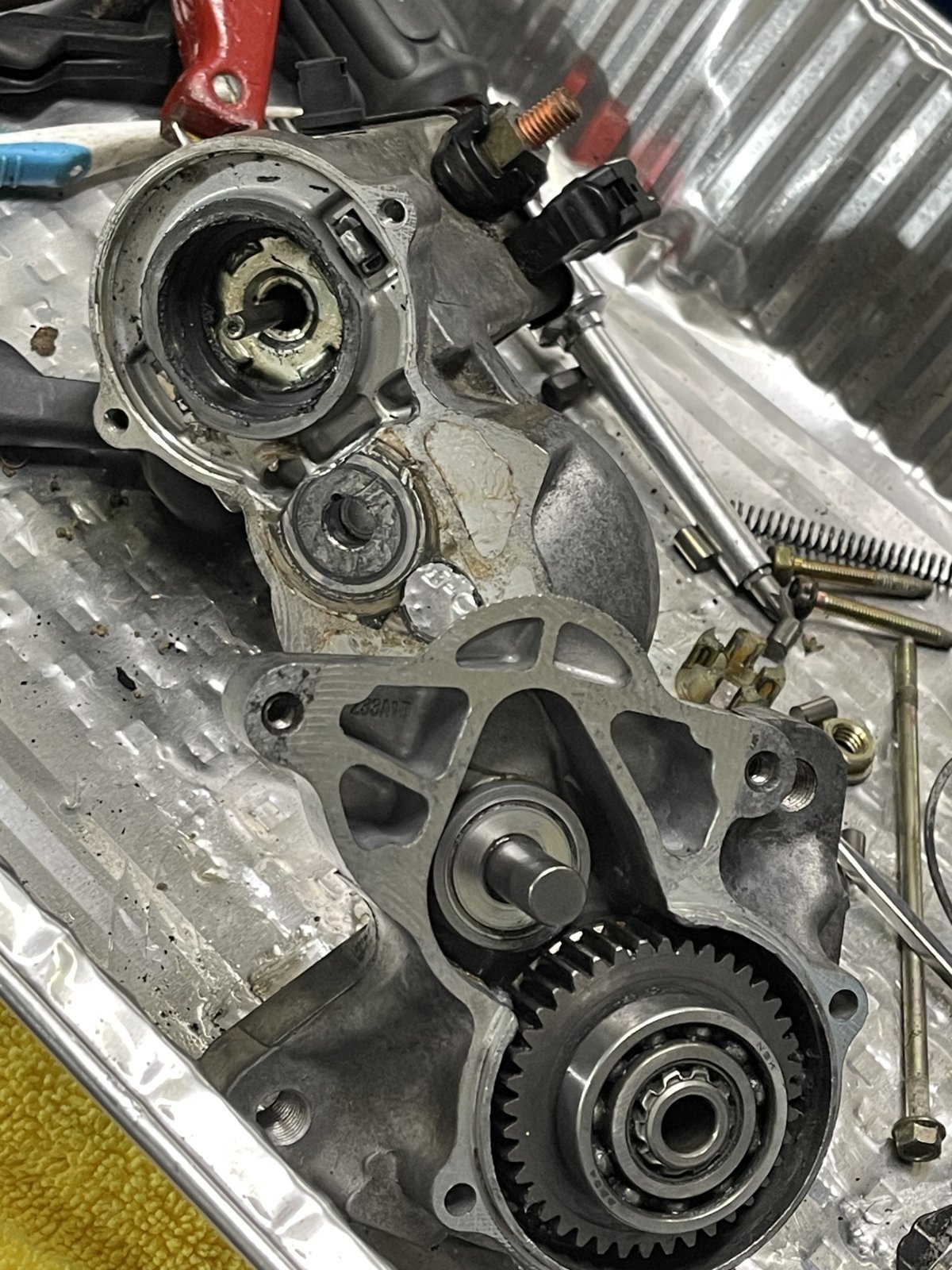

    Oy, I didn't get photos of the starter torn apart, so these will have to do for the photo session, sorry:
    IMG_9450.jpg IMG_9451.jpg IMG_9455.jpg IMG_9454.jpg IMG_9460.jpg IMG_9462.jpg IMG_9463.jpg IMG_9464.jpg
