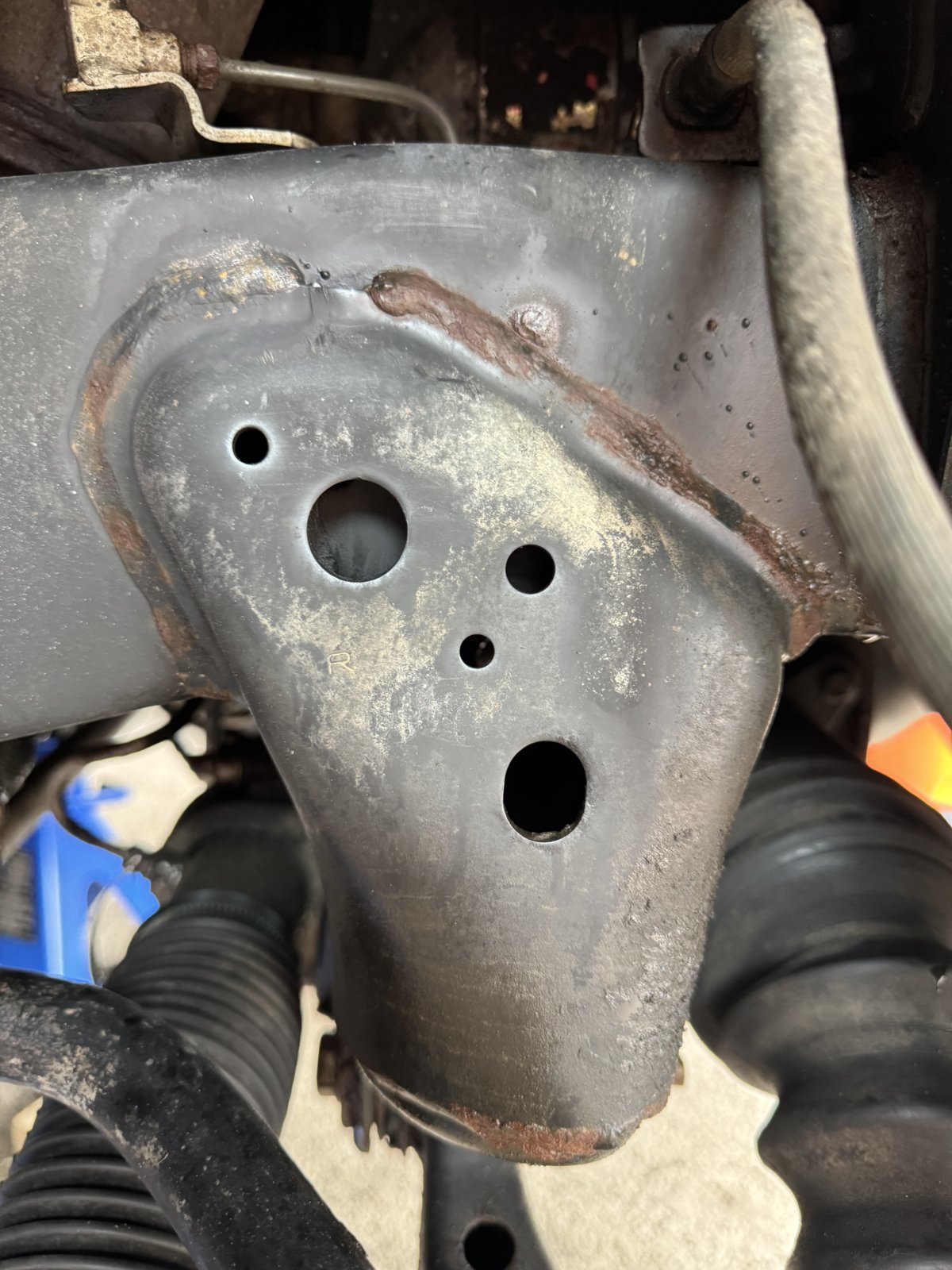

    Hi all, any issues with rust on seams of brackets welded to the frame? Should I grind it off?

    That is extremely minor.
    Just hit it with a wire brush (hand brush, not on an angle grinder due to your brake line) and toss a light coat of paint over it.

    This is a first gen!?
    No joke that looks better than any new vehicle up here thats been through just one Maine winter :eek:

    dude, that looks better than my 2nd frame...

    Thanks, I’ll try that. Just want to get ahead of any rust before it becomes a problem!

    totally agree, wire brush and some rustoleum will fix that right up
